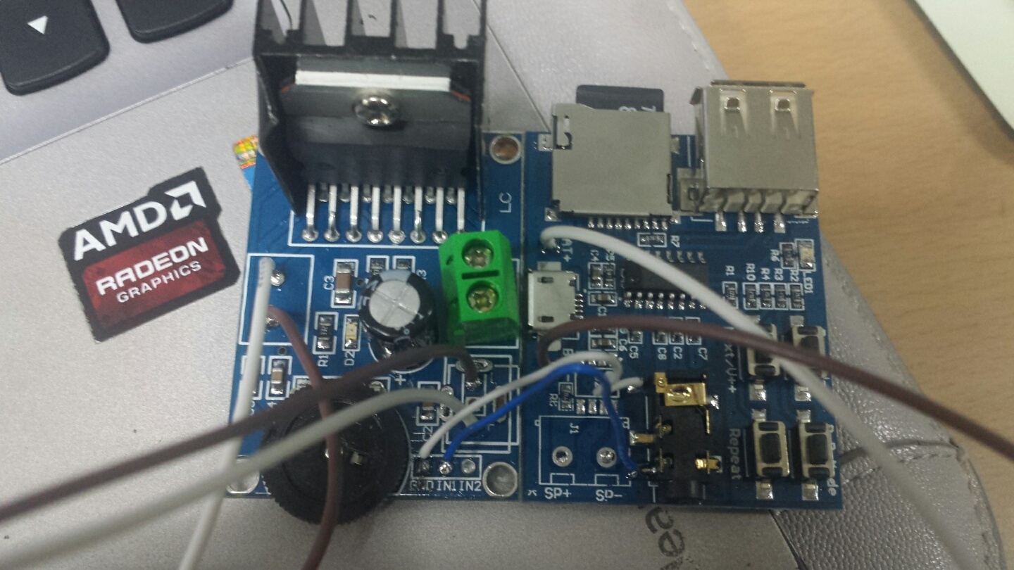

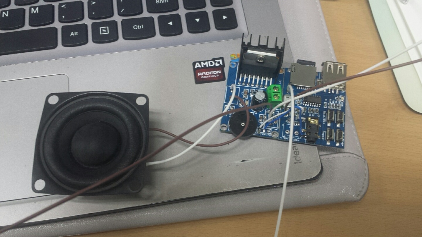

Hello guys,
I am a newbie to this, and trying to build a simple mp3 player module using GPC2856C(mp3 decoder), TDA7297(audio amp), and 10W 4Ohms speaker. As you can see in the pictures, I simply purchased two modules and put them together.
1. I took out the built-in amp from the MP3 decoder board, and connected the audio signals (+ and -) into the input and ground of the AMP board.
2. Connected the speaker to the AMP board.
Result: Everything works fine. I can hear a clear and loud sound of music that is read from the SD card thanks to TDA7297.
Problem: TDA7297 chip gets really hot. I can probably keep it going for a few minutes with the power control knob in the middle state (there is a knob I can spin to control how much power will be used which results in volume change). But it gets so hot that after a minute that I can't touch the heatsink with my fingers. I know that amp usually gets warm in performance, but I am not sure it's supposed to get this hot. Please give comments if I did anything wrong here!

Hi guys,
I need some help on using my audio amplifier module, TDA7297. It's working fine but it gets really hot while it's operating. Basically, I can't touch the heatsink after a few minutes because it's too hot. I took measurement of the current and it went from 200mA up to 1A, sometimes. I am not sure if it's supposed to go this high. I am afraid I might burn the chip. Is it supposed to get this hot? Am I doing something wrong? Do I need a bigger heatsink?

Does it get hot with no music playing ? The current consumption of this chip is fairly low, around 65ma quiescent. That means it should run cool under those conditions. Supply voltage no higher than 18 volts.
What circuit are you using for the TDA7297 amplifier?
What power supply are you using for the TDA7297 amplifier?
How are you feeding the audio signal from the MP3 module to the TDA7297 amplifier?
Can you show a picture of the complete system?

The amp does NOT get hot with no music. Only when I turn on the music and raise the volume up, the amp starts to get hot. (with high current reading).
I am putting about 17V for the amp.
I am basically reading music files off a SDcard and connecting the audio signals to the inputs of the amp module.

Above are pictures of the full system.

I use these modules all the time, NEVER power them over 12V, they are meant for car use.
The more recent ones come with larger heatsinks and still get warm.
Also, 8 ohm speaker is the minimum I would use and ensure you arent grounding the speaker to the power anywhere as these are bridge amps and that will make them overheat also.
