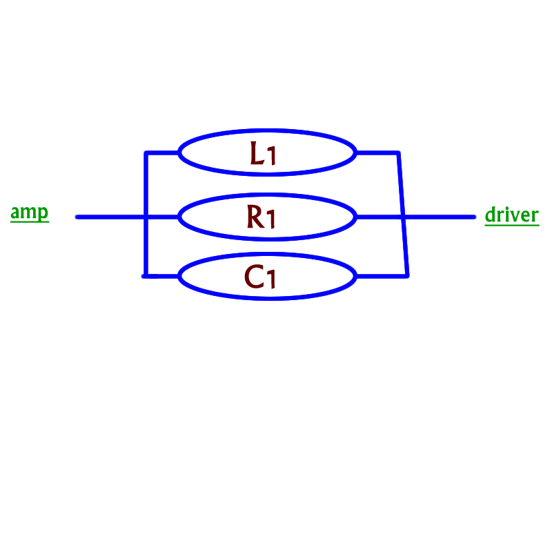

OK, very breifly, the calucated notch filter to remove the 8kHz peak is:
L1 = 0.047 mH
R1 = 21.8 Ohm
C1 = 7.5 uF
All three elements should be in parallel to each other and then this whole circuit in series with the driver. It should be the last thing before the driver, so if you are using BSC, it should be first from the amp, then the notch, then the driver.
Please, keep in mind that this is for single 16 Ohm driver only. If you use it in 4 Ohm implementation - it would have to be re-calculated.
The circuit is most sensitive to the inductance. I've been burnt by using sand-cast resistor, marked as non-inductive. It's inductance was high enough to move the inverted peak of the notch filter away from the peak of the driver. Therefore, either use REALLY non-inductive resistors, or leave enough wire on the coil to adjust L and veryfy by measuered response. The later is only possible if you have the means, so if you don't - pay more for a good resistor.

Ok I got the parts, but I have a little problem understanding the connection...
Attached is the schematic , is that correct?
So I have to connect it to the driver, but I have a + and a - .... do I have to make 2 sets per driver? or?
Tnx, and sorry if this is something too obvious!

Eric,
It looks correct. The side marked "amp" on your drawing should go to the + of the amp. The side marked "driver" on your picture should go to the + of the first voice coil. The - of that voice coil should go the + of the second voice coil. And, finally, the - of the scond voice coil should go to the - of the amp.
If you would like to use the baffle step correction circuit, it should go between the + of the amp and "amp" label of your drawing.
Vadim

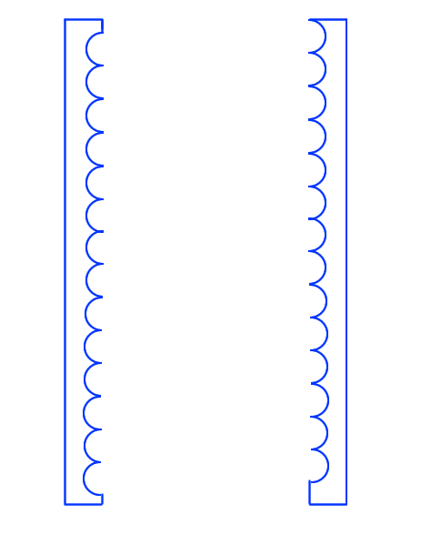

Hi all

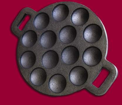

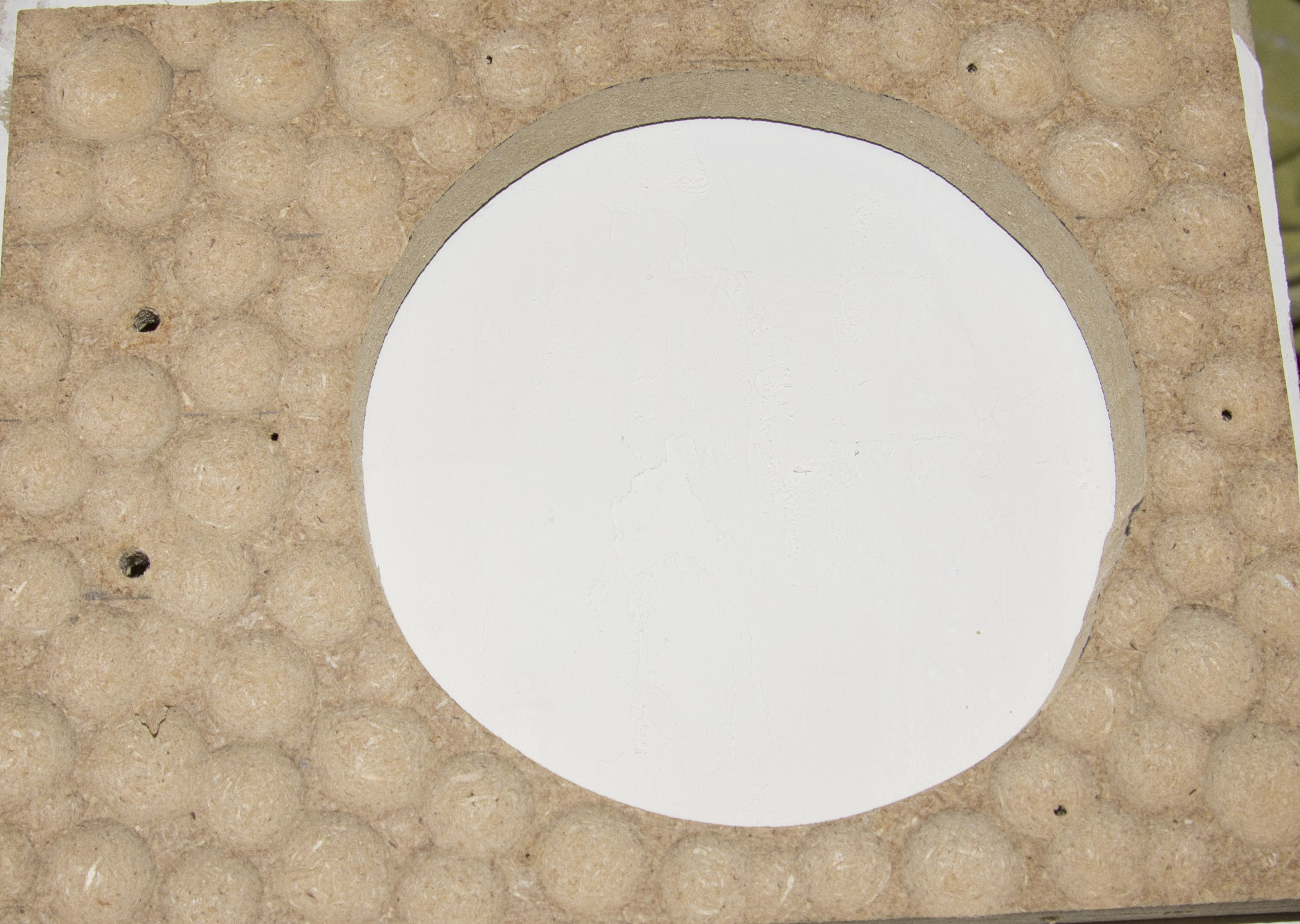

I have been thinking the whole day about non parallel walls in speaker enclosures. I admit, a bit sad, but at the end of the day I came up with the idea as attached.
Basically, I want to make round holes (not just the diameter, bit also the inside radius) all over the wall. Basically like what we call in Holland a poffertjespan (see second attachment), but the holes closer together. Especially if the wholes of opposing walls are not aligned, this should result in non parallel wall behaviour of the sound waves inside the enclosure right? Also, it will make the enclosure larger, instead of smaller! What do you guys think?
Makes me hungry. Seems like a lot of work and sawdust. Speaking of food, I wonder how lining the walls with cardboard egg cartons would work? Kind of a Red Green approach but might do for proof of concept.
well... if you are talking big speakers it will be a lot of work, considering the small size of the box is should not be that hard... I was actually inspired by the egg cardboard, but I wanted to make the internal volume bigger, not smaller...
