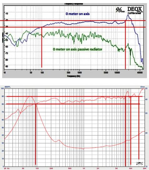

maybe interesting: freq response compared between what audience says and what I achieved in my 2,3 liters enclosure:
