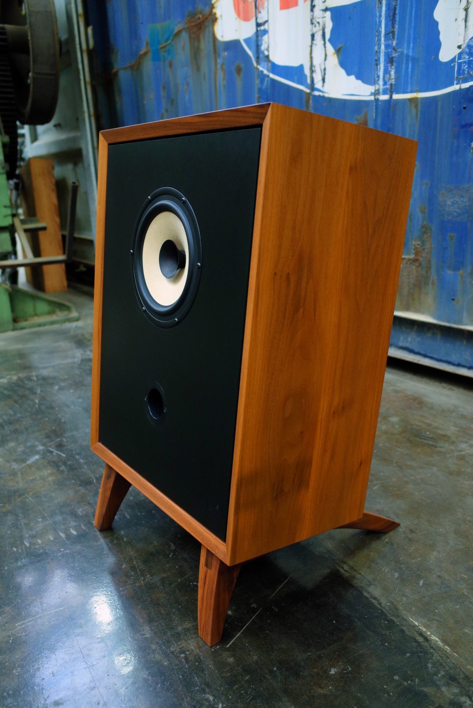

I like flush mounting as it really improves aesthetics. In my case it's an existing pair of 6" Karlsons that I modified recently.Personally, I would not build speakers without flush mounting drivers and radiusing baffle edges. Its relatively easy once you are set up to build.
I also have considered turning some rings on the lathe similar to those used on the Eliptoflex of Lafayette days of old but have no way of evaluating the result. However I may add overlays.

it's slightly more ragged in the highs. I did test it years ago (with the first pair of Alpair 10.3 that i used) to see it myself, and it's minimal (+/- 2dB in my test), but it's there. But it's not dramatic i said before, so not worth to think about it much for me. If you can't easely flush mount, don't bother that much. With most drivers, with a small bezel, it will be even less than with the Alpair 10.3 that has a big bezel that is 1cm thick. There are many factors that are way more important than that. But it's not that there is no difference.

Surround a dome tweeter in felt (dunlavy), sure, i would not not do it.
Probably want to not frame the box either then like actual fern & roby "raven".
