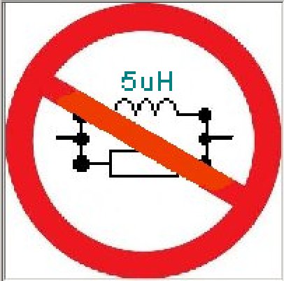

Graham Maynard said:Hi Glen,
There are many aspects to consider in designing/making an amplifier.
Going back to post#176 I still do not know which 'compromises' you have in mind and which you would maybe like me to mention out of the blue.
OK. Practically any amplifier with basic global negative feedback will require a load-isolating output inductor if a reduction in phase margin is to be avoided when driving a capacitive load.
If we wish to do away with the inductor, then we need to ensure that the phase margin when driving a resistive load is in excess of optimal - and that almost necessarily means a lowering of negative feedback factor at HF. This will increase THD and depending on toploogy, slew rate as well (for instance, we could just make Cdom bigger).
The Leech feedback scheme mentioned earlier, which is used in his famous DIY amplifier, is one scheme that removes the need for an output inductor, but in doing so actually worsens the output impedance and increases the THD.
There are some designs out there with very little or no negative feedback that have absoutely no problem driving even the most capacitive of loads. however, by virtue of their lack of feedback, these amplifiers are plagued by high output impedance and low damping factors - much more badly than a well designed amplifier with high global negative feedback an a small output inductor.

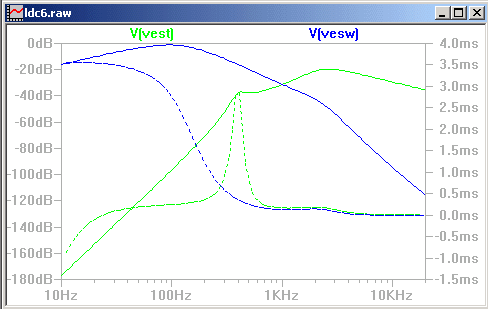

Hi Rodolpho,
The delay variation in time you quote certainly looks like that sort of range, I did measure and list them at the time. Yet look at these values compared with the individual choke group delay variation for the same frequency with the perfect (virtual) amplifier in post#211.
And these are all steady sines, not even music with all of its variations and asymmetricalities. The loudspeaker system induced variation of output voltage in time due to amplifier characteristics will also change as input waveform varies wrt to prior loudspeaker system energisation, as well as with output (power) current demands.
Re your 'PS', what would you like me to add ?

Graham Maynard said:Hi Rodolpho,
It is not clear to me to which transfer corresponds the group delay you plotted.
By the way, any multiple driver speaker system unless driven by separate amplifiers for each and also crossed over electronically by some digital linear phase gizmo, will have significant group delay excursions well within the audio band, probably the worst case being 2-way boxes where the crossover frequency falls smack in the most sensitive region for perception.
This is irrespective of the amplifier flatness, output coil or whatever, meaning as I pointed out earlier that to judge relevance of this or that technique, one must not lose sight of the whole picture.
Rodolfo

Graham Maynard said:If a design by Halcro uses an output inductor then I will not give it a second look. I thought I had clarified that I am simply not interested in any design that uses a series output inductor, other than that of a few feet of LS cable.
[/B]
I wonder what addicts of valve amplifiers (with output transformers) could think of the audibility of a 6µH inductor or of the "first cycle distorsion".
Hi Forr
But in the case of valve amplifiers , the output transformer is inside the overall feedback loop .
Not so, in case of solid state amps equipped with output coils..
Regards
Hi Forr,
It took me three decades to construct an amplifier better than my own 4xKT88 UL-AB1.
Tube Dude is quite correct.
Think of an amplifier driving a first audio cycle into a LS.
The amplifier voltage always starts out leading current, but by the end of that cycle the current can be leading, thus the amplifier's NFB response can become modified and there can be waveform distortion within that first cycle.
LS do not generate leading current until after they have been energised, and initially they conduct normally at the resonant frequency until resonance has been energised.
Having internal inductance means that amplifier's themselves can react to this changing load reactance within a first cycle.
Don't worry about what other people think; what about you ?
Cheers ....... Graham.

Graham,
Let me fierst remind you did not clarify the point with regards to the schematics and group delay plot post. To ease things, as I see you put an ideal unity gain amplfier and split the output on one hand to a resistive load and on the other to a passive crossed over 2-way speaker load, in both cases placing 6 uHy//8.2 ohm in series . I tend to believe what you plotted is the differential group delay after the output coils (V), is this right?
To gain perspective, please check a study I posted here to have an idea what loading a typical box presents. With reference to the group delay issue, I attached below from the same model, plots of group delay vs. frequency both for the low pass and high pass ways, only what is plotted is actually voice coil velocity, since what is modeled is not only the crossover network but driver electromechanical equivalent including box loading, so this is a more accurate representation of what happens with sound pressure which is what we hear.
See the values and draw your own conclusions.
Rodolfo
