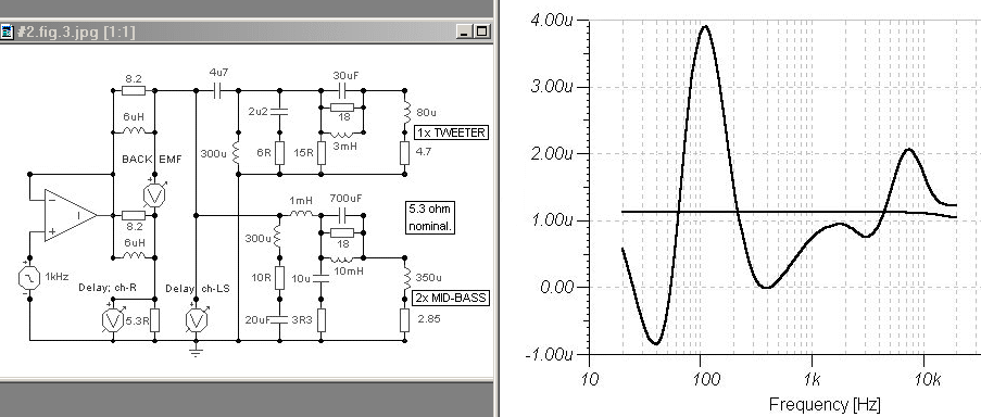

Hi Conrad,
You wrote >>Last time I checked, time domain and frequency domain were equivalent. <<
YES - BUT - when current flow is phase shifted wrt source voltage, then voltage propagation through a reactive circuit cannot remain coherent in time.
The straight line response below is the voltage group delay at R due to a series output choke and steady sine excitation, which is of course what everyone measures and bases their understanding upon !!!
The widely variable voltage group delay is that at the (typical)loudspeaker terminal due to another series output choke (both driven by a perfect source), yet this includes a negative delay component caused by leading back-EMF generated by the loudspeaker.
This may be viewed as an expectable reactive response - BUT -
The first cycle of an amplifier's output starts out driving a loudspeaker system that has yet to deveop its back-EMF. Where anyone says it is unacceptable to have a suddenly starting sinewave then they simultaneously deny that an output choke can introduce loudspeaker voltage variation with frequency, and in music performance time, during the first 2 or 3 cycles of any hf waveform change such as transients, high frequencies, harmonic relationships !!!
This is significant because the varying voltage error momentarily is superimposed upon the entire waveform, and not just the component which generates it.
No series output choke means no frequency selective propagation delay variation in time between changing high frequencies, or energetic mids.
Why does everyone get at me, rather than respond about this affectation ?
Once this is understood it is but a small step to see how this distortion of the relationship of voltage in time applies equally to NFB amplifiers which, due to internal stabilisation networks within a global loop, render an entire amplifier inductive with inconstant response to loudspeaker generated back-EMF !!!
Yes the amplifier inductance value is small, but stage current inadequacies and class-AB crossovers exacerbate any effect.

Is this computer generated (irrefutable) measurement not the sort of thing you seek in relation to output choke usage ?
Cheers ............ Graham.

Graham Maynard said:....
Is this computer generated (irrefutable) measurement not the sort of thing you seek in relation to output choke usage ?....
Graham,
Please note I am not taking position about the output choke, but my hunch is the low values mentioned make it irrelevant at audio frequencies.
That said, I promise to have a look at your simulation and result. Are we talking of a group delay ripple ranging from -1 to +4 uS?
Rodolfo
PS it should help if you clarify what signal are you plotting and with which reference.

Hi Graham
Varying the internal capacitance of a "Blameless" shifts the unity gain frequency up or down. But clearly a smaller Cdom would give a higher frequency response, and I agree with checking the performance of an amplifier to back emf's etc.
In fact, "blameless" circuits I have built have showed very small oscillations (~few mV) when the ft is set to ~10 MHz which gives a 300 kHz bandwidth for closed loop gains ~30, which has not helped, since adding more C elsewhere to stop this just makes things worse. I'm not saying this is a problem of the design, only my observations of the units I have built. Perhaps others have not seen this.
The point is that I agree with your observations that you could change the frequency response of a blameless quite considerably without changing the "audio" response of 20 Hz- 20 kHz, which Self did not mention as a consequence of changing the Cdom and/or Re on the input stage pair. My initial "error" in objecting to the use of Miller caps was to assume that slow output transistors needed the time constant/frequency response to be set rather lower than 10 MHz. - say, 2 or 3 MHz corresponding to the fT's of the output transistors, assuming that these dominate. In fact, if you do lower the response, you can eliminate the niggling oscillation in the units I built, which I mentioned, but this seriously causes possible input stage overloading with fast signals.
As we all recognise in this forum music is not sinewaves and I agree that this could well change the audible performance of an amp. Music is virtually a sequence of "first cycles", and people have pointed out that particular instruments/voices have asymmetrical characteristics. This suggests to me that any ac coupling will cause a low frequency offset every time... so we need to minimise LF ac components too. I prefer to use fully dc coupling (no decoupling capacitor in the feedback arm for example - this also eliminates capacitor noise/distortion), and in my current amp I have traded a little dc drift for dc coupling.
So the point is this ... the performance of an amplifier is likely to depend on the ability to respond to back emf's as you have said, and it is clear that the faster the amp., the more likely it is to deal with whatever transients are input whether from the speaker or input stage. Provided nothing untoward like cut-off affects it. And, in reply to those who state "frequency and time domains are equivalent" while this is basically true, it belies the subtle frequency response differences that, say, a Miller compensated amp. and a phase-lead compensated amp. (like Bailey's or Linsley-Hood's) have, and these are not the same, so their performance won't be either. The question ought to be at what point we are not able to hear the differences...
