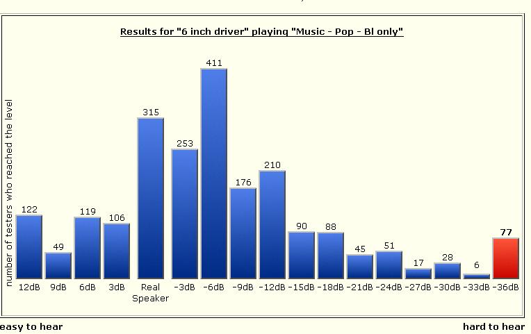

In the same "6 inch driver playing music pop" I got to -24dB just by turning headphone volume down. The problem seems clear, distortion products of the test become "buried" under the distortion products of my headphones.
I also experienced the same "discontinuity" in the 12dB or 15dB region, it seems that the distortion products of my headphones become similar in magnitude and opposed in phase to the ones from the test resulting in distortion cancellation that fools you. Reversing the polarity of the headphones may change things for even harmonics...

It has to be easily repeatable in order to discard the purely random probability of reaching a lower level, that is not so low because during the first approach you move in 6dB steps.
You will appear 6dB better than what you are in one out of every two tests.
You will appear 12dB better than what you are in one out of every four tests.
You will appear 18dB better than what you are in one out of every eight tests.
Everybody can get to the minimum level by repeating the test enough times, but it's the worse result the one that tells how good actually you are.

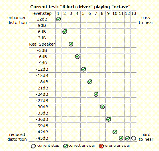

Here are my results:
-45 dB on "octave - 6 inch driver"
Onboard sound on Dell Optiplex GX280
Koss UR-19 Headphones ($5 at TJMAXX) with intermittent left speaker.
Fan running in adjacent cubicle.
How did I do it?

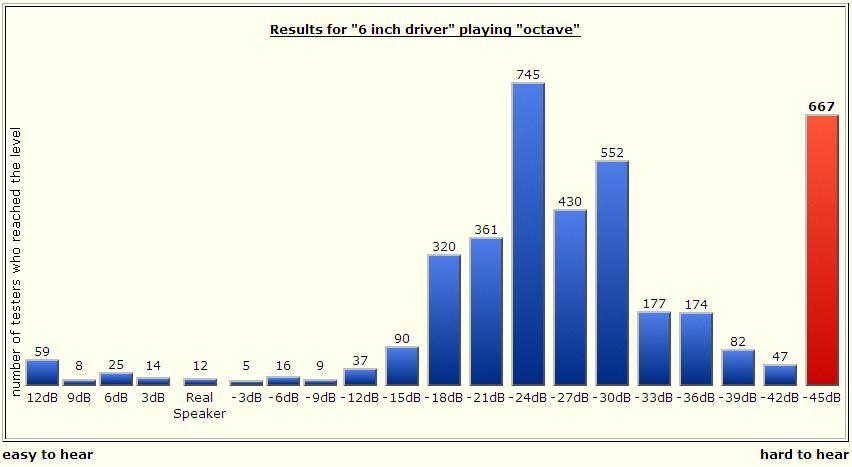

There's a glitch in this particular setup. Judging by the disproportionate number of users who attained the -45 level in this test, I don't think I'm the only one who noticed.
The undistorted sound track has a series of two clicks just a few seconds after the start. The distorted one does not have these clicks.
I sent an email to their webmaster.

Yes, I don't think I did this test before, but you're absolutely right. I listened for the click and went straight to -45.
Hi David,
the "bimodal" distribution with the 2nd peak at the test floor suggests that several tests here likely have this sort of "clue" that allows determination independent of the varying distortion level

From what I can tell, the "pop music on 6 inch driver" test contains no such clues.
The "octave" test as well as a couple other ones do however have unwanted clues. You can tell from the stats too.
