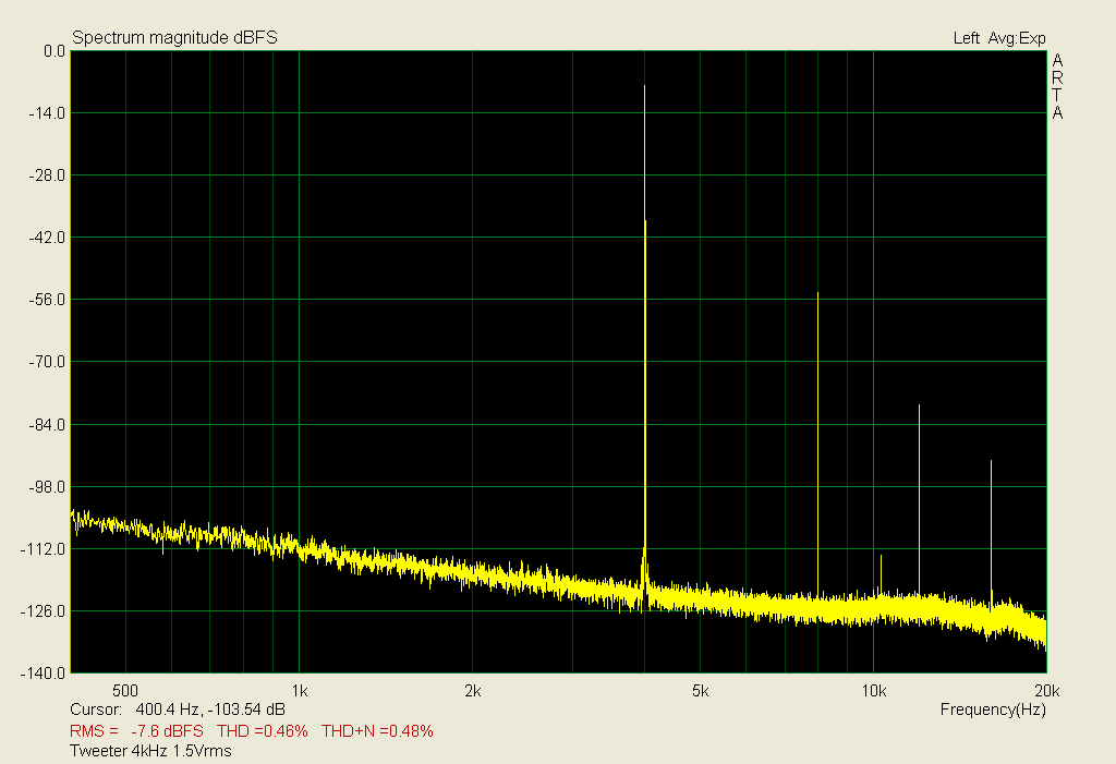

This is a tweeter with "standard" behavior (not T2030). We can see that spectral components are nicely decaying.

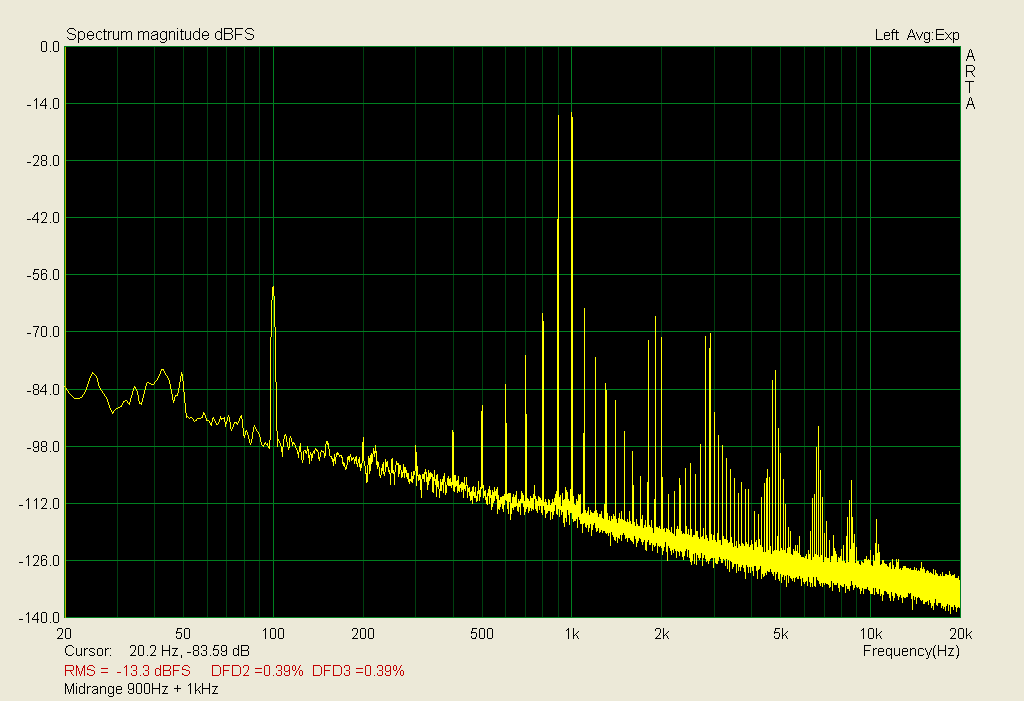

I have quite enough measurements that show high order harmonics in driver spectra, one of them is attached, but I do not want to identify the drivers.
IME it is possible to measure higher order harmonics if we have enough dynamic range of our measurements, which is the case in the close proximity of the speaker.
It is also interesting to make a spectral analysis of speaker current (I have some measurements on my web page), speaker current spectrum reflects impedance non-linearities and thus driver non-linearities.
These driver non-linearities also reflect into amplifier output voltage, the ratio would be Zout/Zdriver. The higher Zout of the amplifier, the more we can see it at amplifier output voltage, even if it is a true class A with negligible distortion. However, speaker (driver) current distortion will be of orders higher than amplifier output voltage distortion.
