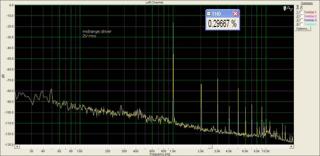

But if you have other examples of drivers which have higher orders comparable to the 2nd or 3rd and cannot be called broken, then I would like to see that data.
I have quite enough measurements that show high order harmonics in driver spectra, one of them is attached, but I do not want to identify the drivers.
The reverse is true of high-order nonlinear distortion (5th and higher); it might be difficult to measure (because the absolute levels are low and potentially swamped by noise), but easy to hear as "roughness", "harsh", or "mechanical" sound.
IME it is possible to measure higher order harmonics if we have enough dynamic range of our measurements, which is the case in the close proximity of the speaker.
It is also interesting to make a spectral analysis of speaker current (I have some measurements on my web page), speaker current spectrum reflects impedance non-linearities and thus driver non-linearities.
These driver non-linearities also reflect into amplifier output voltage, the ratio would be Zout/Zdriver. The higher Zout of the amplifier, the more we can see it at amplifier output voltage, even if it is a true class A with negligible distortion. However, speaker (driver) current distortion will be of orders higher than amplifier output voltage distortion.

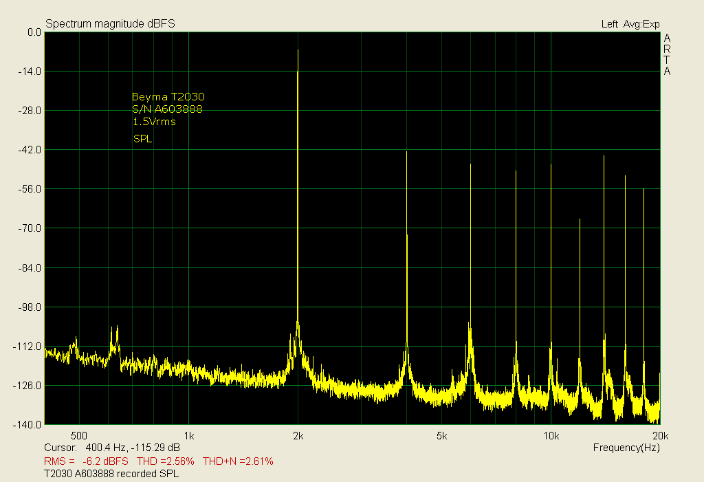

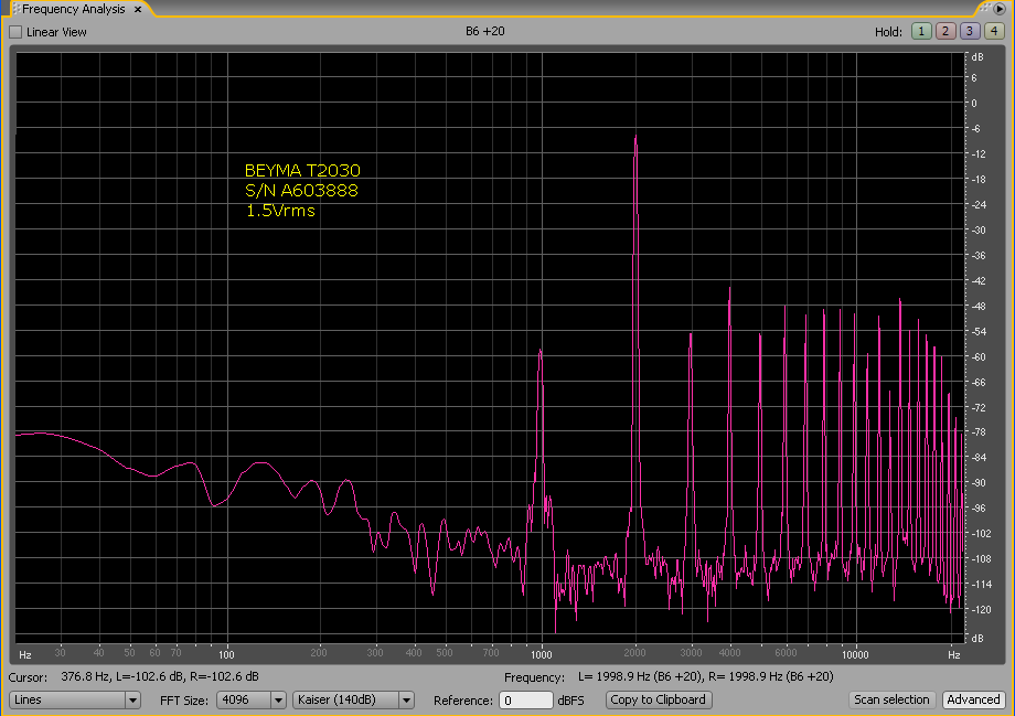

This is another S/N of T2030 with sub-harmonic distortion. 2kHz recorded file
http://pmacura.cz/T2030_A603888_2kHz.wav
and spectrum, sub-harmonics in 2nd half of the file.

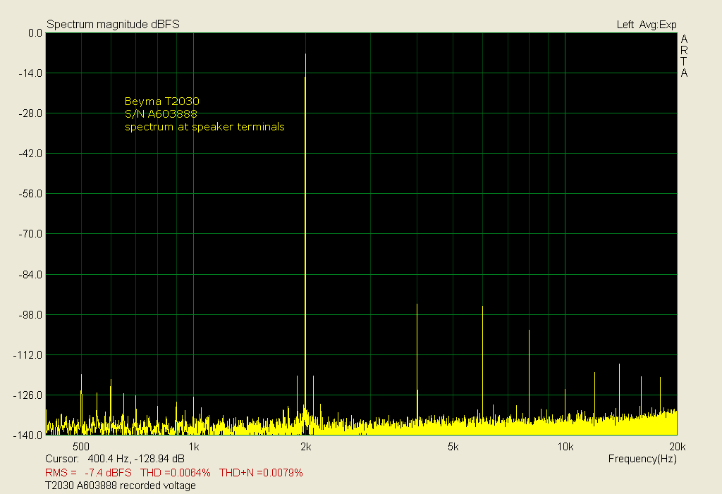

Edit: attached is also a spectrum of voltage at speaker terminals and SPL spectrum at high resolution (no sub-harmonic at the moment)

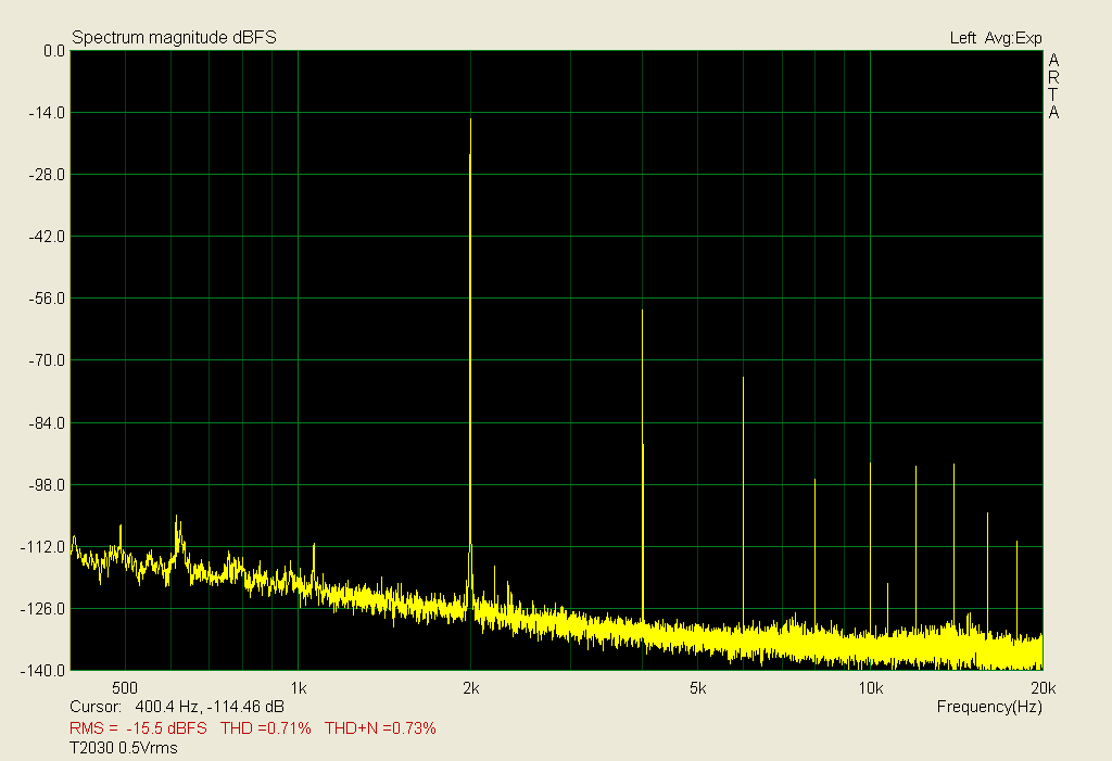

Why would you do that? Is this another "test" of yours, with uncertain conditions, measuring methodology and/or misleading conclusions?
The conditions are well defined and have been described. Speaker terminals voltage is 1.5Vrms, near-field measurement with microphone 4cm from membrane, the voltage records were posted here and anyone interested may make his own analysis of the data measured. Voltage distortion at speaker terminals has been shown as well.
In case you have any relevant comment, I will gladly read it and answer it.
The problem with this driver is indicated by rise of higher order harmonics. As long as the envelope of the spectrum has decaying shape, the result is OK. For this driver, it was, unfortunately, only up to 0.5Vrms. The rise of higher harmonics is not only measurable, but it is clearly audible. The ear detects it with same reliability as the measuring microphone.
