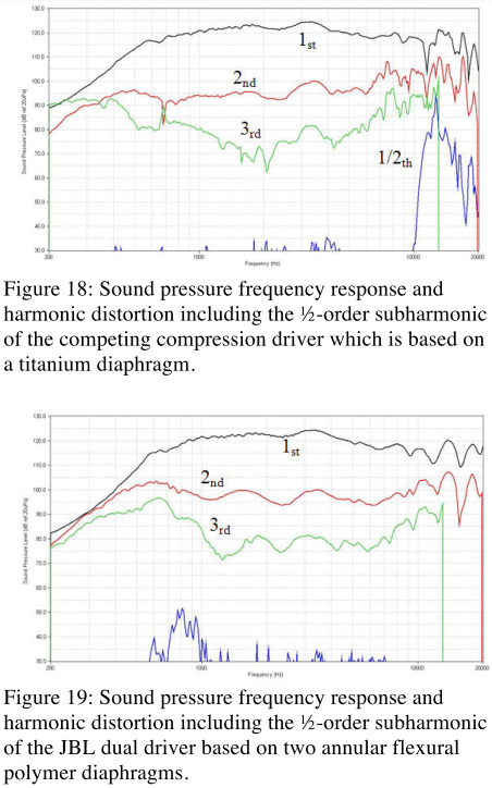

Here is a harmonic distortion comparison between two compression drivers, taken from Voishvillo's AES paper about the JBL D2 driver (convention paper 8502).
The comparison is between a 3" VC driver with a titanium dome diaphragm (and possibly ferrofluid in the gap) and the D2 which is a dual 3" VC driver with polymer rings.
It is interesting to note that the 1/2 harmonic mainly occur in the region where the diaphragm is most probably undergoing heavy breakup modes.
JBL's own tube measurements of drivers equipped with 4" aquaplassed magnesium and beryllium diaphragms do not show such 1/2 harmonics rises :

That, and the too often ignored reality that we're talking about mechanical systems that do not, in fact, behave like our oversimplified theoretical or electronic models. Cone breakup is commonly modeled as a simple resonance and we look at it with a single tone sweep, ignoring what "breakup" actually means . . . that different parts of the cone are moving in different directions or with different velocity at the same time, and not tracking the voice coil at all. The question becomes not just what that "sounds like" at the frequency at which it is occurring, but what the "rest of the music" sounds like when that is happening.What I was saying was basically that it's flawed thinking, this thing with pleasing 2nd order HD. As you know any nonlinearity will result in modulation distortion.

Thinking about the sub-harmonic issue, this is well worth studying. I can see how it could change a lot of things. It is a wide open field as far as I can tell. The Beyma paper didn't get much traction, but I am not sure that means anything.
My take away was the subharmonics were due to mechanical interactions and could be minimized by the device designers making different choices in materials, shapes and construction. IT would be interesting to see how BMS and the JBL push pull drivers stacked up.
