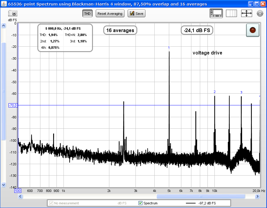

How about subharmonic NLD, usually in tweeters, do you also find it inaudible?

Sub harmonics is an interesting issue. That's because they cannot be generated by any process that is time-invariant (See Schetzen for a proof of this. Surprised me as well!) There is no mathematical mechanism for this. What can cause it is a nonlinear system that is time variant such as would occur from thermal modulation effects, especially in tweeters with small voice coils. Since no time-invariant system can generate sub harmonics there were no sub-harmonics present in any of the systems that we looked at in our study of THD perception. There could have been in the compression driver study, but to what level I do not know.
The Beyma paper clearly shows (Eq. 1) that the system needs to be time-variant for sub-harmonics to occur.
It is, to me, a fascinating aspect that needs more study as this is a fundamental indication for thermal nonlinear effects. Audibility has never been investigated to my knowledge.
That is a fascinating plot with multiple 1/2 orders. I suspect strong thermal modulation going on there. What kind of tweeter is that? I'd like to do those tests myself.
