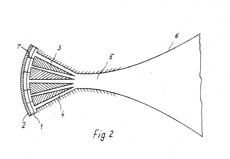

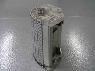

What do you think about this concept. The author was my lecturing professor of electro acoustics at the Technical University, Prague.
Patent US3590169 - Electrostatic horn loudspeaker - Google Patents
Pavel,What do you think about this concept. The author was my lecturing professor of electro acoustics at the Technical University, Prague.
Interesting device.
Looks like it would be well suited for line arrays, but I don't see it reducing distortion, and likely would be frightfully expensive to produce.
Electrostatics have very limited excursion, so the crossover frequency would have to be high for high output.
Any measured distortion vs. output level of an actual device?
