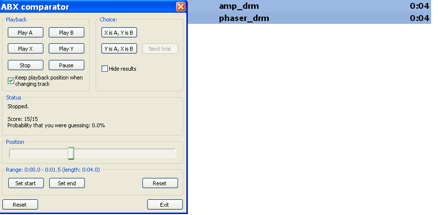

I have finally found the type of music sample where I can hear the sound difference between allpass under test and gain stage without any doubt. It is a drum kick followed by hi-hat. Try to concentrate on the first drum kick transient. One of my ABX attempts (15/15) attached.
I listened to the drum clip but again, statistically I could not reliably differentiate. I scored 7/10 but followed that with a 2/10 and a 6/10.
The decay on these later clips sounds very 'grainy', almost like crossover distortion.
There is some background noise in the drum recording, but I wound not call it a "crossover distortion sound", unless the system used does not add its own crossover distortion. These transient signals are interesting.
On drums the amp one sounds metallic and sustains longer. It also pops a bit louder - more forward.
