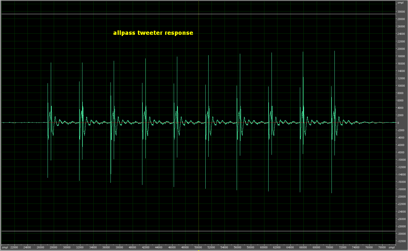

Karl, thanks for giving it a try. I have just tried the test also with speakers instead of headphones, 3 runs of Foobar ABX, and the result is quite positive, 7/10, 8/10 and 8/10. I have ABX protocols of these attempts.

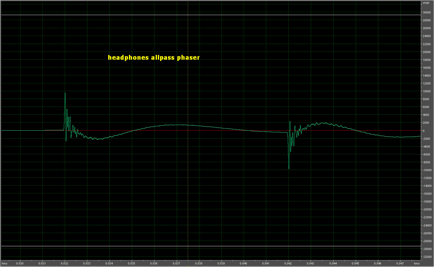

It seems to me that, depending mostly on speakers and room acoustics, the allpass phase distortion may become audible with special test signals that are grossly affected in their time shape by allpass phase distortion, provided this lies in a frequency band where the ear may be phase sensitive.
I have not found, yet, a music sample where I would be able to get a positive ABX result with this allpass test.

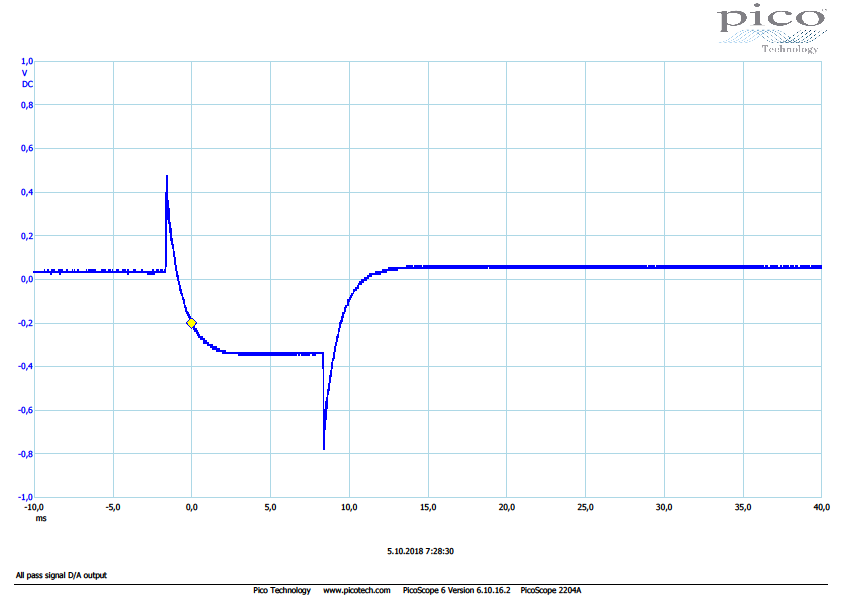

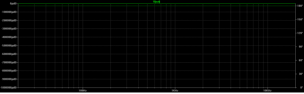

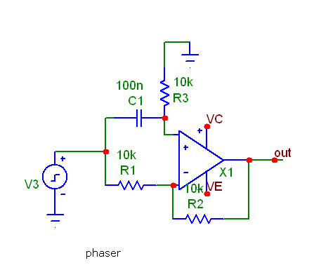

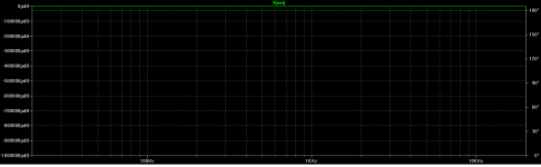

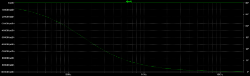

My goal is to investigate possible audibility of a general allpass system, i.e. the one with flat amplitude response but frequency dependent phase response (not meaning a simple time delay). Speaker crossover is one of the possible circuits.

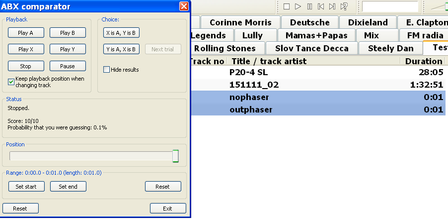

I have finally found the type of music sample where I can hear the sound difference between allpass under test and gain stage without any doubt. It is a drum kick followed by hi-hat. Try to concentrate on the first drum kick transient. One of my ABX attempts (15/15) attached.

I listened to the drum clip but again, statistically I could not reliably differentiate. I scored 7/10 but followed that with a 2/10 and a 6/10.
