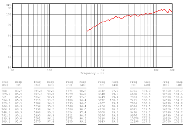

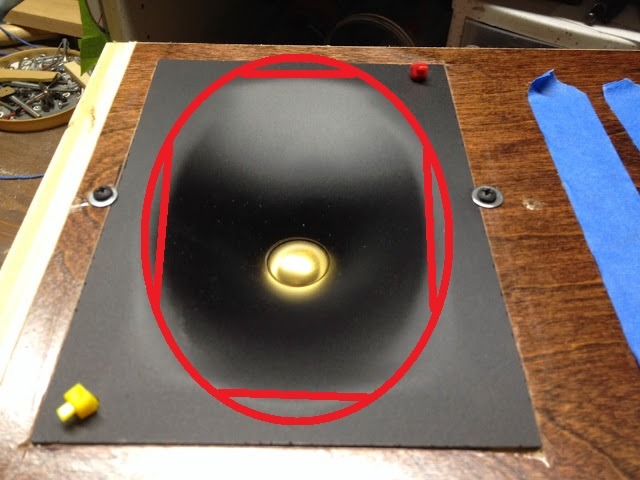

Manufacturers graph shows a rising response on the gold one, the specs from the manfacturer are quite different on the A20 and A28, also remember these have high Fs by modern standards.Wow those results look really good! And Dave made elliptical waveguides not to different than mine, so it should be easy to replicate. Very encouraging that the top octave doesn't lose any sensitivity.

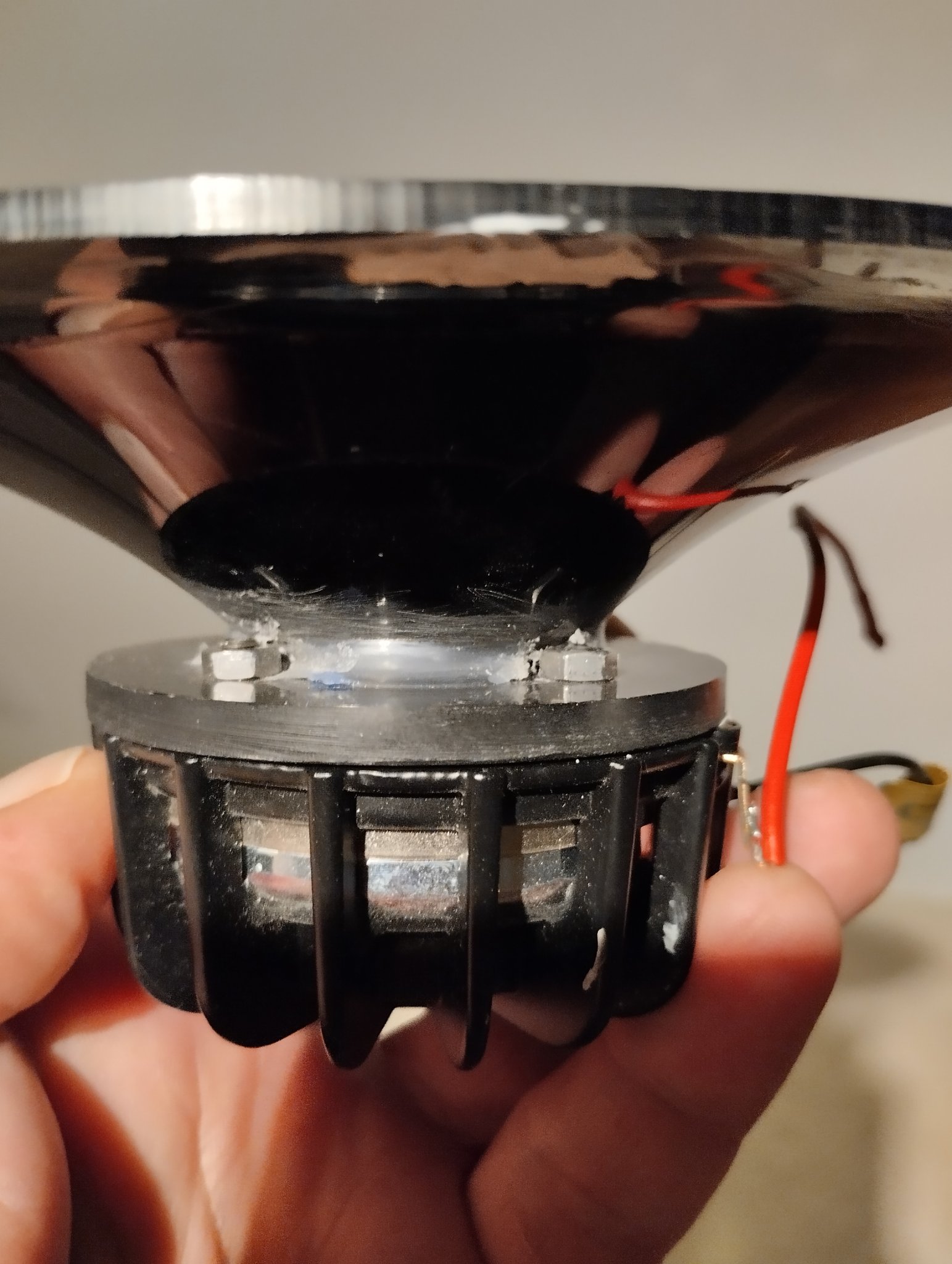

Dave Pellegrino's Audax TW025A28 with elliptical waveguides ended up at my house here in Sweden, my first serious DIY project.
And it sounds very good, and is hard to beat.
What's funny is I was posting in those threads! Forgot all about it, but it has been a decade. Would it possible for you to get some better pics? So i can see the throat and get idea of the wall profile? That would be really helpful.

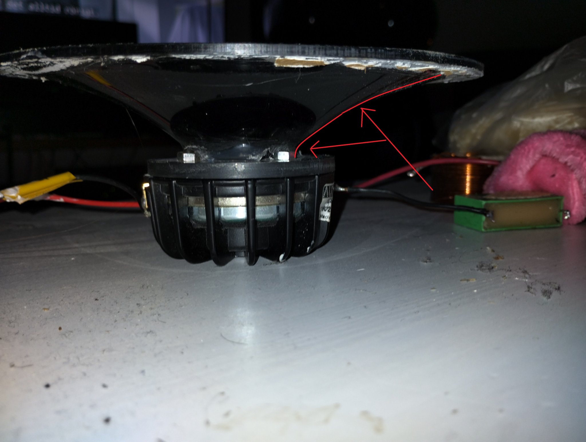

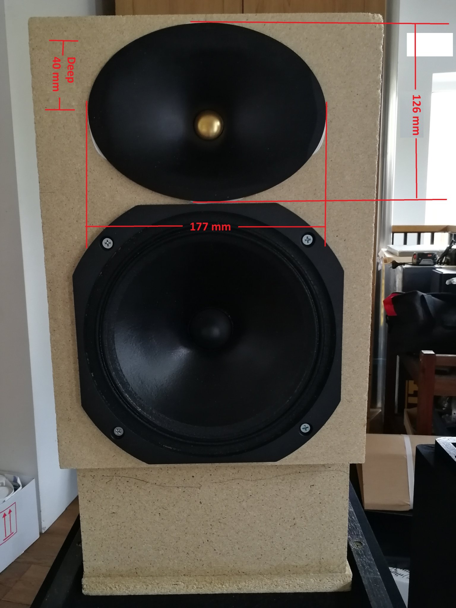

Sorry for late answer augerpro, but here is info.
Its 177 mm wide and 126 mm i high, 40 mm deep including mountingplate (5 mm), so shape is made on 35 mm deep.
It was cut out from a rectangular shape, so 5-7 mm in top/bottom/left side/right side are flat at the endings.
So angle is 165 mm and 115 mm on the 35 mm in high of the waveguide.
Regards John
Your welcomeGreat, thanks for the reply! Does the profile curve more tightly at the throat, or is it just a continuation of the wall profile all the way?
The angle is very like a Trumpet.
And yes the profile curve more tightly at the throat.
I try to skiss the curve-line on the photo, because its hard to take a good pic.
Tell me if you want more/better photos or some other info, its night here in Sweden so no daylight for photo.
Regards John

Now that's interesting news. The Be picks up 2 dB at 10khz, and the fabric SB29 picks up almost 5 dB at 10khz with the neo motor. I'm not sure the SB26CDC will be able mate to a high sensitivity 8" with the neo motor, but it will sure opening possibilities in the 87-89 dB sensitivity area. Have you heard of any plan to bring these to market?
