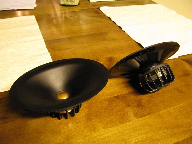

That's what I planned when having more time with the 22 TAF/G and two NE149W in a MMT if a MT alone is too much anemic or if I can't cross one only at 200 K hz 12 dB because too much of noise there (I suspect one will be enough as I don't listen too much loud. SB32RNX sealed to theorically avoid a Linkwitz if taking the RNX-L version (which I would prefer to have a littlier bass cabinet and I'd prefer to stay passive also for monney or a too much complex passive)

I've discovered that many ring radiator and large surround dome tweeters don't like to go that low compared to standard size/ratio surrounded domes. I believe it has to do with the increased rocking motion on the dome from the larger suspension. The increase in H2 isn't so bad, but often H3 follows the trend, although not to the same pace of increase as the H2. The XT25 ring radiator is a good example of this. Its a nice sounding tweeter in a WG, but not very forgiving as in the original non WG form.
If we study some of the larger domes, the trend is to use smaller roll surrounds on these single suspension drivers. You tend to loose uniform piston motion control on larger width surrounds (just like with the tweeters I described). Its not severe at lower SPLs or higher HP filter points, but it will define the HD spectrum based character of the driver. Thats why the larger domes ie. Volt and ATC use a double suspension like a cone driver. It keeps the HD lower at larger excursion, lower crossover points.
@diyiggy The 22TAF/G would be a good combo with the NE149W. Dont be fooled by this little cone midbass. It can deliver alot of outout thermally at a slightly higher HP. It will take 100W average in a small enclosure.
The trick is not putting it in too large of an enclosure when used as a dedicated mid. Overlapping the enclosure F-3 with the HP F-3 gets you a 4th order acoustic slope. Thats a "free" 12 dB/oct which saves you passive crossover parts, which at those lover frequencies aren't cheap due to needing larger values.
The NE189 would actually do better as a midbass due to its longer xmax and bigger cone area. There's only a minor 4.5k notch needed to makes it flat in a larger baffle, so its a good candidate for a 2 way. It can easily cross at 3k from a breakup perspective, although it rolls off a littler early having a 7" cone. I've built a few improvised 2 ways with the NE180 along with the Morel CAT378 crossed at 3k. The midbass is pristine and full. It delivers alot of nuances with both male and female vocals. The NE149 does better with female vocals, but not by much.
Getting back to the Audax metal domes - the TW025A28 is still my favorite. The sensitivity is excellent while having very low H3/H4. They do all that without any physical dampening media, which I find astounding. Its not cheap, but its worth the cost if you want some of the best sounding HF from a small metal dome. I'd rate it equal to the T25A and close to the T25B. At crossovers above 3k, this is THE tweeter to use. I'd say the same for the Mg alloy dome A26, although its a hair warmer in the upper mids. There are subtle differences on these Audax metal domes due to the faceplate design, but between the A20 and A28 there's almost no discernable difference. I'd say the A20 looks a little more understated than the gold bling A28. I have a set of A20 replacement domes which I swapped into the A28 and there was no obvious difference to my ears, even less so than with the Mg alloy A26.
