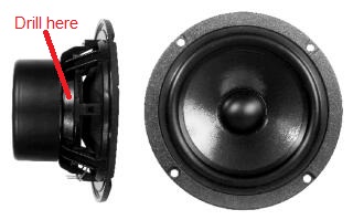

Well I have a pair of AP130Z0 HDA drivers, and the TM025F1 soft dome. crossover essentially cannibalised/stolen from the vance dickason centre channel HT system, WITHOUT the pair of AP210Z0 HDA bass drivers.
Theyre really very good, considering I bought them when they were alot more freely available. Having seen the HM130Z0 and Z10 for sale again, and also the HM170, which i hadnt previously considered, Ive thought about an upgrade to the old speakers.
The trouble I have is that both the HM130Z0 and Z10 have very low Qts lower mms. They would make a nice small bookshelf monitor, but the bass would be limited in comparison to the AP130Z0 i have now in ~15 litres.
I may just try and source some spare AP130Z0, and find a good tweeter upgrade to the Audax soft domes. They arent the smoothest tweeters....
Im even considering getting a spare pair pair of Ap130Z0 and taking the magnet off somehow.... Then I can take it to work and drill a pole piece vent out. 🙂
at least then, IF it should go horribly wrong, I have a spare pair to replace them.

Done at least three time with a lot of success 😉 I think the spare pair will be drilled too 😀...

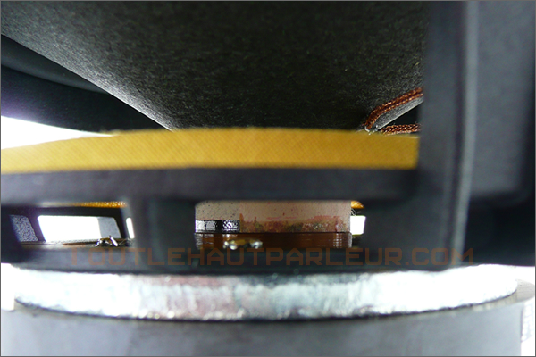

It you look the high end version HM130Z0, the motor has vent and is well ventilated

How are you going to make sure that the swarf from the drilling operation does not (eventually) make its way into the voice coil gap?Done at least three time with a lot of success 😉 I think the spare pair will be drilled too 😀
Good question 🙂
With a hand drill, it's very risky. Perhaps with a press drill, it's easier, you can limited the deep of drilling.
The better solution is to make the hole with a soldering iron . Drill with heat 😉
Good question 🙂
poly baskets are handy sometimes!!!
I plan to remove the magnet, cover the mag gap with masking tape. then Clamp in a bench drill, tape facing me, and drill. using tack to remove any swarf in the drilled vent 'hole' before removing the masking and reassembling the driver.
I work in a HV, EM machine manufacture and test facility, so im used to swarf precautions
Thank you Jerome, your suggestions have been very welcome. I am seriously considering: i) drilling magnet pole vent, ii) drilling behing spider vent, OR iii) removing the dustcap, and trying to get a phaseplug made. Its going to be a difficult decision!

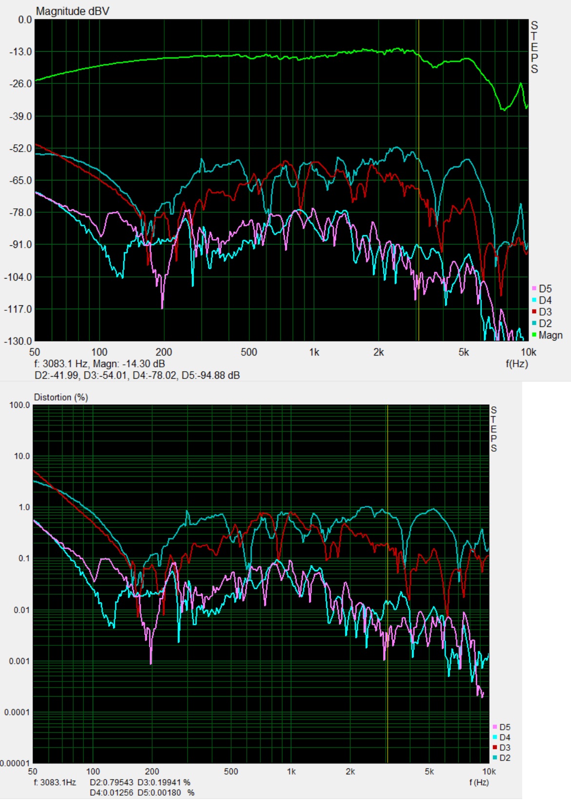

If the graph is to be believed...

very nice.
Google Translate
very nice.
thanks
well -40dB is fairly good? I would think so but i dont often have luxury of distortion plots. Never seem to be able to find the ones i want! It would be interesting to compare the distortion plot of the AP130Z0...
