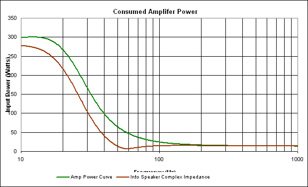

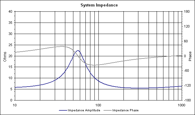

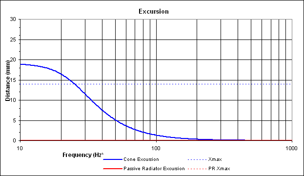

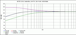

Still, you have a fair shot with TD 12 S-8.
In a 70 litre sealed box with 13 dB Linkwitz transform gain.
(Fo=53Hz; Qo=0,48; Fp=25Hz;Qp=0,7)
F3/F6/F10=27/20/15Hz

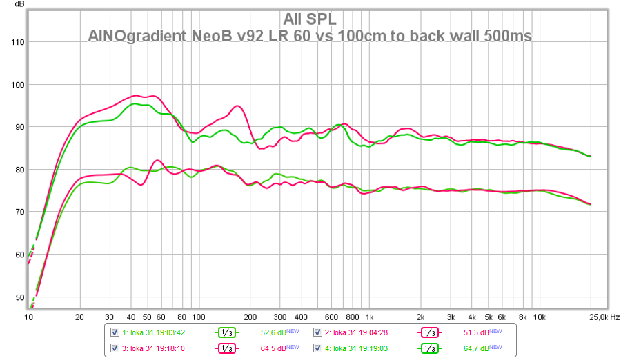

That's getting very dangerous! I run a 10" SEAS L26ROY in a sealed 30L box, downfire. Some findings by experience: (for dsp systems)
- first with no eq, measure acoustic performance in nearfield and at listening spot. You will see what speaker positioning and room modes are doing.
- be very careful with gain to avoid digital clipping in dsp process! Rather apply attenuation above say 40Hzin reverse (high/low shelf and +/- values total the same).
-measure distortion in nearfield with high output, look and use fingers to estimate excursion!
- Then also apply deep cut-off for subsonics below 15Hz especially if you have a vinyl turntable/RIAA without subsonic filter!
This way I got straight room response starting from 16Hz!
http://www.diyaudio.com/forums/atta...ect-ainogneob-v92-lr-60-vs-100cm-backw-13.png
