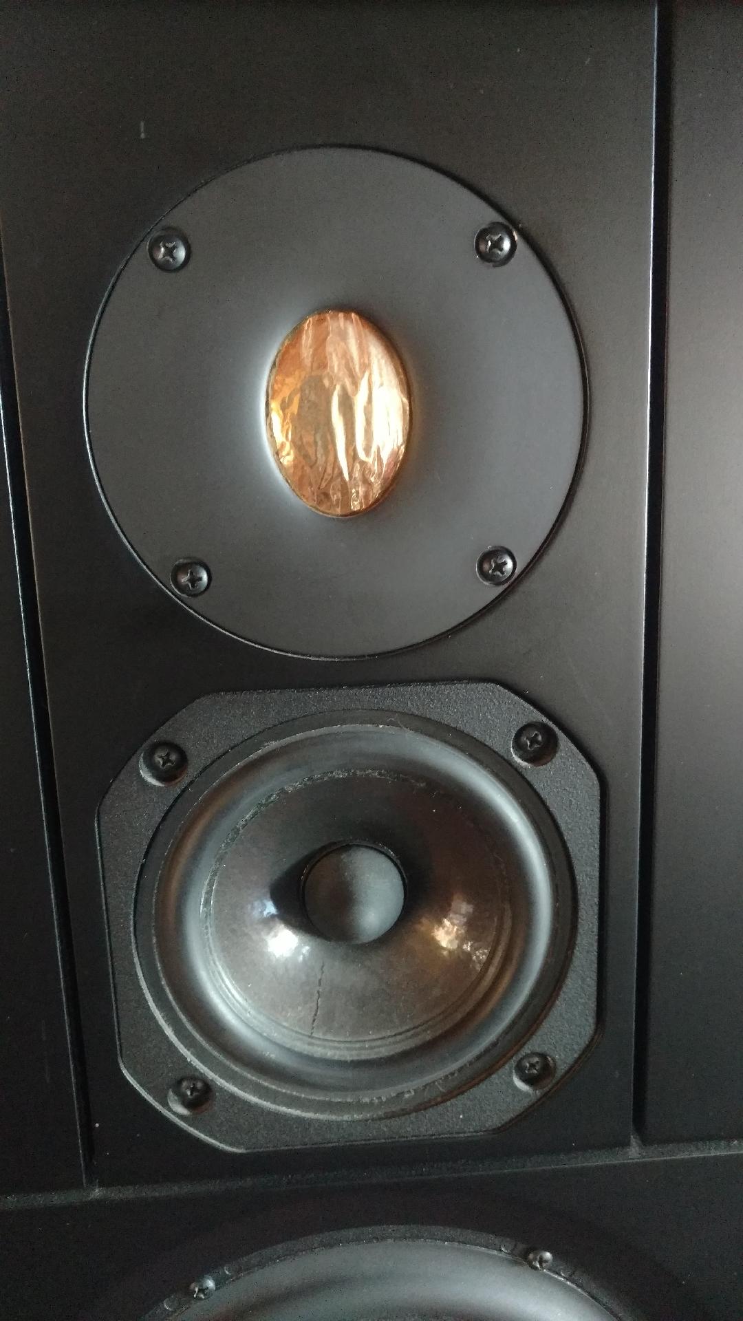

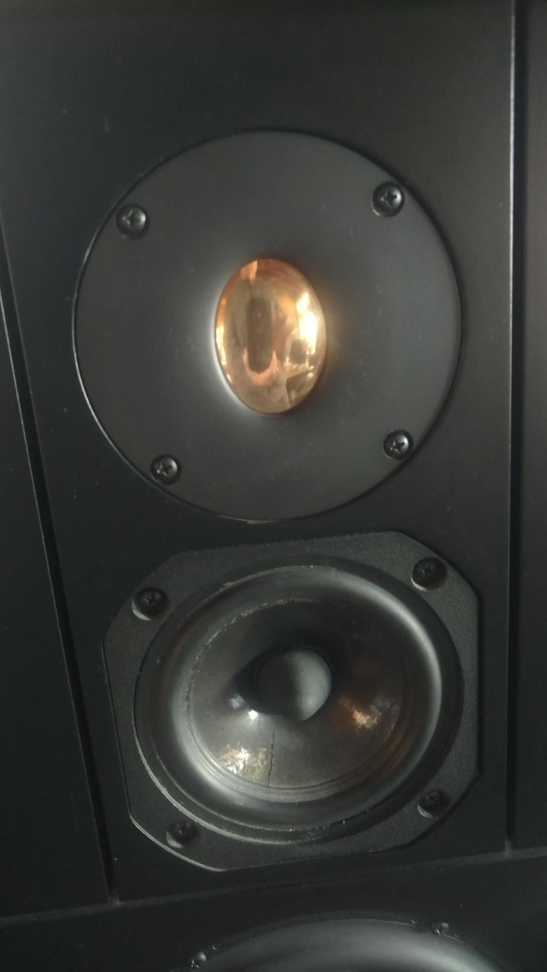

I also just reinflated my gold dome Audax HD3P tweeters using the vacuum cleaner / freezer method, and I must say, it worked beautifully. I’m thrilled. These 20-year-old tweeters look brand new again and never sounded better. And they have been holding air for over a week now and I am confident they will last a long time. This is an easy, free, maybe permanent fix, using simple tools, and it can be done without cutting or de-soldering the speaker wires. And if it does air down in the future, the fix can be repeated. I’ll go into detail, but proceed with caution, no guarantees, this is just what worked for me. Three steps.

Finally, you may be able to reinflate your tweeters with only a vacuum, or only freezing, but I didn’t experiment, and I only tried the vacuum plus freezing method. If anyone wants to try only one or the other or compare to both, it would be interesting to know the results. I know these tweeters are getting old, and fewer and fewer fans, but there probably are still a few. For full disclosure, my research reveals there are some commercial solutions still available for these Audax HD3P’s, such as the Moca Audio in France inflation valve modification, and the Willys Hifi in England replacement kit using Scanspeak D2905/950000 drivers and a new crossover. But this is a DIY site, hence my post. Before and after photos below. Best of luck.
