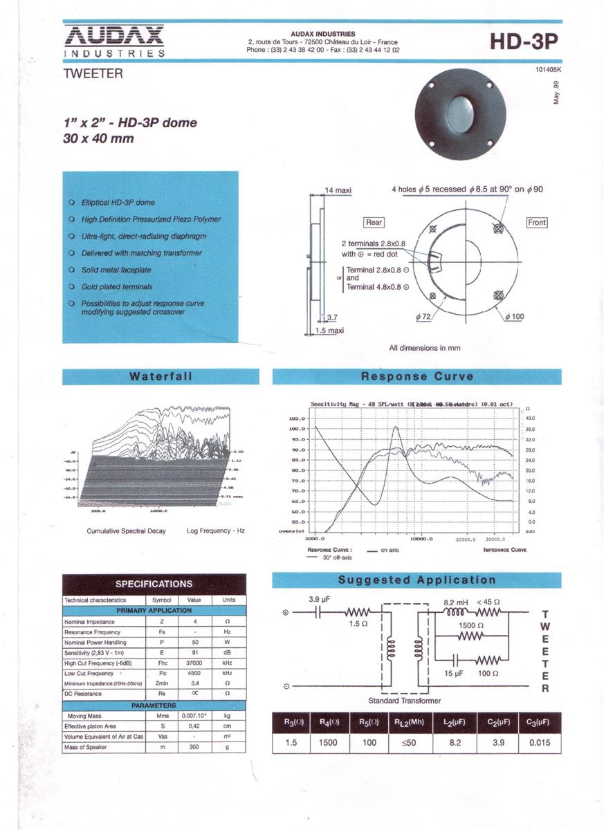

Hello Jabiru, why don´t you try reading below message one more time it is all in there.(?) AWG32 is a very thin wire. You´ll get at least 90dB sensitivity with this air-transformer.
So, here goes. What you´ll need is AWG24 emanelld copperwire for the primary (inner)winding and AWG32 for the secondary. You´ll need about 6 meters off AWG24 to get
@0.5ohm primary input DC resistance and you´ll need about 262 meters AWG32 to get @141ohm secondary output DC resistance. At the input you should add .68ohm in series with the transformer to (-)input as well as a 4,7uf in series to the (+) input. At the output you should have 1,5 kohm resistor in series with the tweeter (very important to use this resistor otherwise you may melt the diaphragm on transient signals ). Use 5W wirewounds in both cases. The bobin should be 15mm in diameter and 15mm in height.

But I need sensitivity of 96dB not 90dB, so the question is how much wire or to what resistance do I need to add wire to the secondary to raise the sensitivity by 6dB using AWG32 ??

Ok, reduce input series resistor (0,68ohm) to zero and the output series resistor to 470ohm. In parallell with with the transformer primary winding a RL series network consisting of a resistor 0.12ohms and a air coil at 0.13mH. The input series capacitor should be 2.7uF for @7400Hz. This gives you 96dB sensitivity with the above mentioned and original transformer. That is all I can contribute you with, the rest I leave to you and others.
If anyone is interested I have the Audax datasheet for the HD-3P and can scan it and make available for members if they would like a copy.
If you can post it here that could be useful at some time, I'm still waiting for components to connect mine as suggested ! Thanks

There were earlier inquiries on improving the Sensitivity of the HD3P Unit to
96dB.
Was there a successful outcome to this modification to the HD3P ?

Firstly, did you manage to wind the transformer I adviced? Secondly, did you manage to raise the output 6dB? Because that was what you requested and I answered, now I was just wondering how did that go. I did not see anything in your answer refering to those requests only how you made a complement filter to your Lowter.

But on the 8th April you said " Ok, reduce input series resistor (0,68ohm) to zero and the output series resistor to 470ohm. In parallell with with the transformer primary winding a RL series network consisting of a resistor 0.12ohms and a air coil at 0.13mH. The input series capacitor should be 2.7uF for @7400Hz. This gives you 96dB sensitivity with the above mentioned and original transformer. That is all I can contribute you with, the rest I leave to you and others. " - Original transformer - so no I did not wind a new transformer !! I assumed making the changes above would raise the output to 96dB ??
