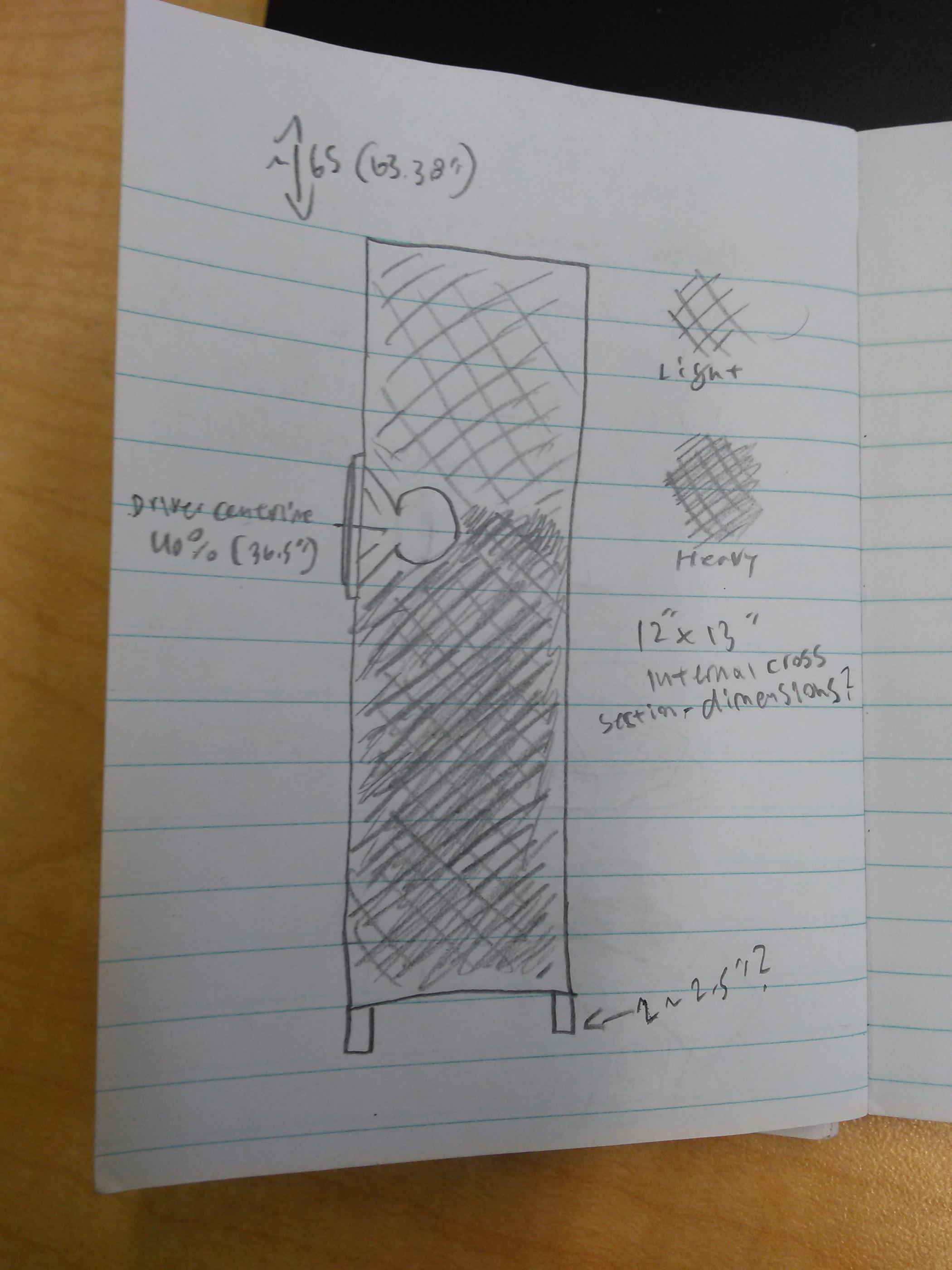

OK, I took the MLTL sim and turned it into a ~63.38" long x ~153"^2 open bottom TL, raising tuning into the 40s with a ~40% driver offset to minimize frequency response 'ripple' = 36.5" from the bottom, so several inches of elevation to experiment with, which normally is more than enough as you want the floor to preload it a bit.
The sim blue line is with the MLTL's minimal lining of the top, one side and back with the red line a 100% fill with ~1.4 kg of polyfil.
Stuffing just the top half or so won't be enough to damp the lower mids 'ripple' without heavily rolling off the [mid] bass plus the upper half from ~the driver centerline - top is half the stuffing density of the lower half to minimize mid-bass loss, i.e. this is the area where one normally should adjust a pipe's damping whereas a vented alignment is the opposite.

So, if I understand right, that would give us something like this-
attachment.php
(amateur pocket-notebook sketch)
This is assuming 1"~2.5" feet at the corners, and internal dimensions of 12" wide by 13" deep, and to kinda-sorta roughly make up for the volume of the driver lets just call the height 64" even internally.
Is this about what we're getting at? 1/2~3/4" plywood with some bracing in the middle under the driver might work, I'm thinking.

Well, while moving things around in the garage I found myself looking at these drivers again, and wanted to give this thread a gentle bump with regards to figuring out a simple but effective cabinet for them. My uncle and I (my family lives with his family) have somehow ended up with a pretty good quantity of plywood (mostly 3/4", some 1/2") in 2'x8' approximate sized sheets- they may come in handy here. I'm still trying to see what a good rectangular box would be for these, assuming I cross them to a subwoofer I don't mind them only needing to reach down to ~80hz or so. Would something like my above sketch still be suitable, or would I be better off making them shorter and wider?
I'm almost inclined to make a pair of cabinets that are ~14" wide, 60" tall, and ~16" deep, with a few inches of space at the bottom that has adjustable feet. Pocket holes and glue for the construction with some braces internally should prove adequate. Stuffing as shown earlier. I'm just unsure.

Yeah, a high Qt, 15 W/2mm Xmax driver isn't going to generate much in the way of acoustic pressure in a large damped box, so minimal bracing to tie/mass load the driver to a sealed cab is sufficient.
Altec recommended a minimum 1.5x dimensional gap to parallel walls and while never seen it published, their cab designs tended to use this with perpendicular walls too, so based on the 330's dims would be ~16" i.d. wide x ~12" i.d. deep.
