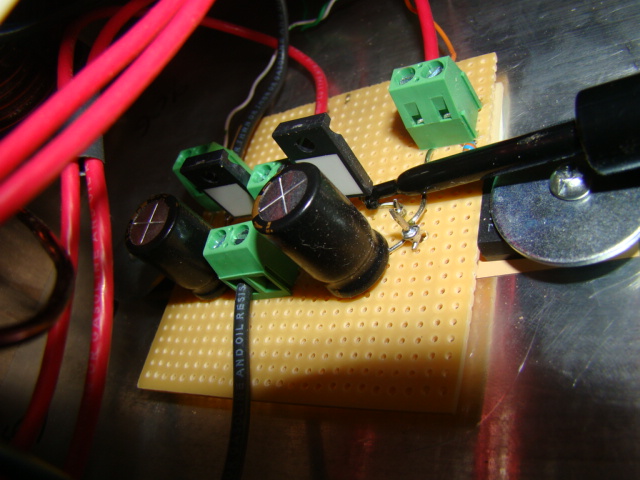

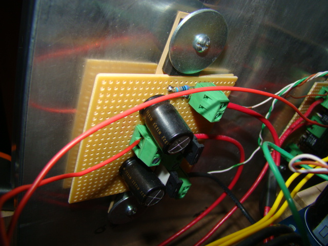

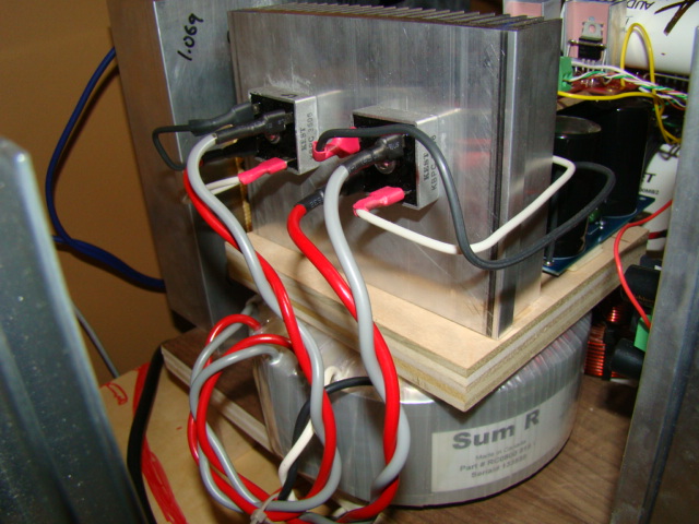

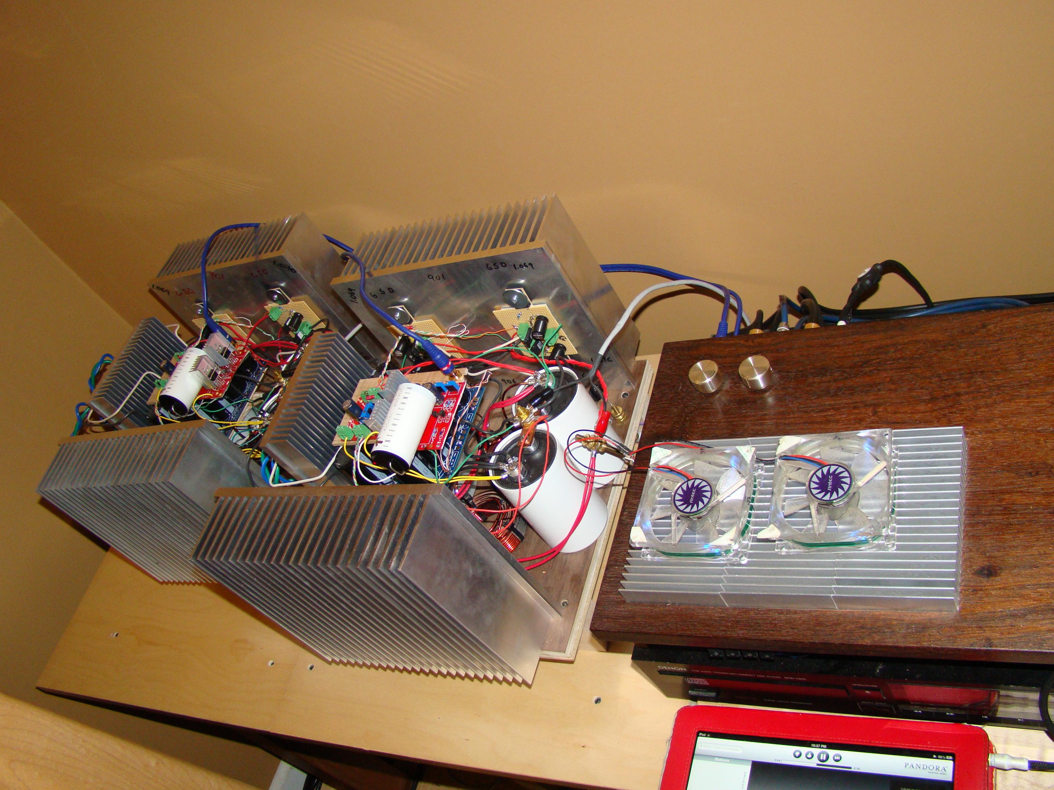

I'm using a ba3 front end driving 4 pairs of buz 901/906 lateral mosfets. Output circuit is f4 style wired point to point. Works for me.

a photo please
The amps were put together quick and dirty to try stuff out. I did try them with irfp240/9240 outputs. I like the lateral mosfets better.

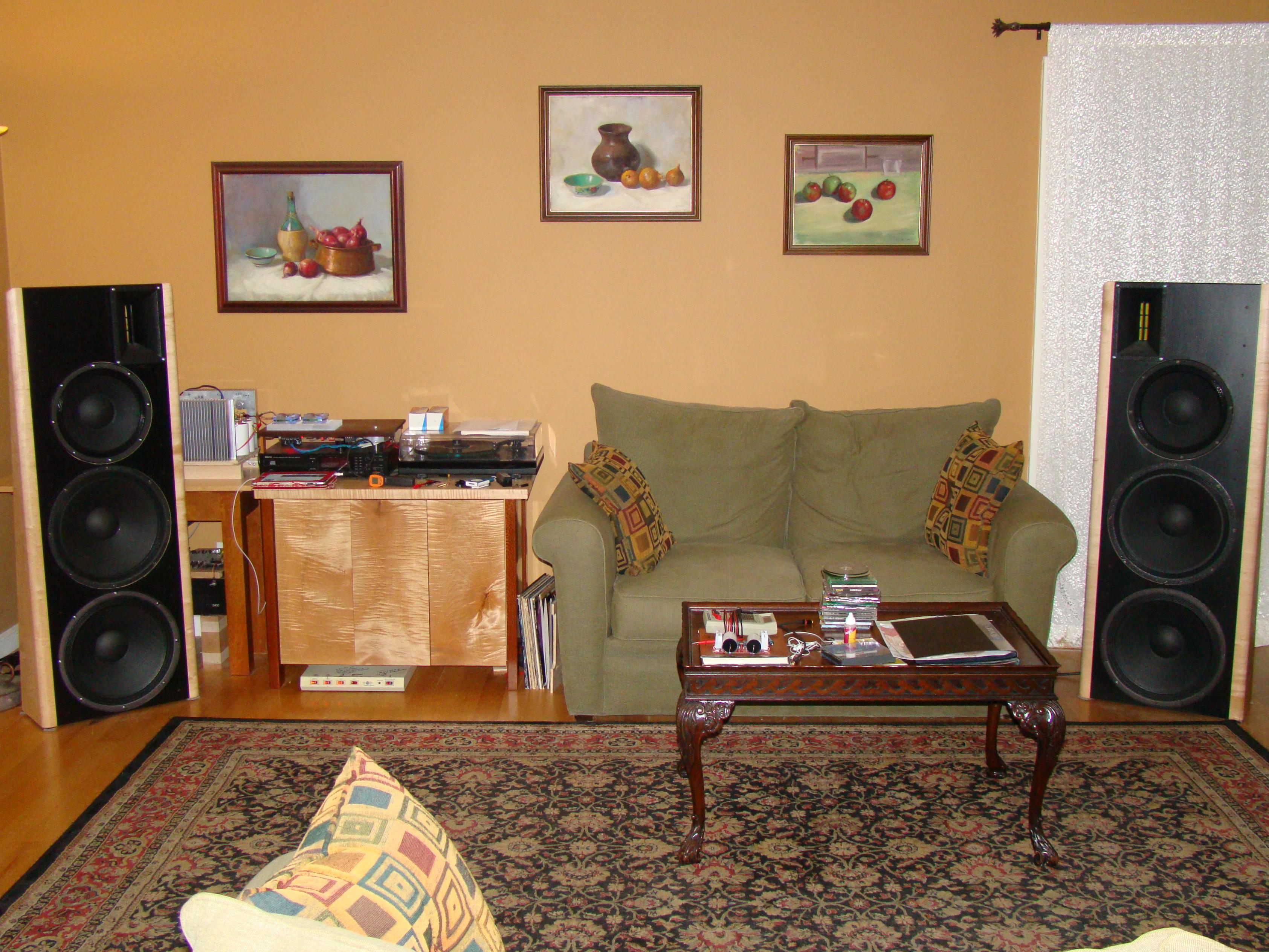

The speakers are
Creative Sound - Product Details
http://profesional.beyma.com/pdf/12MI100E.pdf
Driven through a passive crossover by the amps in the picture
The woofers are eminence 15s crown amp and a mini dsp.
The system strikes a nice balance .....sounds great playing girl with guitar and plays loud enough to satisfy the inner rocker.
