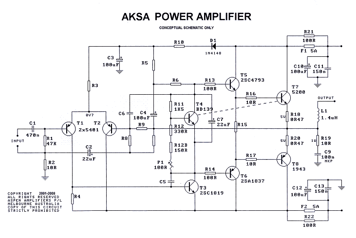

My AKSA amplifier mod 🙂
http://www.kuprevicius.kaunas.lm.lt/AKSA_FINAL.jpg
It looks good in simulation (SWCAD). But how it works in real life I don't know. 🙂 Now I' m making PCB for this mod. So if there are some big mistakes (amp will sound terrible or it will blow at first test )
Please, help me to correct them 🙂.
Thanks in advance.
Thanks in advance.

I 've posted AKSA amplifier mod.
PMA,
I think you expected something different, on that image 🙂.
Here are some more different versions of mod:
http://www.kuprevicius.kaunas.lm.lt/AKSA_FINAL1.jpg
http://www.kuprevicius.kaunas.lm.lt/AKSA_FINAL2.jpg
which one is worth to try?

I've attached a conceptual schematic of the AKSA. Some details are missing, of course, but all detail is revealed in the kit documentation. I choose not to reveal all in a public domain; my IP, my prerogative.
I would prefer not to discuss the details of this ad insanem; this is a very simple circuit, the sound is all in the details.
Hugh
