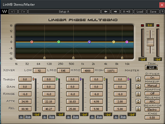

There is no proper there is only your desired outcome...I was wondering if someone knew how to arrive at proper values for a band, based on its frequency content
Besides, it would also be nice to know of any existing methods/tables/standards for obtaining these values from the crossover frequencies.
It depends on which attribute you are focusing on....there are other specifications that have been left out, in particular, the knee...if there is one...and the ratio...limiting is usually like 10:1 or higher...rms reads averages peak reads....peaks...the threshold is point of action unless there is a knee...if there is a knee, depending on the shape the limiting may actuate before reaching the threshold... Per frequency is a tricky question...the trend I've seen suggest faster times with higher frequency.
This is the default setting on one of my linear phase limiters...
Before you read into that...consider what it is you are saying...If you are wanting speaker protection...fastest attack time is the goal no matter frequency, release times adjusted to taste by ear but judging by the default setting (and experience) on the limiter above higher frequencies are more sensitive to longer release than lower ones...complete transparency only leans away from protection OR turning the volume down, since you shouldn't be clipping if aiming for accuracy. Going into more detail has nothing to do with loudspeakers per say and more to do with sound design/signal design.
Limiting isnt something you want to do...its something you have to do.....Your music has already been dynamically tailored, our/my goal (in this part of the forum) is accuracy not colorization...If you are hitting the limiter and don't want to...buy bigger amp/speakers...If you are in a PA situation, the limiter keeps you from destroying your speakers when **** gets out of hand, but at the sacrifice of sound quality. If you are a sound engineer you are using a limiter to create certain effects or controlling dynamics etc etc from a creative stand point or technical...and you are not using an home amplifier with built in limiter to achieve it...unless thats the only way to get said desired creative vision expressed lol! Better said, maybe that is the only way to achieve desired sound...The limiters we use in the studio have way more options but there are limiters built with tubes and transistors etc etc that provide a colorization that digital is just on the vertgeof being able to replicate 100%...then bye bye analog hardware in the studio...except for that one crowd. I have my learned ways of creating transparent limiting....but it has nothing to do with protecting a loudspeaker and everything to do with signal design.

Hi Camplo, I'll respond to both of your posts in this one.
It super duper rocks imo, that you posted "There is no proper there is only your desired outcome.."
That's the big picture, and big picture is most often missed on our DIY forums, imho.
DIY generally likes to debate about stuff -60dB down Lol....
Limiters and compressors are quite related, but different tools. Compressors are more for input channels and sonic sculpting.
Good live sound and studio guys know how to use them, I don't. Like you were showing, knee, ratio, ... add key frequency...add all kinds of things to compressors.
None of those normally exist with simpler limiters, used on output channels, for either peak or RMS. I do feel I'm technically good at limiters, but acknowledge it's still an art.
Frequency clearly has a role in such limiters, as it effects their attack and release times.
We do not want the same attack time across the frequency spectrum, even for peak limiting. Not at all, and even more so for RMS.

Thank you camplo, for sharing your views and settings. I am guessing that attack/release are in milliseconds, please mention if otherwise.
Just like you, many of us have noticed the time-constants change with frequency, but never understood much about any direct connection between them. I put up the question mostly for the purpose of knowledge gathering, as I don't have any proper hardware yet.

WE don't have to argue too much into detail...I can tell from your perspective you are not a studio guy. Thats not to say you aren't educated on the topic just that you don't talk like a person whos spent years designing signal ....The limiter commonly is the first tool on a track...no ones (in regards to sound design) thinking too much about input/output in this fashion as compressor vs limiter. The signal (music, vocals etc) comes in...we design it...then it goes out lol....
"Limiters and compressors are quite related, but different tools" - the major difference between a limiter and compressor is the ratio of the dynamic attenuation ie... if I take a compressor and turn the ratio up to 10:1 or higher....its is now a limiter...So limiting has a special place and became a separate tool. Most limiting is going to be wanted with a fast attack so you don't always see attack settings on a limiter its stuck in whatever the fastest times it could do because limiting is usally meant o be as transparent as possible....limiters once tended to be broadband, addressing the whole signal not just a specific band unless a filter has been placed before the limiter...Multiband compressors/limiters eventually came and then we can be more specific about how the limiters reacts to frequency to some extent.
The multiband limiter has its own sacrifices and thus will not make the wideband limiter obsolete anytime soon.... splitting and reassembly of the signal has consequences long story short...a multiband limiter is a conjunction of filters placed before multiple limiters in one tool....
"We do not want the same attack time across the frequency spectrum" - well if you don't have a broad band limiter you ain't got a choice do you...
"Frequency clearly has a role in such limiters, as it effects their attack and release times" - a simple limiter reacts to signal as it crosses its threshold with no regards to frequency
"I've never seen anyone try to set limiters with music" _ Once again you seemed removed from the actual act of sound design with this comment...I literally set limiters with music any time I mix/master a song....as they say in the studio world...use your ears...In my example for home audio limiter setting all I said was to play music and monitor the signal...I never specified voltage or wattage.
In the playback world, if interested in scientific sound quality...a limiter/compressor will never touch your signal...
"More info than most home audio cares about i guess....." - the biggest point....a limiter to the home audio guy is just a way to protect his drivers.

The connection is your ear....if you had such tools you could play with the settings and it will make a lot more sense...Get equalizer Apo and download a multiband limiter vst and go to town then come back. I could try to put it into words but hearing works so much quicker. Multi band limiting allows one to apply limiting more selectively and thus end up with a more tailored result or more transparent result...
I repeat...from a user end viewpoint of music...you don't want limiting to actually happen in your playback...for this position in the food chain it should only be used for driver protection...the only other possible use is in trying to increase the loudness potential of the content at the sacrifice of sound quality...If you are normally listening with music under constant dynamic attenuation that is unfortunate. They are already over compressing main stream music as it is...ever heard of the loudness war?
To give clarity to why a multiband limiter is a good thing for the listener vs a normal limiter....OK, the bass is usually the highest in the signal level...maybe midbass at times...whatever the case maybe... lets say the multiband limiter has 4 channels separating 20hz-20khz...the peaks in the signal are crossing the threshold.... the signal is only going to be attenuated on the channel that the peaks exist on....as opposed to what the normal wideband limiter does, which is, attenuate the whole signal... no matter where the peaks are coming from when they cross the threshold...So basically when you turn up your music to the point that its hitting the limiter...it can protect your speakers and maintain some more of the sound quality by only attenuating on the channels that have been triggered....
All the home stereo stuff remains primitive...I have a 16 channel linear phase multiband limiter, thats old news for vst software (approximately 2011)....I barely use it unless a signal is causing a need for limiting with more transparency of said act, or tailorization of the signal, in this part of the art there aren't always "rules"...signal design can said to be an extension of creativity, adding to the music (content) itself. Which is why we don't do it as the listener unless wanting to change the creative outcome.

About frequency and time constants relationships: keep it plain simple.
For a whole cycle of a sinus at a given frequency we have a formula which will help to put things in perspective: 1/freq= 1 cycle duration in s.
A 20hz cycle have a duration of 50ms
A 50hz cycle is 20ms
A 250hz cycle is 4ms
A 500hz is 2ms, 1khz 1ms,etc,etc,...
With a limiter we try to 'grab' the signal as soon as possible so it make sense to define attack to the highest freq of interest within a band. For release it'll depend of band and what you want to achieve: idiot proof protection ( which will be highly audible and not pretty at all - the situation described by Waxx about Dj which understand what headroom is or not) or some subtle protection?
Sure a long release time will be more transparent but during this time if something happen...it'll happen!

- Attack/release rates for multiband limiters
