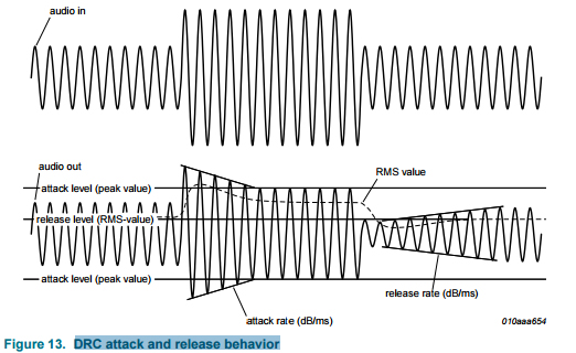

Thank you for the release timing calculations. However, regarding thresholds, I would only like to say what I told Mark100 in #17, that the same limiter threshold (-0.1 dBFS) could be valid for any amplifier, speaker, SPL and listening distance or simply put, even without any of those, as shown below:
Well, there're few things in common. However, a key difference is that Mark was indicating different time-constants for peak and RMS limiting, while the tables on pgs. 1&7 of the above article seem to suggest exactly the same timings for both limiter types. Anyway, thanks for sharing that.

The rest of limiting is time of attack and release, and is frequency dependent for both RMS/program and peak limiting. And requires different attack and release times for both.
Pages 1 & 7 of the MC2 limiting paper do show the same attack and release recommendations for program and peak limiting.
It appears he reason they do is because MC2 is assuming only a 3dB spread between program and peak voltages. (this can be seen top of page 7.)
That 3dB spread is very tight and makes the program limiter no more than an early bird peak limiter, imo ........hence the same attack and release times.
6dB or more is a far more typical spread between RMS and peak limiter settings.
Lower voltage settings than AES rating imply, and longer attack and release times are the norm for RMS/program limiting.
Any sustained voltage close to RMS/program will cause at least 3dB attention somewhere in the drivers passband, and often more.
The MC2 Program attack and release times are simply too fast ime.....and will like create a pumping sound when being on and off activated.
For example, a RMS/thermal sub limiter should take a number of seconds to attack, and a multiple of that attack release.

Please note that I'm mainly after the time-constants, not exactly the thresholds. But then, I decided to look into the thresholds in case they affected the time constants (for peak limiting). Hope this clears things.

Yes, I was mostly referring to the clipping inside a processor, with which the "don't clip" option is just not there since there're parametric EQs, shelves and gains for speaker compensation/crossover and it is definitely possible for a higher gain to be dialled in by mistake, or a wrong speaker setting to be loaded from the factory presets.
However, I was able to learn few useful things about RMS power limiting as well, thank you very much for that.
Now I guess the attack/release rates are equal to the gain/attenuation differences divided by the time-constants. That is for example, with a 1kHz crossover, 0dBFS threshold and a worst-case peak of +6dBFS, the LF attack rate would be (6-0)dB/1ms = 6dB/ms, with a one-tenth release rate (10x release time) of 0.6dB/ms, is that correct?
Glad to have helped some, even if not on your focus 🙂
I guess i feel like digital peak is digital peak, and doesn't need any time-constants. I still think it's a matter of gain structure and simply not allowing clipping.
