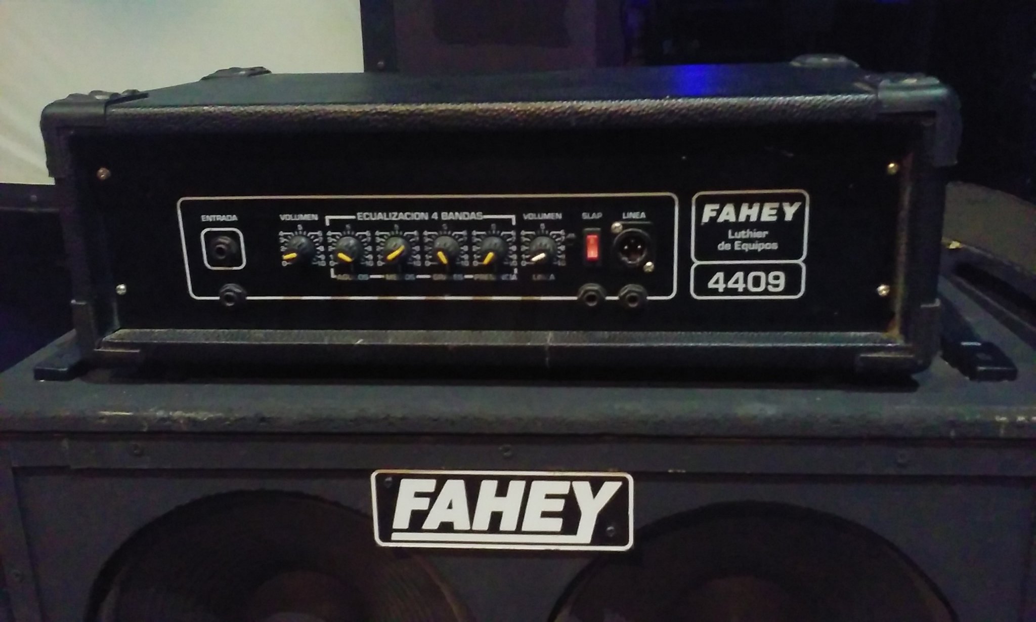

Original setup would have been a 250+250W head driving 2 of 4 x 12" Bass cabinets; now since this was a single night use, I supplied a current 300W Bass head (my bread and butter product) plus a single 4 x 12" cabinet (modern standard is single 4 x 10" or even compact 2 x 10" for portability), I HATE 15" speakers, but hey, we had to approach original 1969 looks onstage.
The beast closeup:
Sorry for the fuzzy unsaturated phone picture.
The beast closeup:
