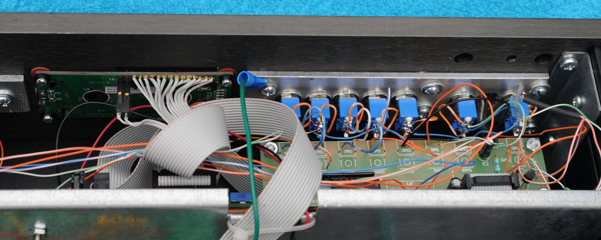

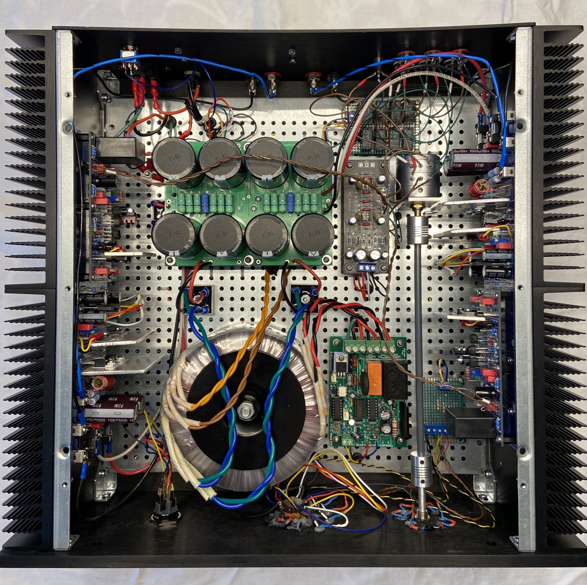

There is nothing special about this but, I can suggest two other methods for attaching (or connecting) switches to 10mm front panels:
1. For toggle switches with long actuators, mount the switch to a small metal plate which, in turn, is mounted to the inside of the front panel. The inside of the front panel must be bored to accommodate the barrel of the switch and the nut holding the switch to the sub-plate. A couple of threaded holes on the inside of the front panel will hold the sub-plate in place. The advantage of this approach is that no nut is visible from the front of the panel. The first two photos demonstrate this approach.

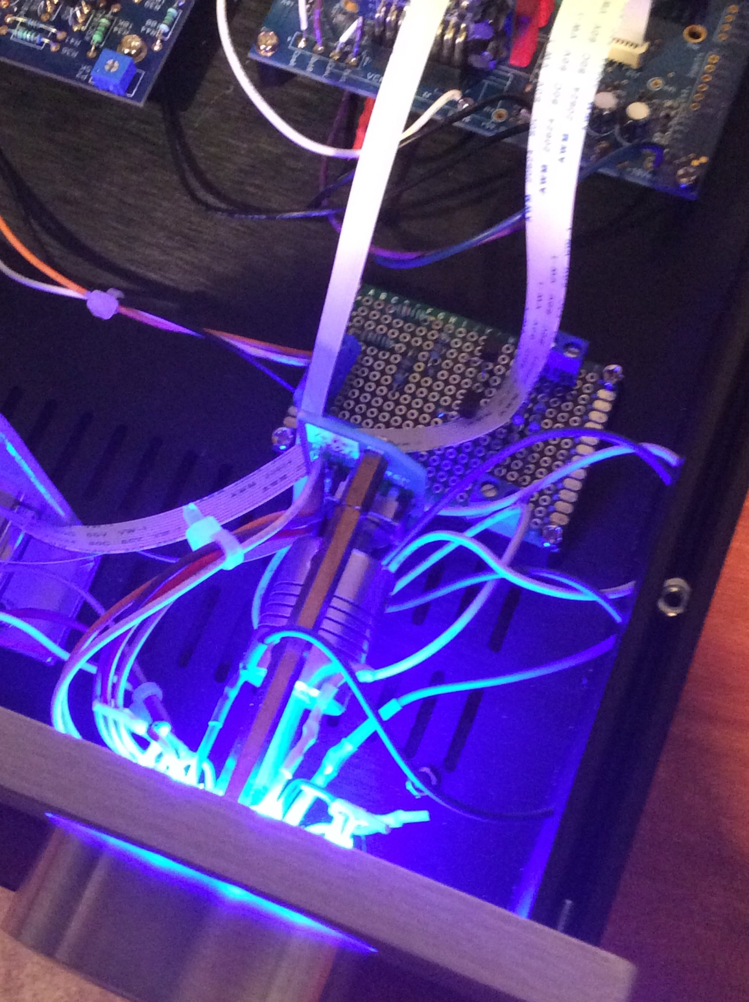

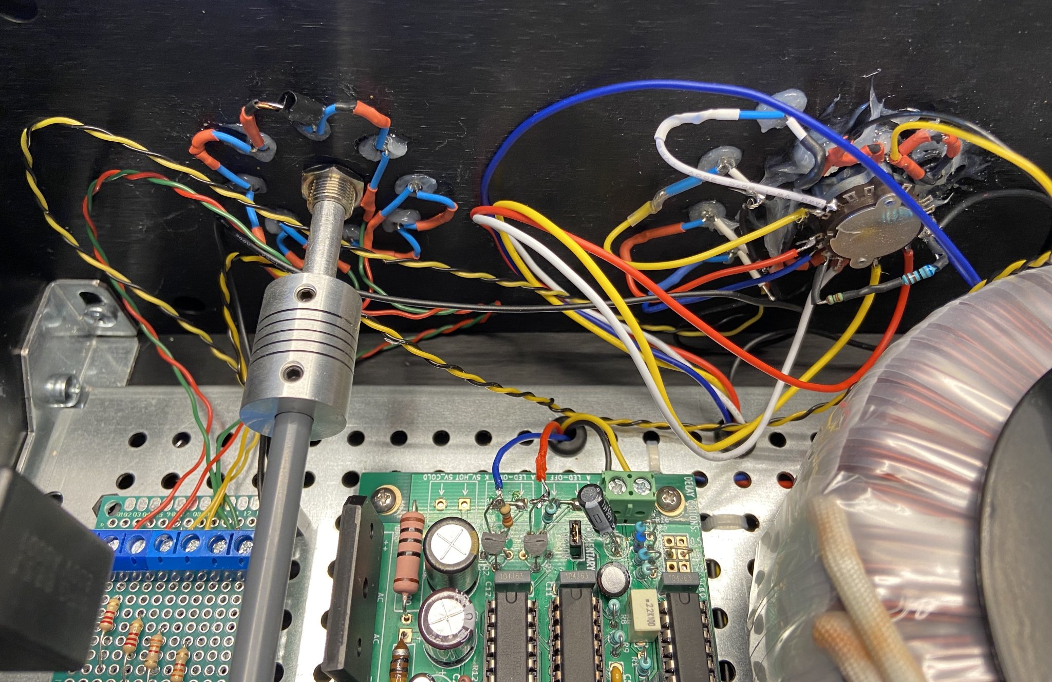

2. For rotary switches (e.g., source selectors and attenuators), use extension rods, shaft couplers and bushings. The third and fourth photos show an attenuator located at the rear of the chassis and the final photo is of an encoder mounted to the inside of the rear panel using standoffs and an extension rod, bushing and shaft coupler. The use of an extension rod makes the length of the shaft on the switch itself a non-issue.

Tony:
I'm a fan of plastic extension rods, since plastic flexes better than aluminum, but I use both. The diameter of the extension rod is best dictated by the bushings you use; given your apparent location, metric sizes will likely be easier for you to source (so 6mm rather than 6.35mm might be the way to go). Many folks here have recommended buying inexpensive 1/4" jacks and dismantling them for their bushing. I've gone the more expensive (perhaps idiotically so) route of sourcing both Imperial and metric panel bushings for my projects (e.g., the 1/4" bushings at https://www.surplussales.com/ShaftHardware/ShaftH-9.html), but the metric ones are harder to find. I buy shaft couplers from aliexpress, where they are ludicrously inexpensive (e.g., https://www.aliexpress.us/item/3256...00029478904733!sea&curPageLogUid=JsluBrWxtrtQ). And, finally, you might look at 6mm plastic rods at aliexpress.
I hope this helps.
Scott
I hope this helps.
Scott
