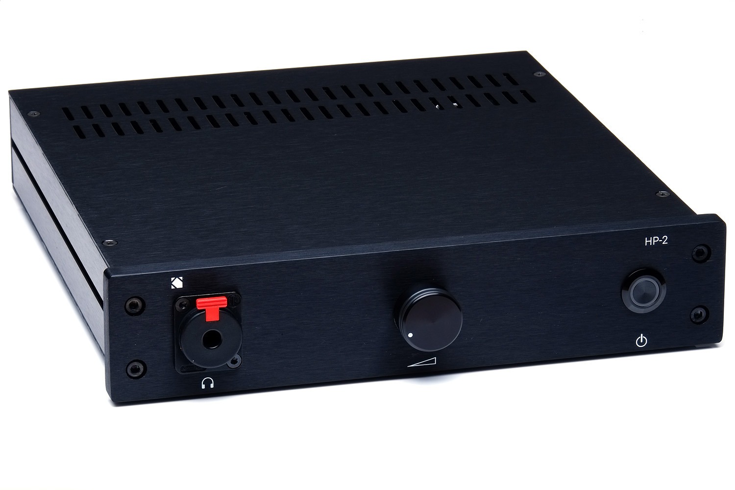

There is nothing special about this but, I can suggest two other methods for attaching (or connecting) switches to 10mm front panels:
1. For toggle switches with long actuators, mount the switch to a small metal plate which, in turn, is mounted to the inside of the front panel. The inside of the front panel must be bored to accommodate the barrel of the switch and the nut holding the switch to the sub-plate. A couple of threaded holes on the inside of the front panel will hold the sub-plate in place. The advantage of this approach is that no nut is visible from the front of the panel. The first two photos demonstrate this approach.
2. For rotary switches (e.g., source selectors and attenuators), use extension rods, shaft couplers and bushings. The third and fourth photos show an attenuator located at the rear of the chassis and the final photo is of an encoder mounted to the inside of the rear panel using standoffs and an extension rod, bushing and shaft coupler. The use of an extension rod makes the length of the shaft on the switch itself a non-issue.
