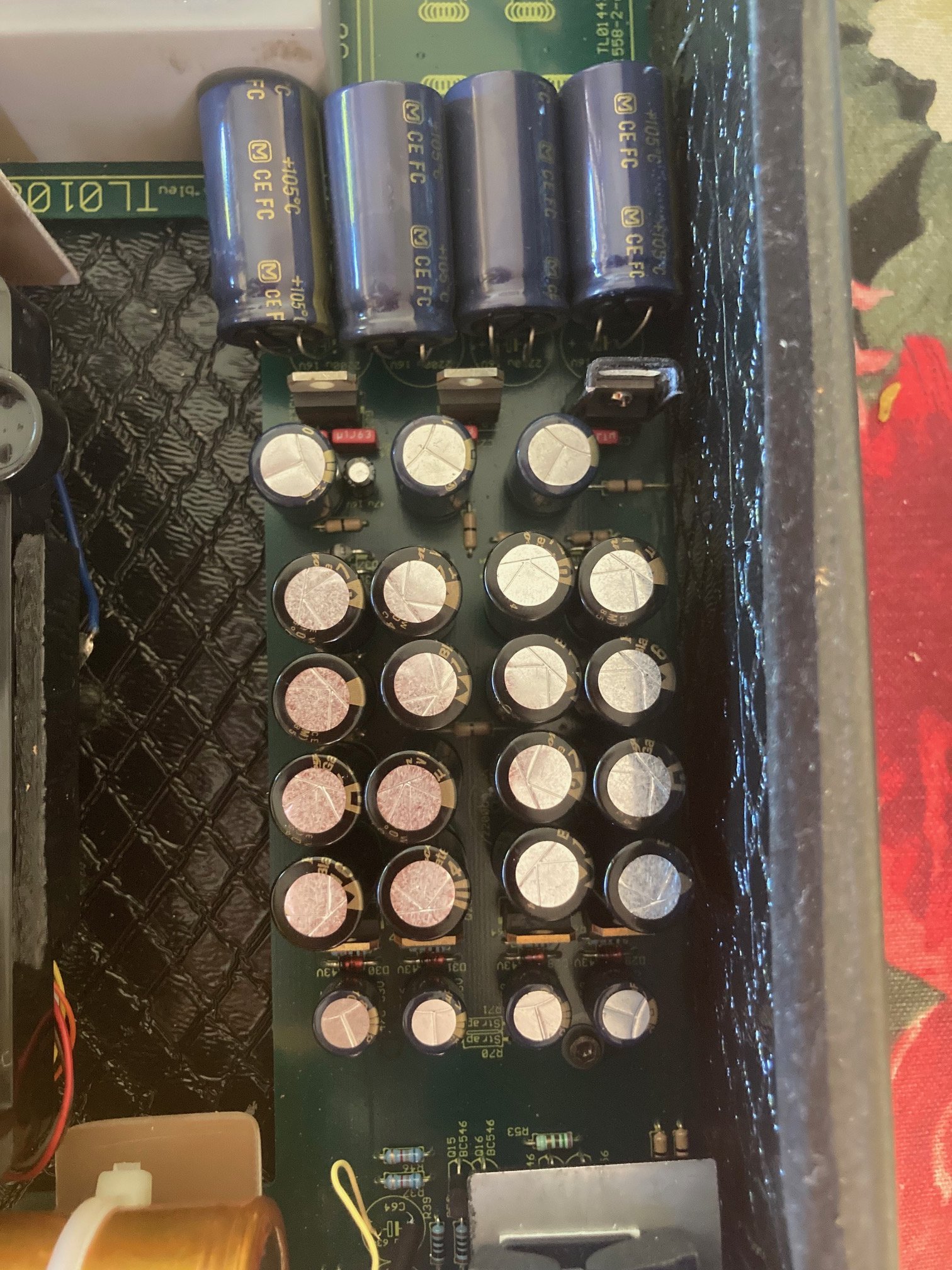

If an external dac works then the problem may well be after the dac. Try listening to the output of each of the Jensens in turn. A cheap set of headphone will be more than enough.I connected external DAC to the coaxial exit. Everything works fine, no noise.
I need help where might be the problem.
What I see in the pictures is not a upgrade, is a downgrade.
I'm tired of see faulty devices because the owner thinks that replacing capacitors and op amps improve sound, however, most of all times, instead of better sound, get a faulty device.

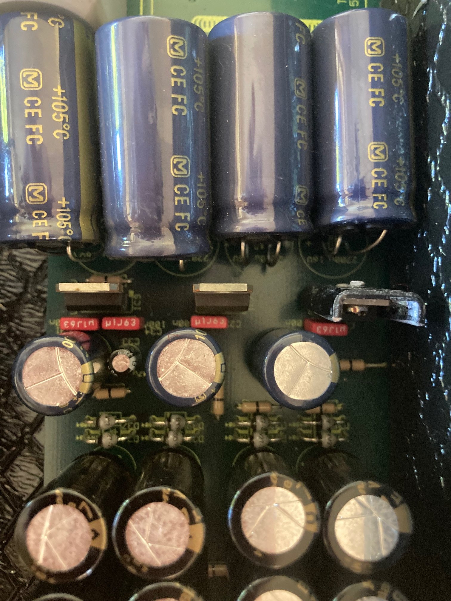

The noise on the right channel with the same pace as the flickering can be oscillation of a regulator probably because of adding too low ESR caps at the output of a regulator. Or it can be stray in noise by the ridiculously large capacitors with too long lead wires that function as antennas being too close to emitting electronics.
You possibly are listening to distortion and you like it 🙂 If the CD player will be without complaints chances may be that you will think it has lost its magic. Not my cup of tea, I like tidy and good quality work. I repaired such disaster jobs and nearly always the owner is then not satisfied (with solved complaints!) as he got used to the sound with complaints often paired with strong convictions so it is not rewarding do so.
"Normal" 78xx/LM3xx voltage regulators don't like low ESR/very high value caps at their outputs. In case separate regulators are use per channel you can almost be sure this is the case in that channel. Normally one uses a 10 µF electrolytic cap here with short lead wires and local decoupling further on in the circuit. A bit like the manufacturer did 🙂 Black Gate caps are nice but they're not suitable for use directly after the classic/standard regulators.
As noted, please do not complain the "magic" is gone. You might have the typical strong conviction the device is excellent (because of perceived reputation, boutique parts, higher price) combined with an oscillating so in fact bad performing device in reality. This can be frustrating. An oscilloscope will show you in an instance what is happening. Tools, measurements and basic electrical rules often are enemies of audiophiles that only use ears. "When it sounds good it IS good" 😀
Last tip: only use good quality parts that fit physically and solder the parts as usual in electronics so straight to the PCB without the silly habit of extension wires.

In picture 8890 I think we see extreme high value ultra low ESR caps used after the regulators. First suspects!

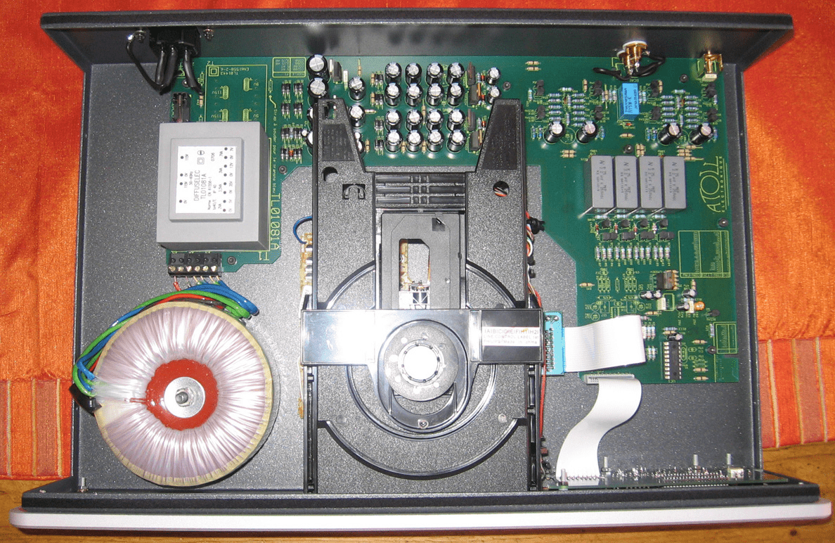

Forgive me Nasitch, but at least a dozen details make me jump when I look at the details of your turntable and I'm not talking about the choice of components, but especially the implementation, I just hope you don't have it not bought too expensive.
The noise we hear in your video is really strange because the frequency is quite high and ripples and looks like two drops of water like a belt slipping on a pulley.
to remove the mechanism, you must first slide the front of the drawer upwards, acting gently so as not to break the plastic flanges.
Once the mechanics are out, disassemble the main PCB to see what state it is underneath because I'm afraid of the carnage and take the opportunity to determine what the shunt is for (white wire on the surface, digital side).

In the attached pictures you can see : 8926 is general look of all regulators,

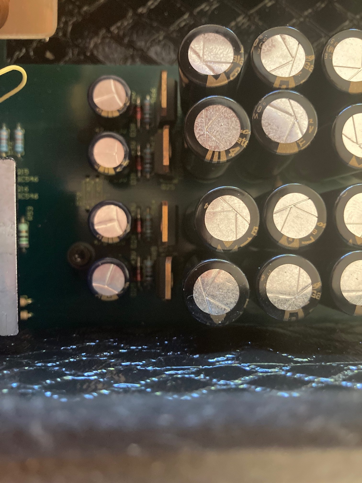

8924 seems to be the powers supply for the right , left channel.
Picture 8925 - power supply probably for the digital part.
I checked the 4 regulators from picture 8924 . They probably power the 2 channels separately because they make 2 identical +- power supplies .
Because I still have not taken out the PCB from the box I measured the voltage on the socket of the regulators.
One couple shows + 55 V -55 V, but the other one : +52 V - 55V, there is +- 3 volts difference.
What I noticed all regulators run warm, but that one that shows +52 V run very hot, I can not keep my finger on it. The capacitors after the regulators , when I touch them on the metal caps , they are also noticeable warm.
Also the regulators from picture 8925 ( 3 pcs , probably for the digital part, also run very hot, I burned my fingers.
I have to probably replace all this capacitors but I do not know what is the original value, before the mode ...
Do you have any other suggestions how to deal with the power supply? Probably the problem comes from there...

Change the PSU board back to original value caps and resolder all joints adding heatsinks to the regs while you are at it. Special attention to decoupling caps at outputs of regulators. Small value and normal industrial quality. Remove all BG that are used for that purpose. Leave the BG filter caps as they are OK at that spot.
BTW first time I hear of +/- 55V in a CD player. Very odd especially as “16V” is printed on the PCB.

Atoll electronics tend to run HOT and I won't be surprised if the output stage is Class A polarized to death.
On the other hand, their enclosures are great for putting something else in there. 😆
I got the impression that there is no active output stage anymore!?!?

By the way I changed all BG capacitors after the regulators with normal ones ( on the PCB were written the normal values). The big blue capacitors are also already soldered directly to the PCB.

The values on the regulators for the analog part are the same + 55 V -55 V, : +52 V - 55V, 1 shows 3 volts less than the others
