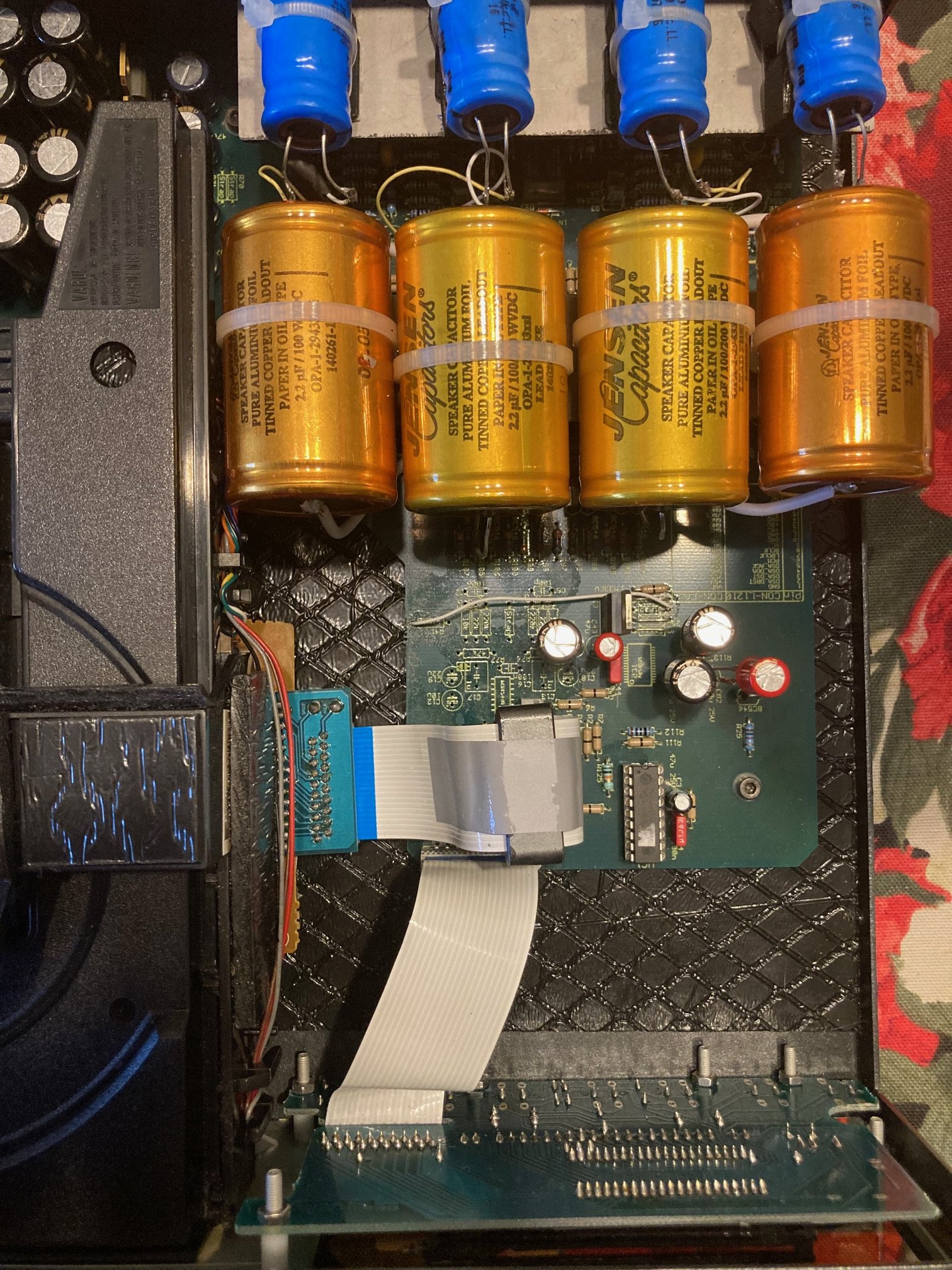

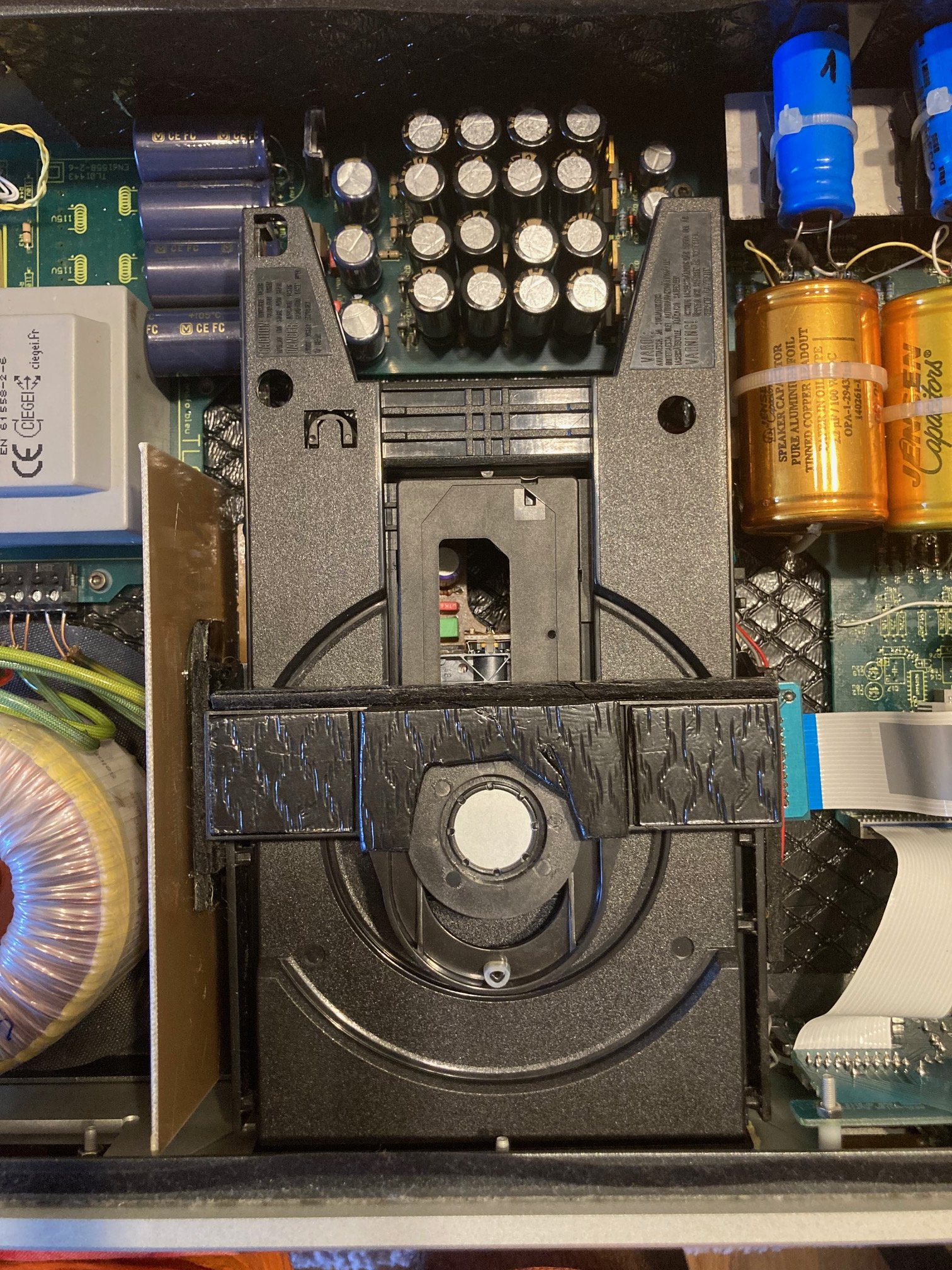

Hello everyone!
I have CD player ATOLL CD 200 first generation. The player is upgrated with better capacitors, sockets etc. I bought it like this from Germany.
The sound is beautiful, the job is very well done. It outperforms the new Atoll CD200 signature.
Unfortunately few days ago a strange noise appear in the right channel. The left channel is clean.The quality of the sound is not affected in any way, but in the low passages of the music the noise can be heard,
Here is a link where it can be heard :
I connected external DAC to the coaxial exit. Everything works fine, no noise.
I need help where might be the problem.

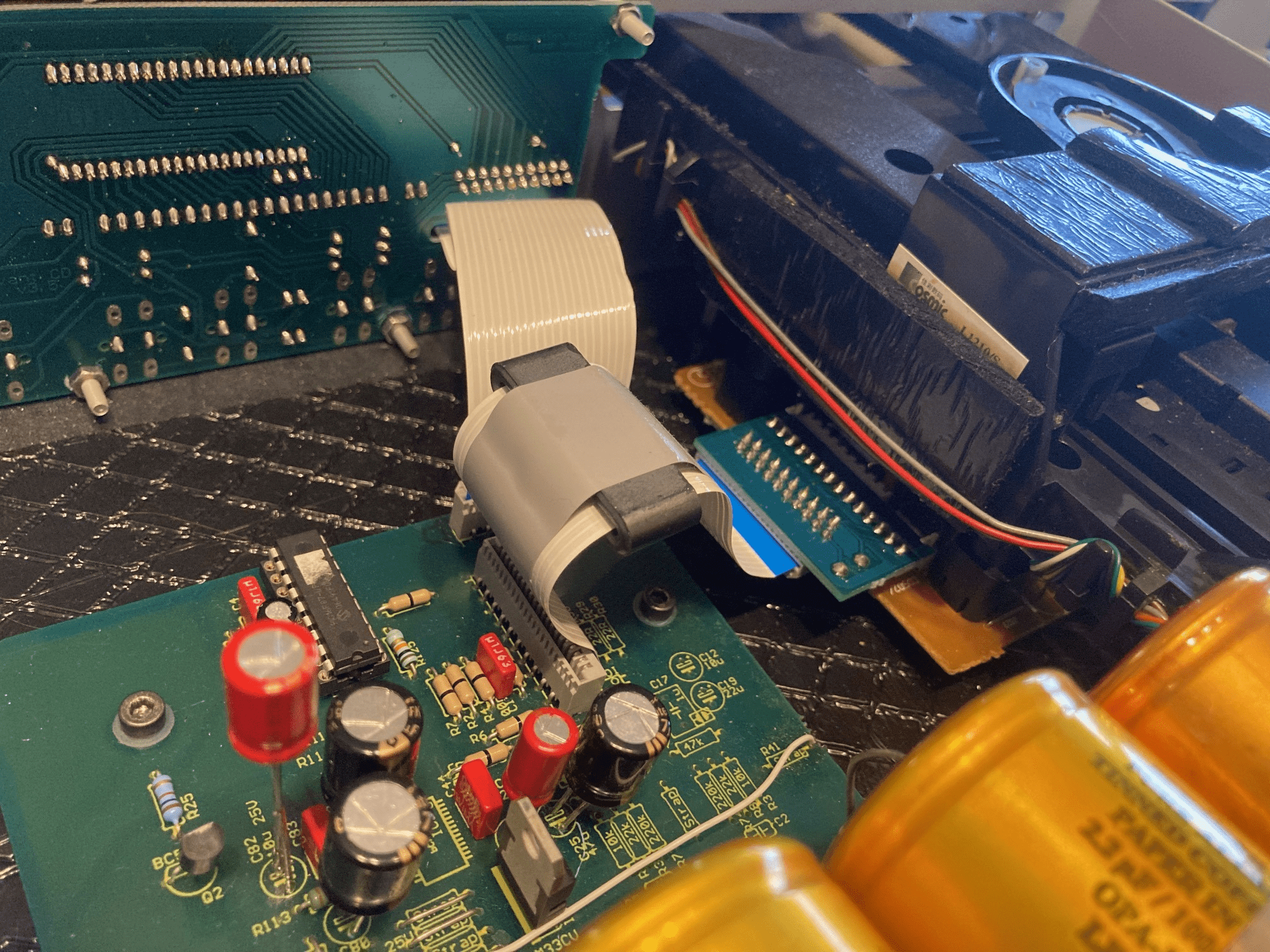

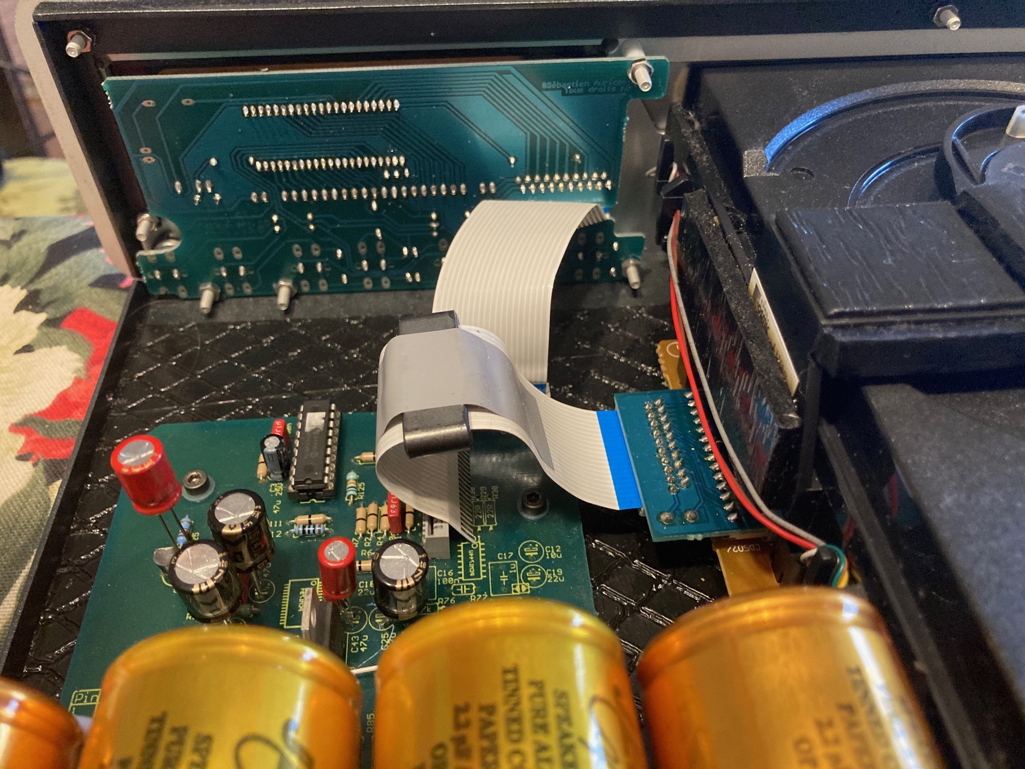

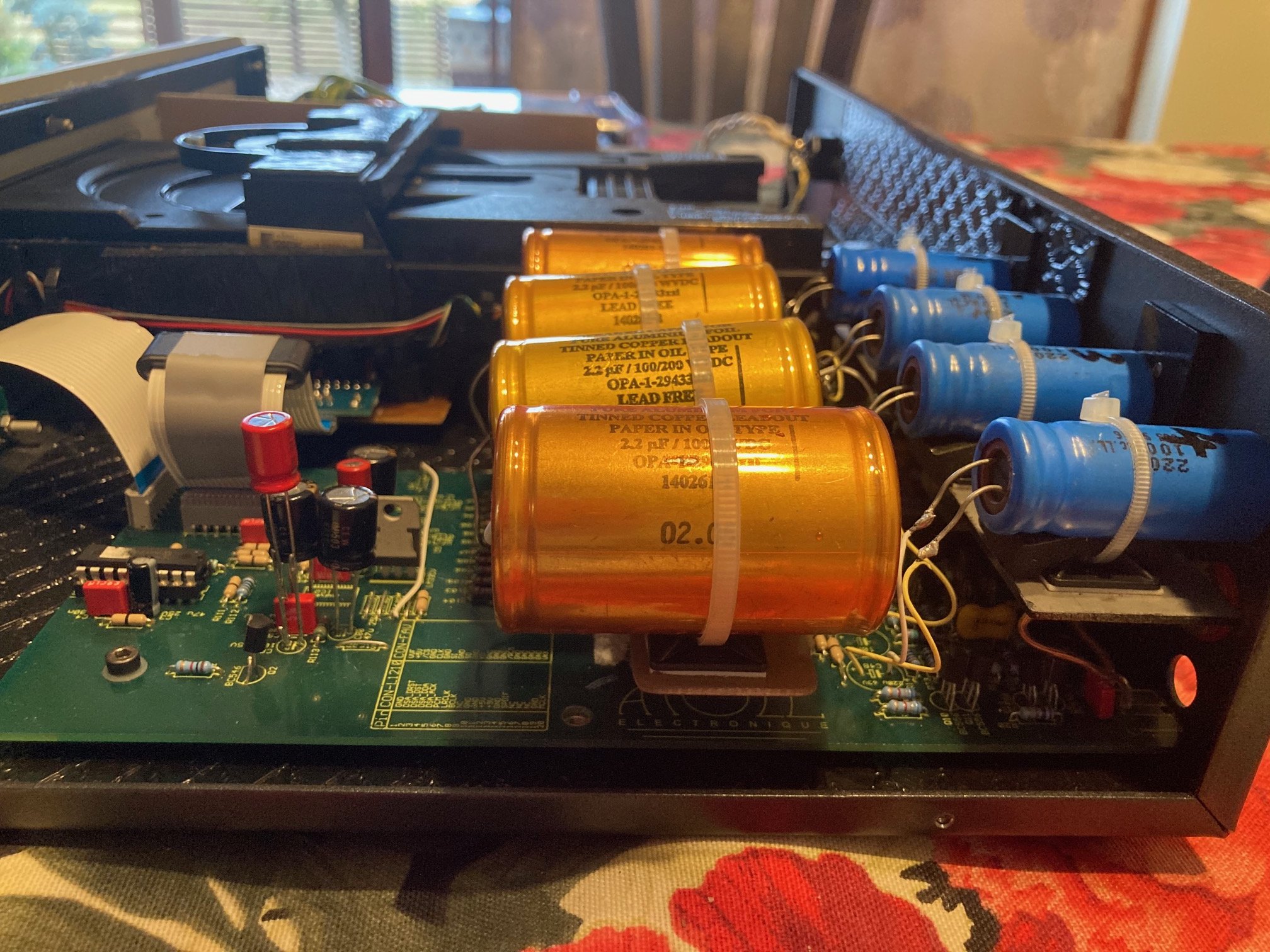

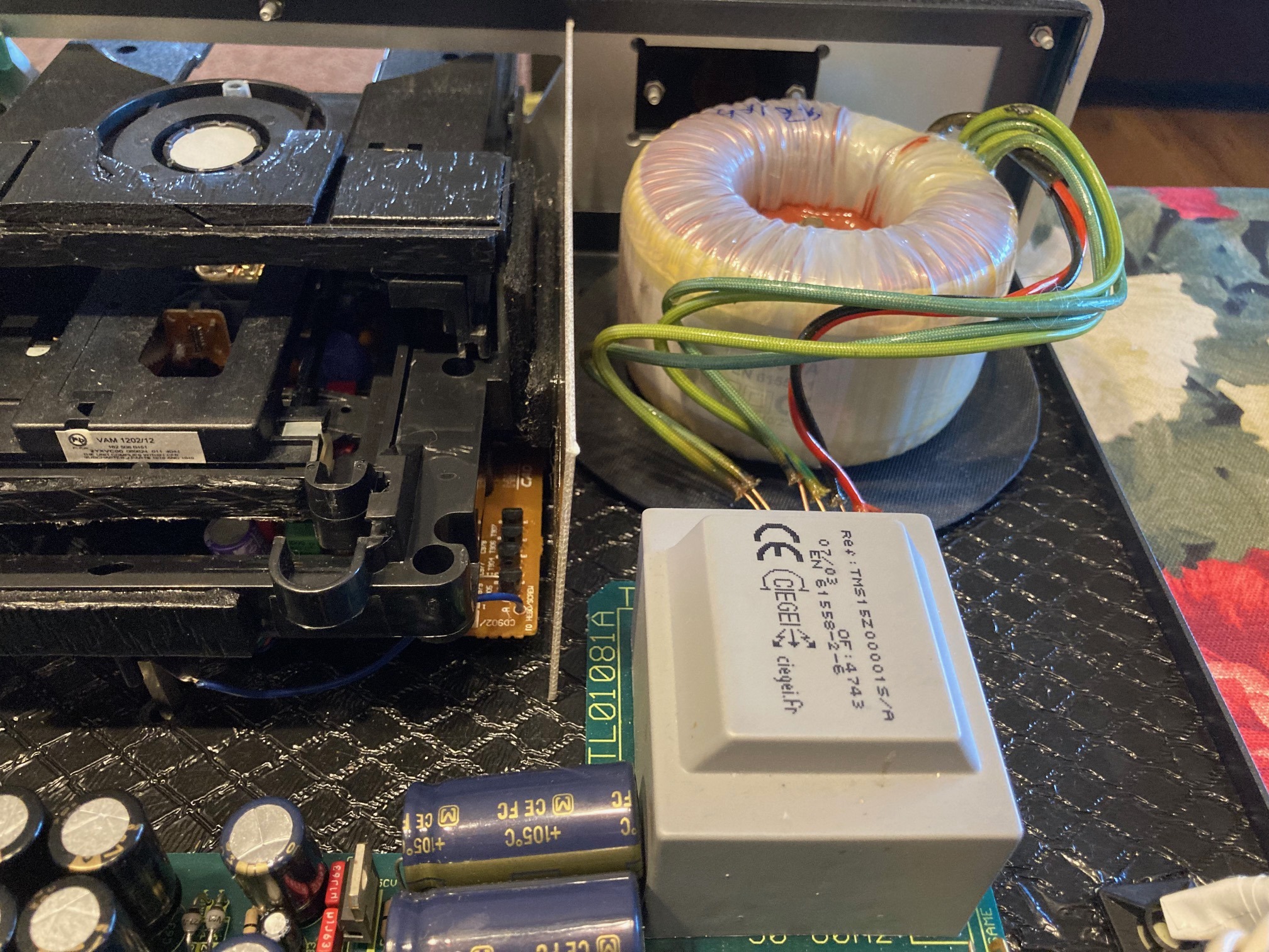

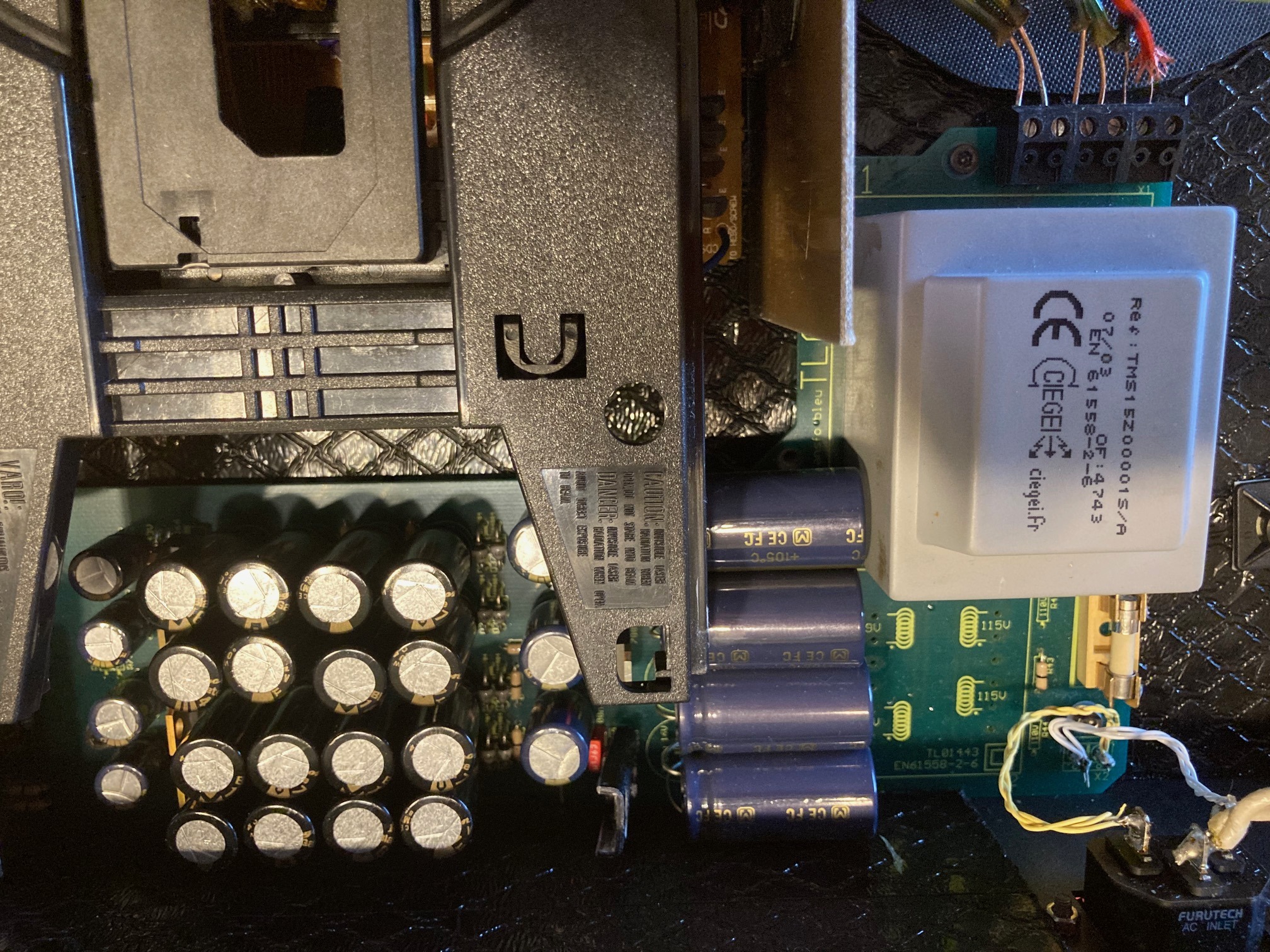

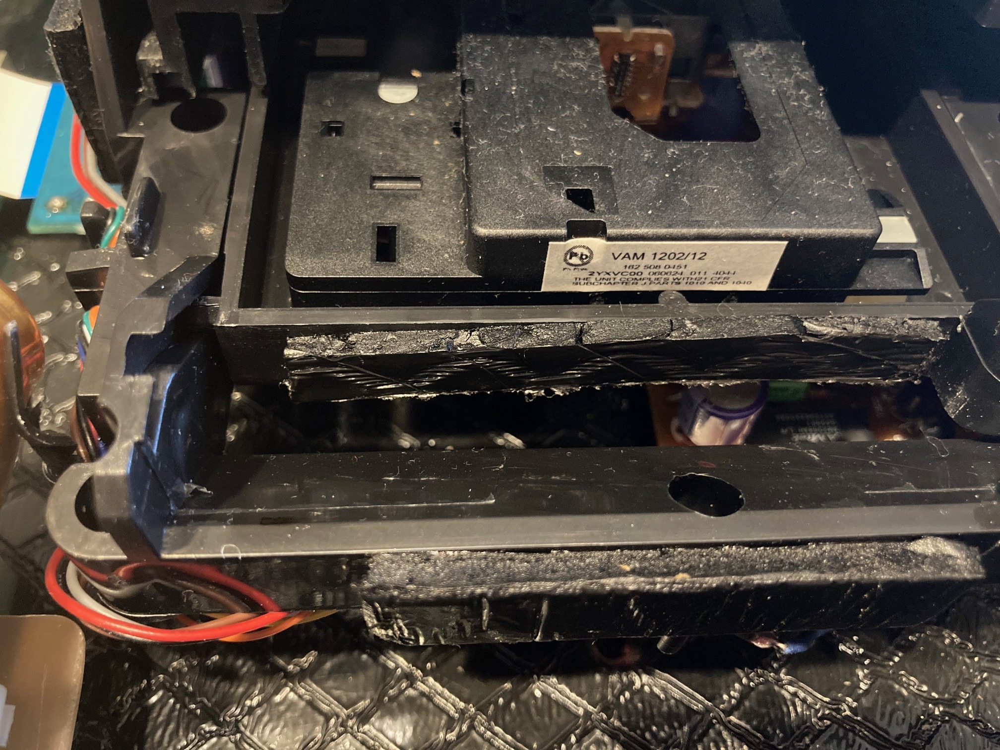

Good morning! Here I upload some pictures. If something more detailed is needed please tell me and I will do.
There is a PCB board under the CD tray but it is not possible to make pictures. It has to be removed the CD tray.

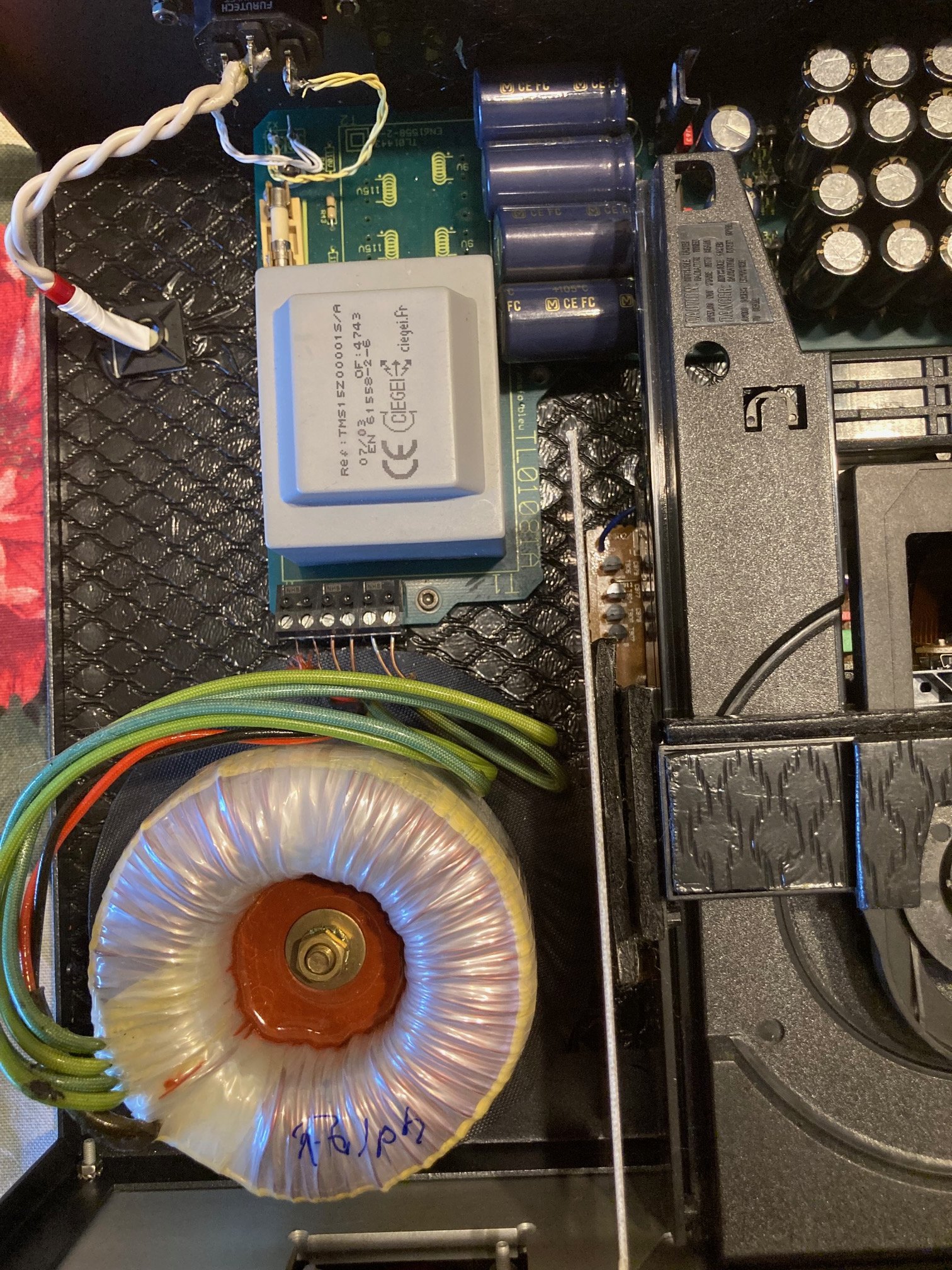

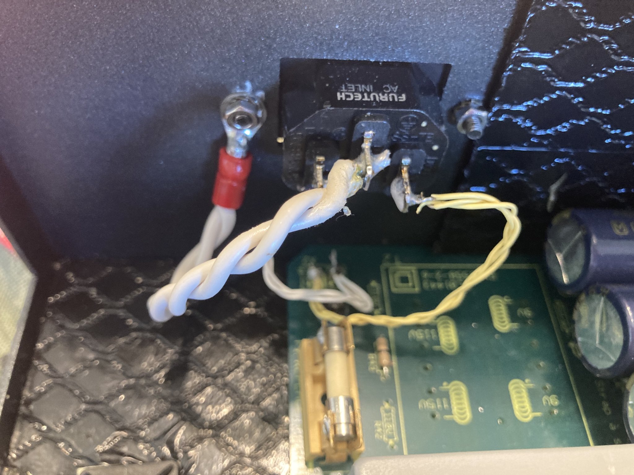

That is not a job well done electrically. First you will need solve the ridiculous mains connections and use crimp faston connectors, the right size wires in the right colors and a sturdy connector on the PCB. Try to find out what they have done with PE as there are 2 intertwined wires with the wrong colors going somewhere. Normally the casing/chassis is connected to PE. Then you will need to resolder or crimp connections and solder electrolytic caps as they should be so directly to the PCB. The transformers connections are done badly and need to be redone with no bare copper visible.
If things are done like here then transport/shipping of such a device is a serious risk. Dangling boutique caps and excess wiring may come loose or have bad contact. Especially the situation at the outputs with the large Jensen caps and the blue caps is asking for trouble. If you have a schematic please check what their purpose is. If they are output caps one might not even need them.
Possibly solving matters is a risk too as PCB tracks have endured mechanical stress and have been soldered a few times already, they may come loose etc. If devices need a special disassembly sequence because of the extreme changes I refuse such repairs. It is better done by the craftsman that did the changes.
Good morning Jean- Paul!
Thank you for your reply!
1. I checked the intertwined wires from the ground pin of the main socket- it goes nowhere. It is insulated and not connected to any point.
2. Unfortunately I can not find any schematic of ATOL CD200. What I found out is:

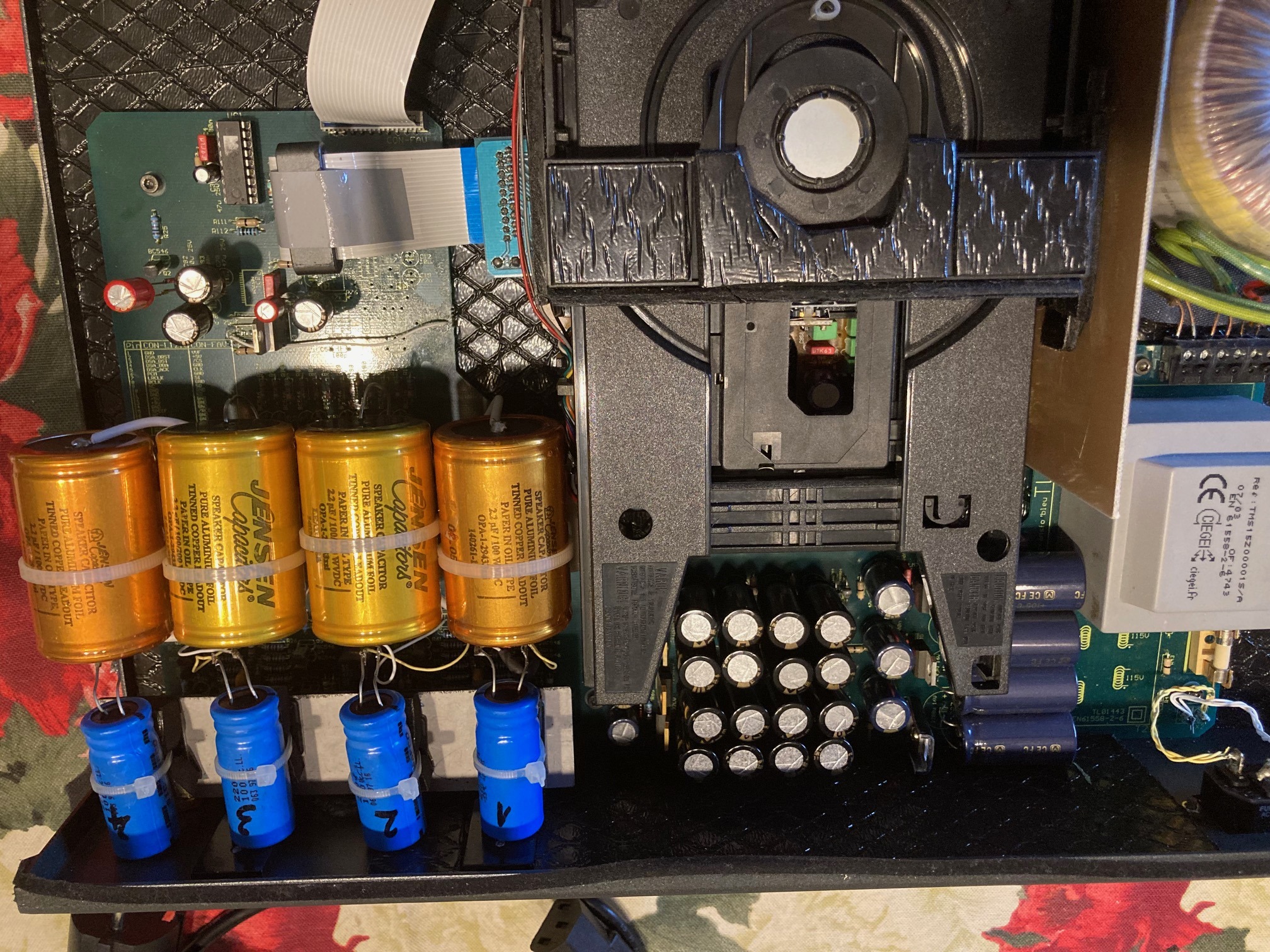

When I touch the wires of big yellow Jensen capacitors with a finger a noise appears ,and according their position on the PCB they are probably input capacitors of the output analog part.
On the blue capacitors I measured : N1 = +46 V, N2= -46 V, N3= +46 V, N4 = -46 V. I have no idea what might be their purpose.
The blue capacitor seems to be possible to be soldered directly on the board, but the big yellow Jensen I do not see options.

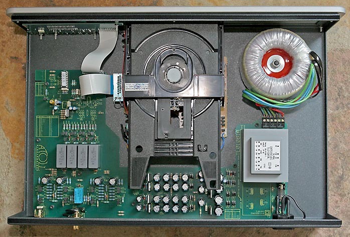

I found in internet a picture of the original ATOLL CD 200. I send it as an attachment.
What can be seen is that Jensen capacitors are on the place of smaller grey capacitors. The blue capacitors replace much smaller other capacitors.
I think all capacitors in the power supply part are replaced as well.

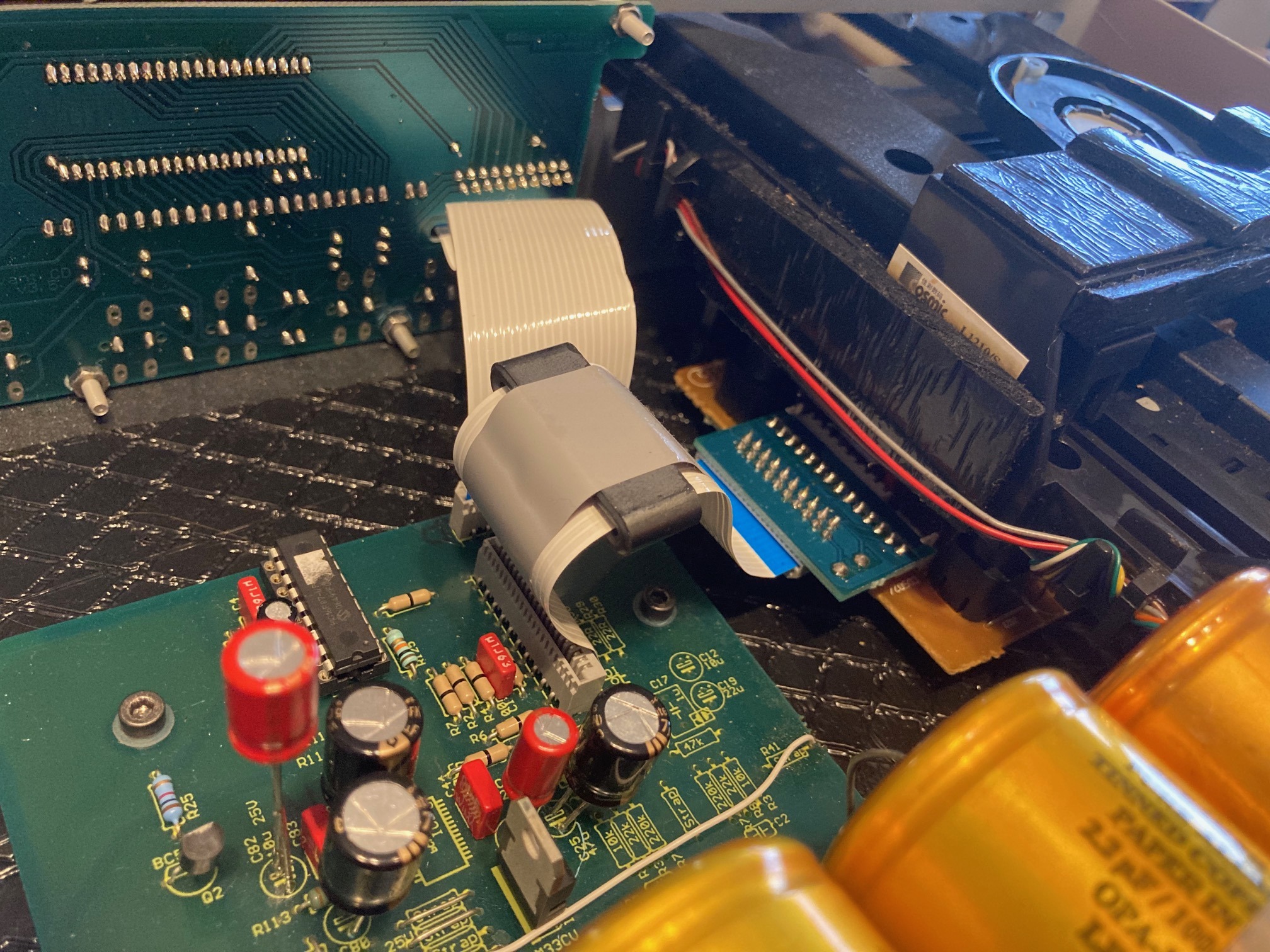

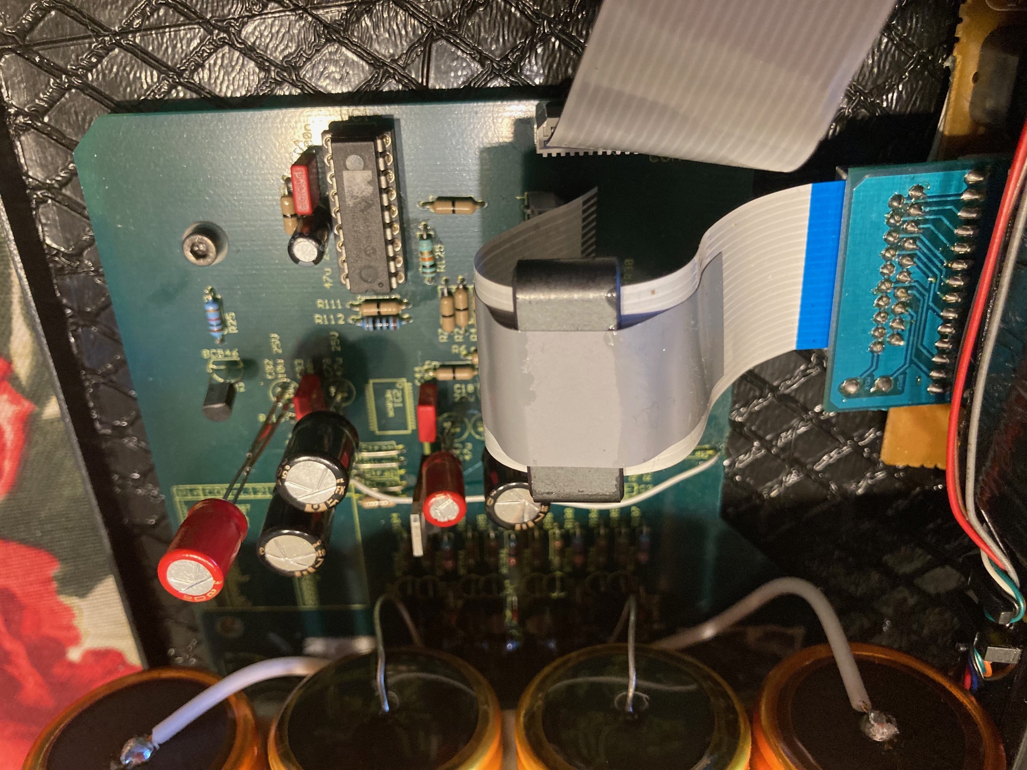

3. I see some changes done around PIC 16F87-I/P. - the red capacitors with long legs. I do not know how that can improve the sound because PIC 16F87-I/P is the controller but may be I am wrong and this capacitors are part of something else.
4. I tried to remove CD tray but I could not. I do not know how. On the front of the tray there is an aluminum panel glued very hard which does not allow to take away the whole tray. May be there is other option to be removed ? The CD mechanism is Philips.
Under the CD tray there is an other PCB.
This is all for now what I found out.

If the PE wire is there but hanging in the air then one knows someone incompetent worked on it.
Unless you are capable yourself this will likely cost a lot of time and effort.

For now if you can just to tell me what to do with the hanging ground wire:
Should I connect it to the metal box of the player or somewhere else ?

it's more than likely !If the PE wire is there but hanging in the air then one knows someone incompetent worked on it.

Look at C82 🙄
Hi , about C82 I was told that the long legs are left to be easy to manually select the best capacitor in that position. I do not have any idea what C82 does , I can not find any electronic schematic of the Atoll CD200. May be somebody from France could help?
I connected the PE wire to where it should be according the picture of the original CD 200. The noise lower the level just a little bit but it is still there.
