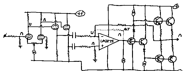

Here's my synthesis of many of the proposed GC mods including a discrete class A o/p buffer (similar to Andrea Ciuffoli's), Steve's tie-down CCS for the LM3875, differentially-driven inverting 'clone, tube buffering and a bit of tube gain...
I think I'll call it the superduperultradeluxebanzaichocdipclone...
Some aspects might need a bit more detailed attention but it should work in principle... move over Krell, you overpriced grunge-mongers!

Wow, what an overkill. I'd rather go the parallel/bridge way if i wanted more power, but maybe the output's not too bad. What really annoys is the input. How much gain can the LTP provide? As you actually don't need any in this position. An LTP set to unity? And then let's burn some more in the followers! And what are the followers for? To really screw up the sound? If the volume control was incorporated in the input section it would still make some sense...
But then it wouldn't be class A, now would it... Which is the whole point of my recent posts, and Steve's. Check back...
It annoys? Does this have anything to do with those pesky, enigmatic "microdynamics"...
How long is a piece of string... depends on what tubes you use, the load resistors and how much cathode degeneration (ie size of balance pot). Around 4-5 I'd guess with an ECC82, reduced by around 10% through the followers.
Er, yes... it does work you know... But some gain is useful here, relax!. Point of LTP here is to differentially drive the LM.
What are followers ever for? Reduce Zout naturally, because input resistances are likely to be on the low side in this LM configuration I've used, and driving them directly from the anodes is probably not the best idea. And if you use too large R values to up Zin without followers, you could run into some trouble at higher frequencies.
