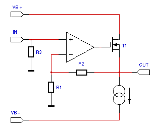

Pjotr said:Buffering an LM3875 to make it a single ended class-A sounds interesting. But you need a power mosfet for it as a source follower. A BJT will draw too much base current to keep the LM itself in class-A.
If you're referring to what I'd mentioned previously, I wasn't talking about using a source/emitter follower. I was talking about using a current source tied to the 3875's output. Base current is irrelevant.
Biasing the LM by drawing a large offset current from it is impossible for reasonable output. For sure you get problems with the protection circuit.
The datasheet says its internally current limited at 4 amps. 20 volts into an 8 ohm load will give you 25 watts and requires just 2.5 amps.
So I guess it depends what one defines as "reasonable output."

I don't think Pjotr is thinking of a tie-down source, Steve. But looking at this scenario of yours:
For 25W/8R, 2.5App is correct, meaning your Iq source would need to be 1.25A and your speakers very forgiving. To maintain 25W/4R your source would need to sink 1.75A however. And for a perfect voltage amplifier you would need Iq=2.5A to guarantee 50W into 4R, thereby catering for most real-world speaker impedance curve variations.
Working from a 30v +ve supply your LM chip's upper half would dissipate 38, 53 or 75 Watts of heat continuously, requiring 2°C/W, 1.2°C/W or 0.46°C/W heatsinking (NS calculations on data sheet) - on the assumption that Ta is no more than 25°C and ignoring entirely the identical dissipation and similar heat-sinking requirements of your proposed current source!
Now you're approaching Nelson Pass-style heat sink acreage, not to mention that all of these proposed SE-chip dreams fall way beyond the SOAR curves on page 6 of the LM3875 data sheet. It looks like your chip should last... oh, around 10-100 milliseconds (joke). Point is you're gonna toast the little bugger. Luckily they're free, I hear...
So, why not keep everyone happy by (a) keeping the 3875 in-circuit (shriek!) and (b) whacking on a NFB-less class A source-follower... it's the path of least (thermal) resistance...hehehehe

I'm not sure what he was thinking. Which is why I prefaced my reply with "If you're refering to..."
Since it's single-ended, Iq would need to be 2.5 amps. And it just occurred to me that you'd have to drop it down to 2 amps because otherwise the top output device would need to go to a maximum of 5 amps which is more than the 4 amp internal current limit.
So instead of 25 watts, you're looking at 16 watts into 8 ohms. Still a viable amount of power for many. Not everyone owns power sponge 80-85dB loudspeakers.
And why would you need to guarantee twice the power into a 4 ohm load? We're not talking about a utilitarian Swiss Army knife here.
I was thinking a +/-20 volt supply so we're looking at a continuous dissipation more like 40 watts.
A 20 volt CE voltage and a 2 amp collector current looks doable to me.
Why would that necessarily keep everyone happy? The 3875 would still be operating in class AB. Also a source follower (or emitter follower or cathode follower) employs what amounts to 100% NFB so you're not escaping negtaive feedback with a follower. Though you could keep it out of the global loop.

Within the audio band, a MOSFET follower pair would draw less bias current than the LM3875's internal Iq... which leaves it in class A bias. Go crunch the numbers... And yes, I'm fully aware of the operational structure and inherent 100% (current) FB of any single-device follower. Which is irrelevant to the point being made. The point was to get realistic, symmetric class A output from an LM3875 chip without resorting to a tie-down and without lengthening the NFB path. Perhaps you can suggest a better option, Steve...
To me, the biggest appeal of the GC concept is possibility of creating interesting "structures" which are possible only when you deal with few parts, single chip and 2 PS caps. This allows for building "unique" designs (and really compact), which are not easy to attain with more conventional approaches. I'm not mentioning the quality of sound, but if it wasn't "that" good, whould I go through all that trouble and wasted my time?
If these are your reasons Peter, then excluding the "compactness" motive you probably are indeed wasting your time. What part of working with these chips offers scope for 'interesting' or 'unique' 'structures'...??? GC lore (ex buffers, reg PSU's etc) leaves you with inverting or non-inverting op-amp connections and all the minimal necessary caps. That's it! Nothing new there... hasn't been for 30 years in fact. And every GC mod was invented or applied in the discrete realm first.
Now tell me "cheap, easy, compact and I like the sound" and that's fine, I'll believe you but until you've discovered the hundreds of additional mods/upgrades/whatever possible in discrete design you won't realize the limitations of working with chips. Every chip mod can be implemented in some way to a discrete amp, but not even 10% (guess) of possible discrete mods could be done with chips.
DrG said:Within the audio band, a MOSFET follower pair would draw less bias current than the LM3875's internal Iq... which leaves it in class A bias. Go crunch the numbers...
True enough. I didn't stop to think it'd be driving a much higher impedance.
But it's still complimentary and my point was that you could turn the 3875's class AB, complimentary output stage into a single-ended class A output stage.
That's fine. It's yet another option for people to choose from, which was all that I was offering. Which is why I was wondering why you were insisting that it must be able to double power into 4 ohms and why you think this approach would keep everyone happy as if everyone prefers the same things?

The remarks concerning “short wiring” your GC here is looking in the wrong direction IMHO. It has not much to do with “delays” and HF stability in the over 100 MHz region. Anyone who has build a discrete amp knows, or should know, that board layout is very important for good results. This applies especially traces and/or wires that carry large current. What plays havoc here is inductive coupling between traces or wires and error voltages generated by ground return currents. Keeping the wires short minimises coupling between wires and minimises error voltages.
To avoid confusion about a SEC in my previous post. I was intending a set up like the attached schematic. Thus including the buffer fet into the FB loop. I see no good reason to fry the LM chip itself. But going into that direction the good old LM391 is probably a better solution for the op amp. It has at least more freedom to stabilise the circuit. Unfortunately it is obsolete now.
Cheers
Cheers
