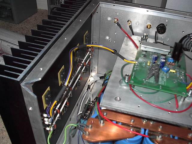

Brian,
I like the P2P on your power transistors. Would you be so kind as to post a photo of the heat sink with the P2P wiring?

yes, a photo from you P2P output stage would be nice.

This is the best I could find on my office hard drive. Interesting how far digital camera have come in 10 years.

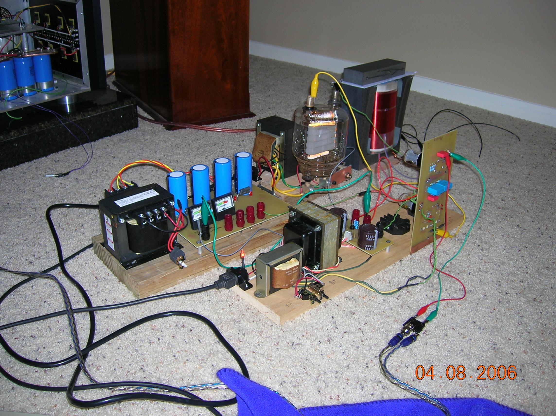

The last one, you can sort of see the amp in the corner. I was running my 833 amp with my home made OPT.

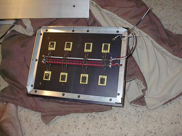

There are 6 turret terminals, 3 at each end to support the bus wires. Then 2 resistors and a jumper connecting each fet to the bus.
Since the middle pic, I did anodize the top panel and have it loosely installed.
