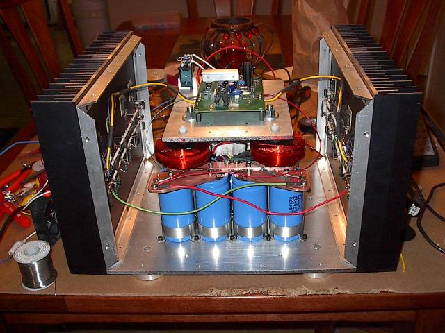

Brian, Great looking work! I'm a little confused about your power supply configuration, would you be able to describe it in a little more detail for me?
It looks like you are building a stereo Aleph 2 using a single transformer (with a single secondary) feeding your two large caps, and then tap individual + and - rails for each channel (the four smaller caps) from the two large caps. This would mean that the toroid and two large caps are shared by both channels. Is this correct?

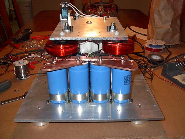

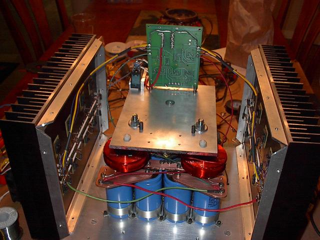

Actually this is only one channel. I added 2 extra output fets to each rail and decreased source resistor to .89ohm to raise bias.
The toriod feeds fred diodes to 2 huge caps (68000uf100v) to 6mh air inductors to 2 pairs of 17000uf75v caps. Sims showed .05v ripple(if I remember right) at 5A load.
I haven't got it all back together, but I'm expecting 50v at 5A bias.
I'm going to include a pot and bias meter so I can turn it down for non-critical listening. I'm also including a temp meter and output meter and variable speed fan so I can keep an eye on everything and try to not burn down the house.
Before I tore back in to it, I was running both channels from a 22A variac at around 180v in to get 50V rails and it sounded great. But it ran at 170 deg without the fan. I'm hoping the fan can keep it down around 155 without making niose. I wish I had 20 hours to finish tham instead of only sneaking a few minutes here and there to talk and dream.

I'm putting one meter across a source fet. My source fets are less than one ohm, and the meter impedance is around 50Kohm, so I don't see how it could be audible. The second will be hooked up through a NTC varistor / voltage divider to be a sink temp gauge. The third will be hooked to the output through a resistor, small signal bridge rectifier, and cap to be show output. No scales or gradients, just ballpark indicators. Bias indicator will be 3/4 scale = 5A total bias, Temp indicator will be 170 degF will be 3/4 scale. I may put in a switch for dual sensitivities for the output.

The buss bars are made out of 3/16" x 2" copper bars I found on ebay. I'm a little worried that my coils may go up in flames. They'll be dissapating 20 watts+ each and I'm not sure how hot that'll make 'em. If they smoke, I'll just replace with a larger one. I potted the inside with polyurethane, nylon bolt, and a cpu type heat sink. (I may have ****ed away $50.00 and 2 hours. we'll see)
