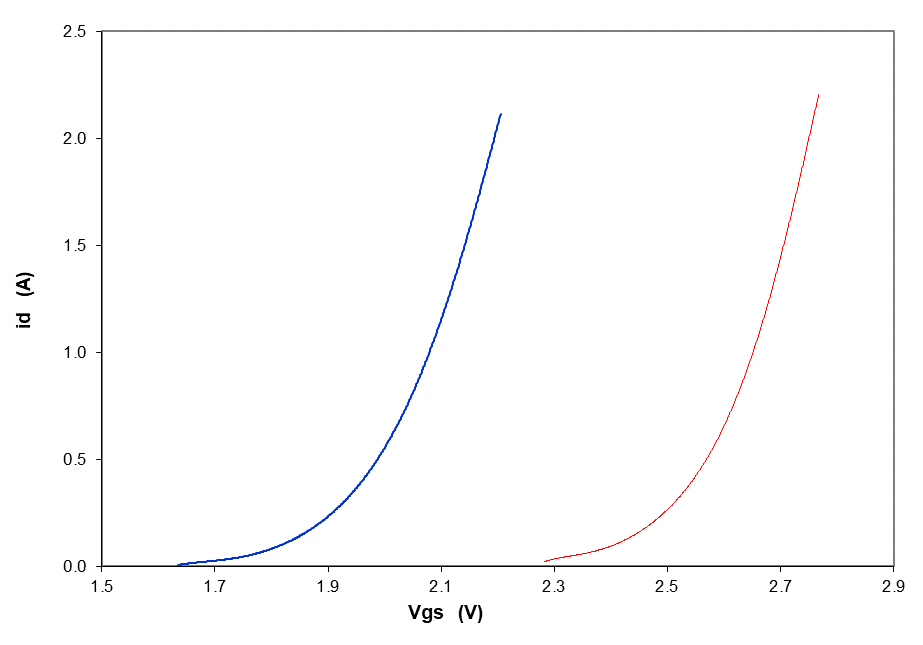

2SK2955 / 2SJ554 Curve Tracing
I finally found some time to measure my 20 pairs of 2SK2955 / 2SJ554 bought from Japan some 10 years ago.
As you can see they are not truely complementary.
The NMOS (in red) has higher Vgs but somewhat lower Yfs (at 1.2A).
But they more or less compensate with each other if you make allowance for that in circuit design.
Extremely thermal sensitive, just like 2SK3497 / 2SJ618 so some bias control is a must.
Transconductance at 1.2A is > 10S, almost double that of the Semisouths.
If you can tame them thermally, they will drive anything.
Patrick

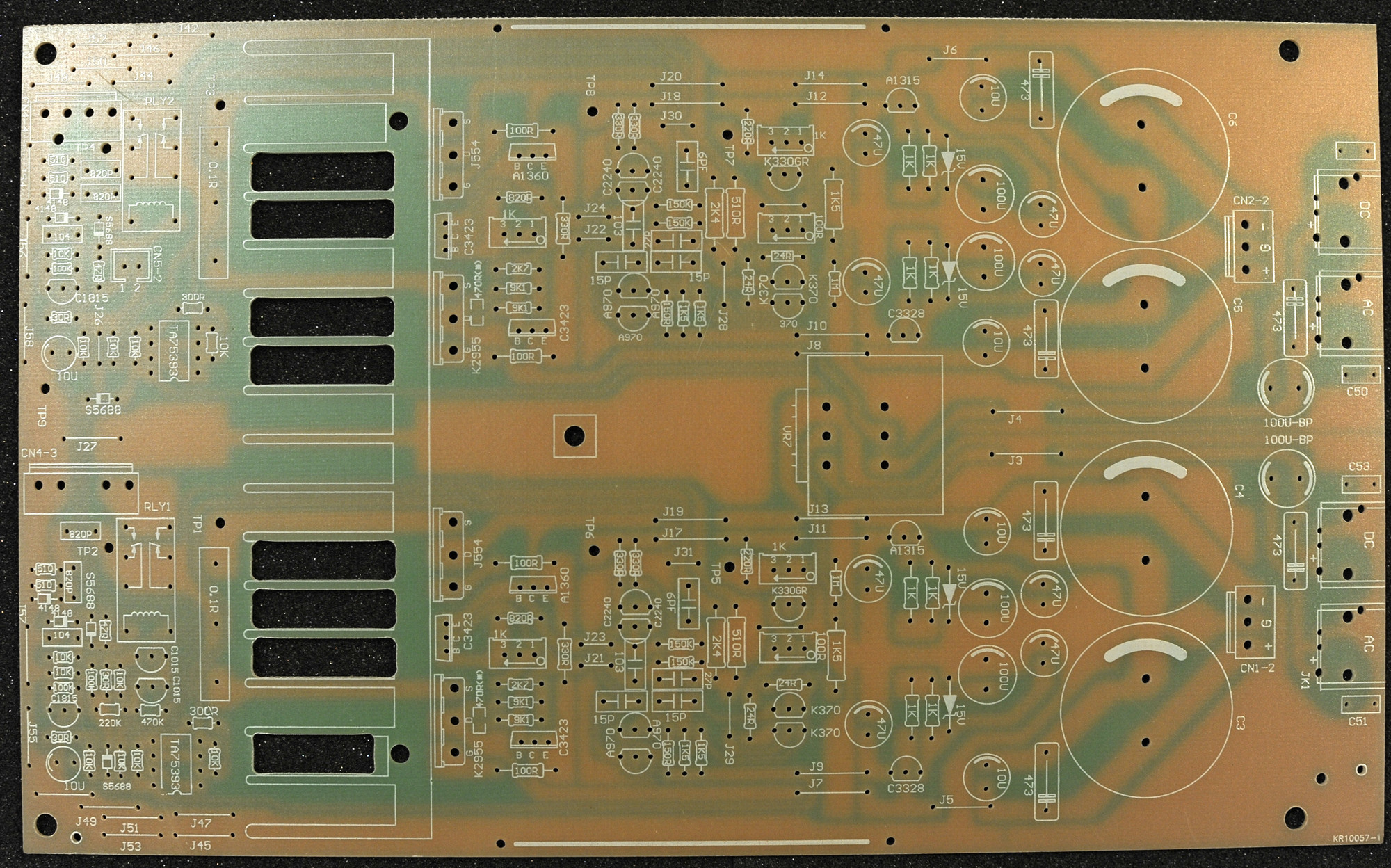

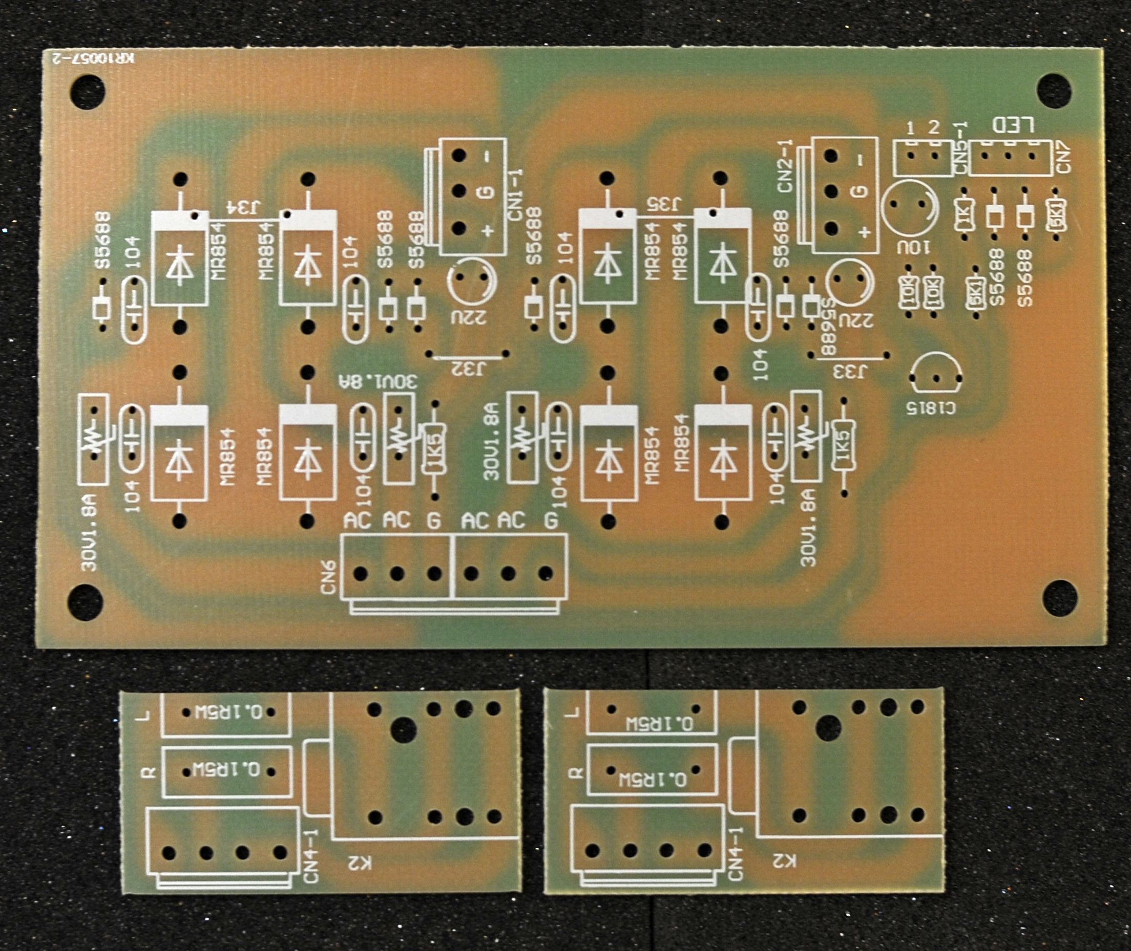

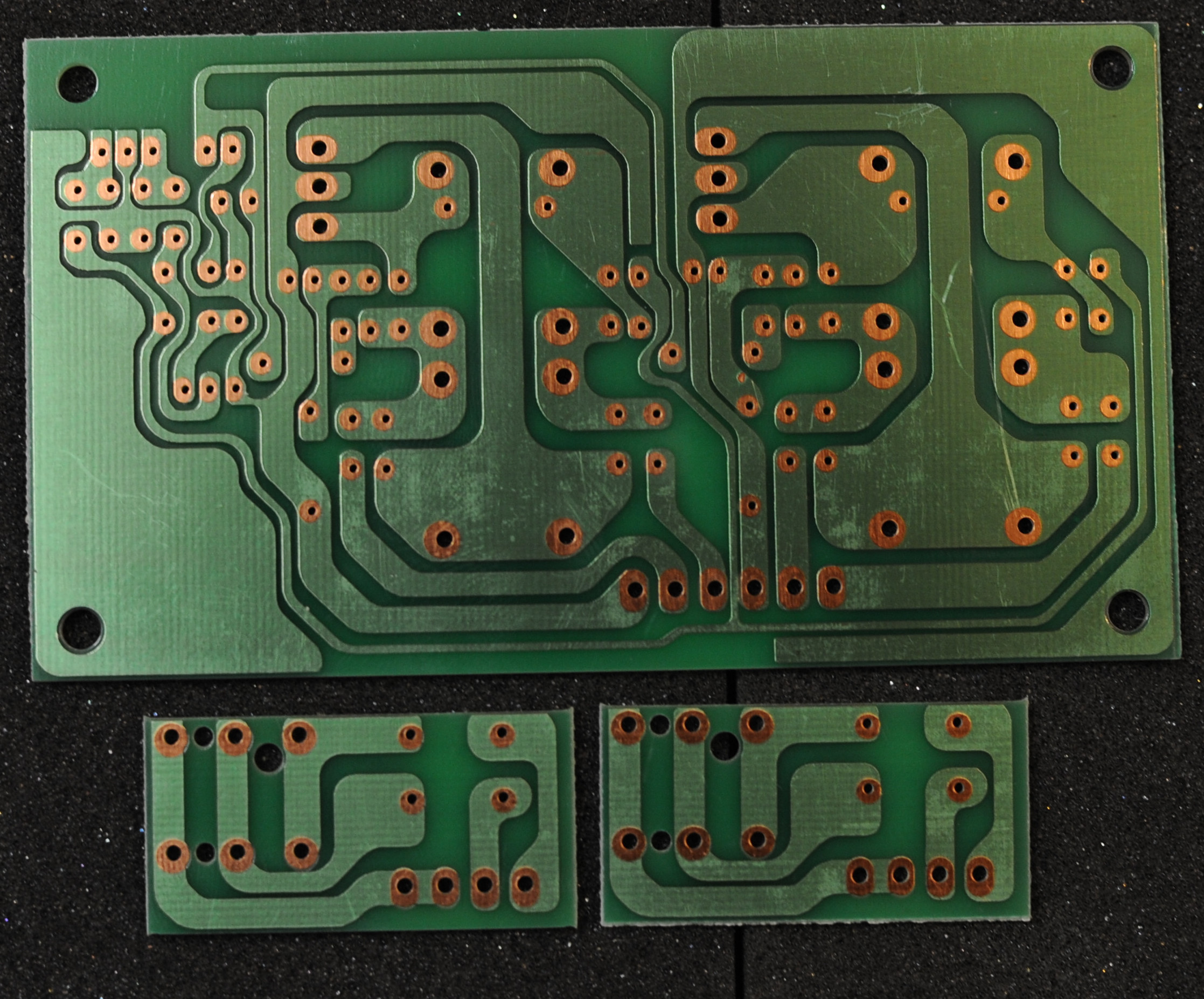

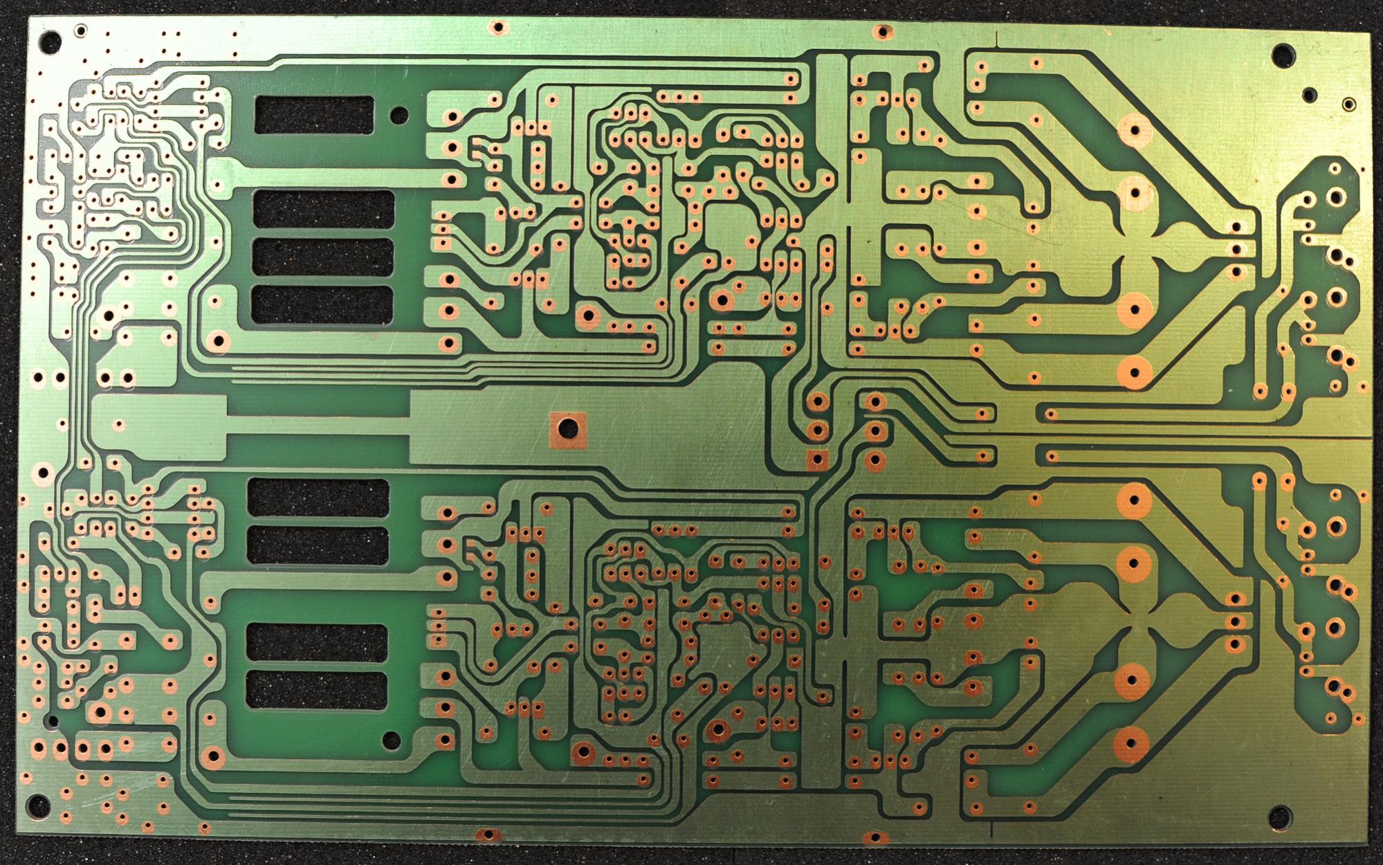

I've found on my desktop some old photos of unpopulated chinese ha5000 clone boards. (Half-populated now, waiting in the cardboard anyway)
Maybe it can be helpful for someone.

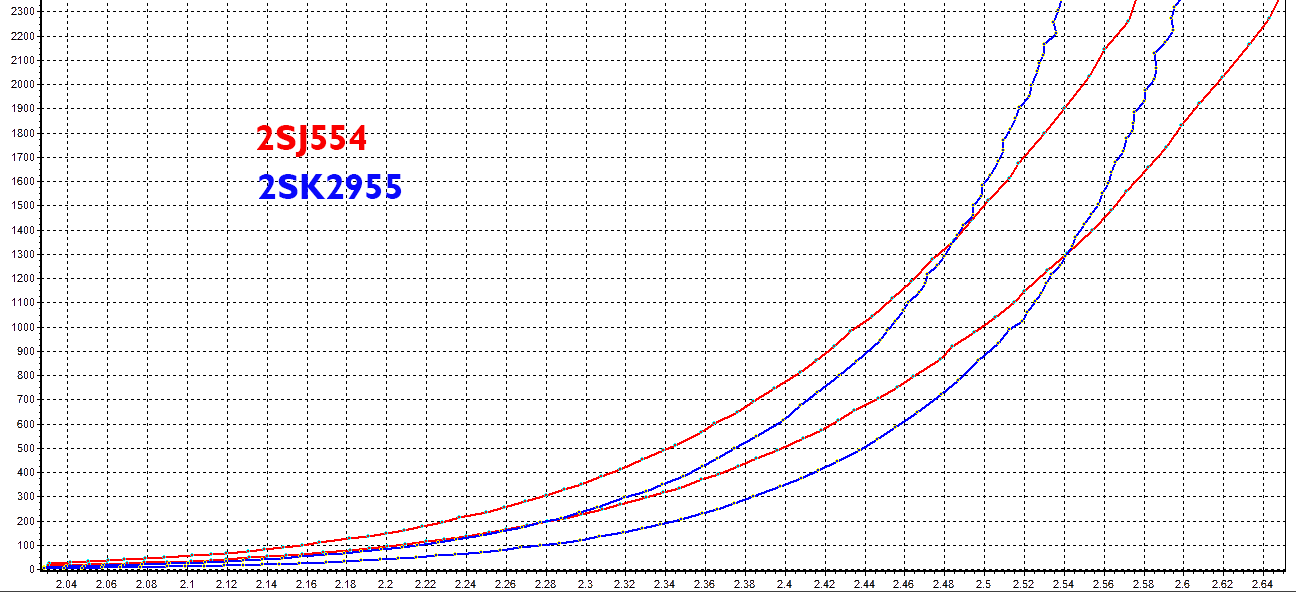

A few years ago I bought 60-80pcs of used (desoldered) 2SJ554 and 2SK2955 from China, I can't be 100% sure that they are genuine Renesas / Hitachi, but usually fakes aren't sold used...
From this batch I chose these pairs, the N-channel has jigher gain and tendency to higher Vgs, both have 3150 pF input capacitance.
