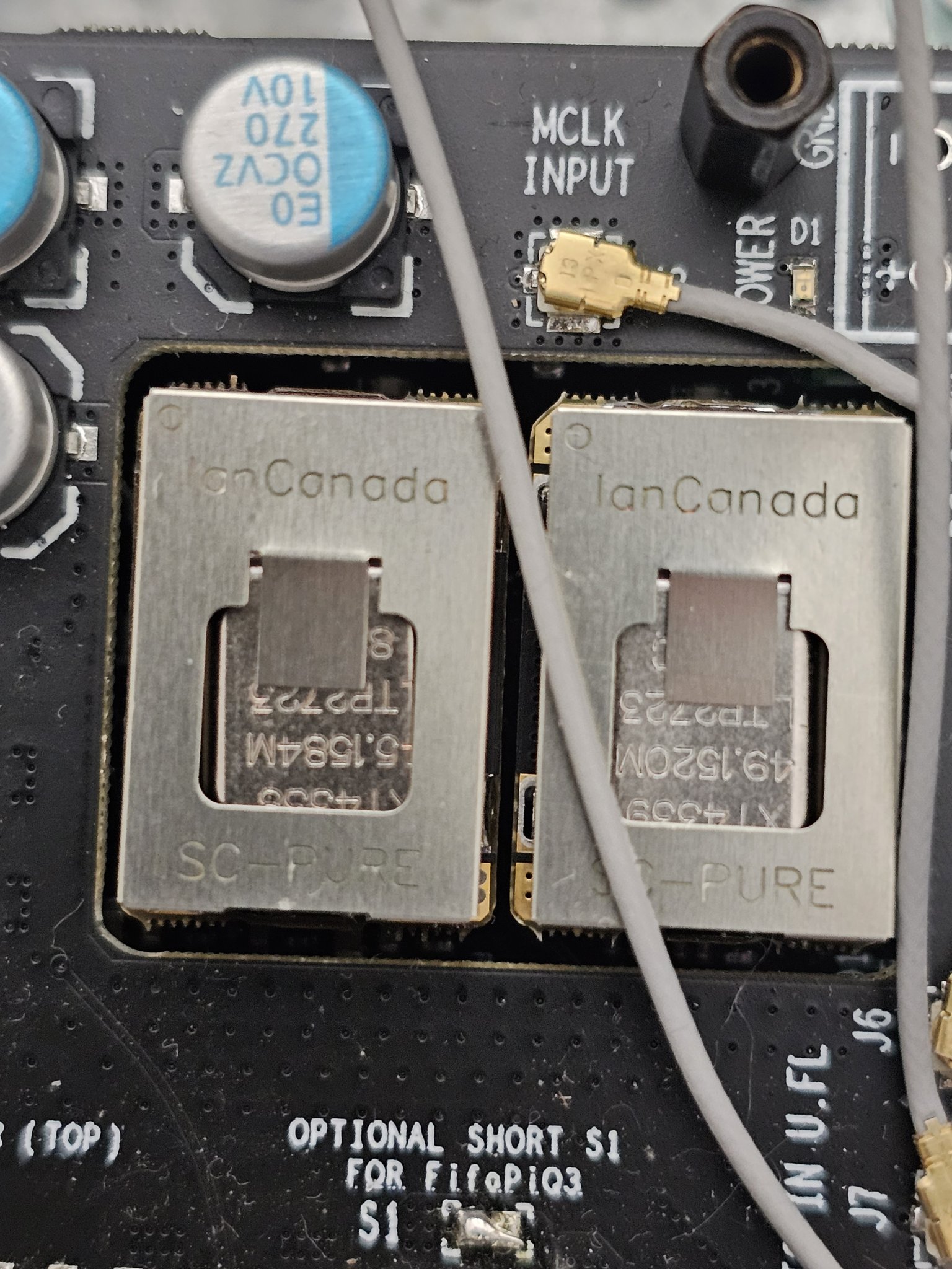

For a couple of days I have the SC-pure clocks. Together with all kind of Ian's beautiful stuff they the are helping to get data into a TDA1541A S1 🙂
Compared to the standard clocks the difference is more then significant. It only took some seconds to discover that.
In my system with 300B tubes, sound is a little more upfront and everything is more precise. Details are discovered more easy compared with the standard clocks. I like that.
At the moment they sound a bit hard especially when listening to Shostakovitch symphonies 5 or 8.
Hopefully that will be less in time.
Nice job Ian!!
