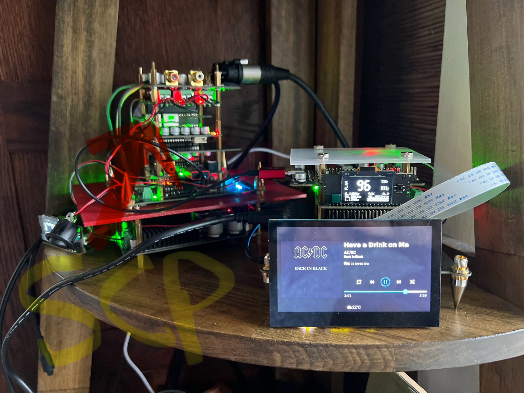

I’m getting questions on my setup. See picture. I built a streamer and a DAC connected by i2S.
I have default clocks on the FiFoPiQ7 on the streamer and I have SC-Pure installed to the DAC FiFoPiQ7 right under the DAC board (removed clock) and the OPA861 (an excellent output board OMG)
It sounds crazy good. Letting the SC-Pures burn in another several days. It’s only been 3.

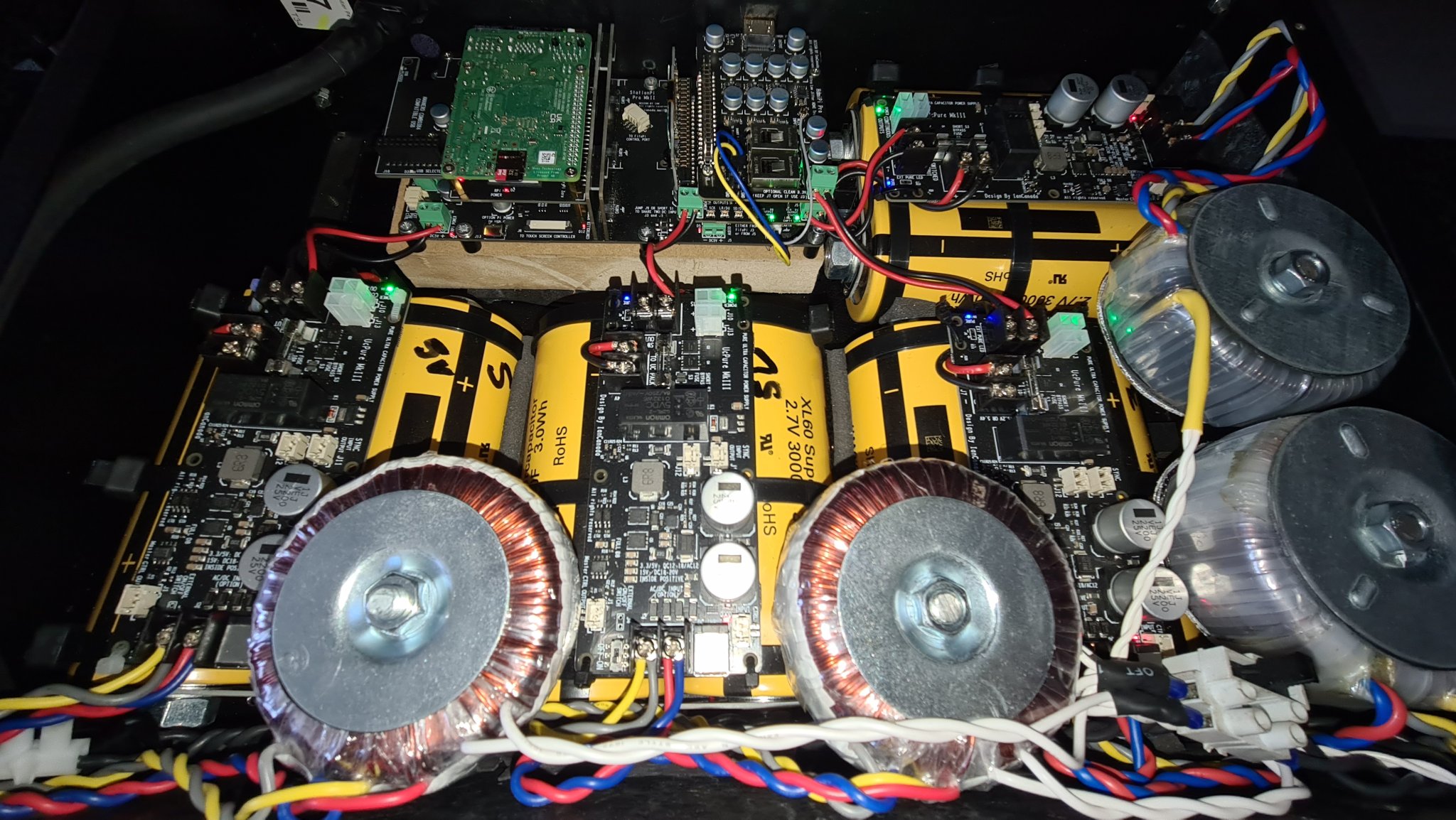

I don't have a screen I only use the 5v supercapacitor for the rpi, I also use a separate supercapacitor 5v for the fifopi q7 and a separate 3.3v supercapacitor for the clock.
Rudy

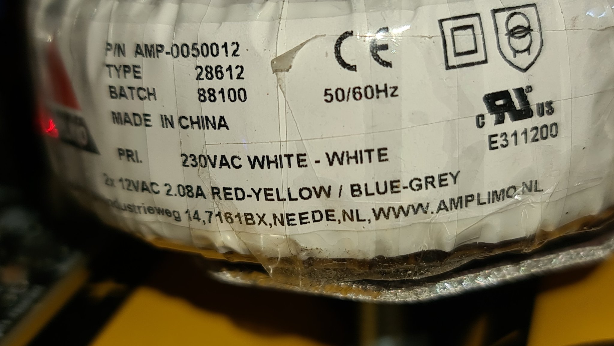

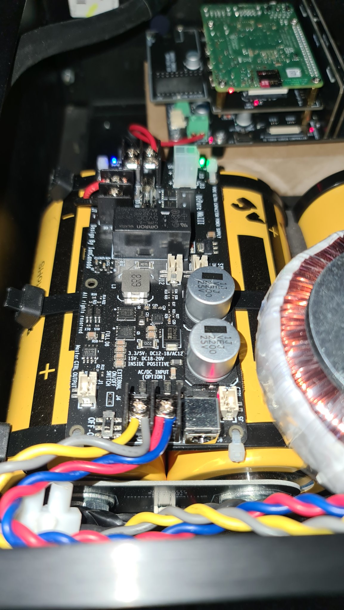

Hi, if you use supercapacitors to feed the pi the current is too high. With Raspberry pi 4 there is a very short time in clean mode.
I think your toroid for charging have not enough amperage. Look rather small on your pictures,so that`s why you have voltage drop.Ian recommend 3,5 A or bigger,and in same time you have a Raspberry pi 4 with high current draw.Pure mode is not going to happen or very short time.You can try change jumper S5 to open mode for power supplys delivers 1,5A ,perhaps it helps.Hi all,
Please measure the 5v voltage drop from the supercapacitor when playing and when it goes up again.
I measure 4.39 volt drop then it goes up again.
I am curious how your measurements are.
I measure the 5 volt to the raspberry pi because this one uses the most power.
Later this week I will measure the 5 voltage drop from the supercapacitor to the fifopi q7.
Rudy
If separate windings you can put them in pararell mode for double amperage,but be careful .You have to connect phase to phase and zero to zero secondary windings.Or one winding secondary jumper S5 in open mode on Ucpure for 1,5A.If you look specification,the wires with a black dot is phase.I personally should choose a high quality linaer powersupply or batteries together with Ucmateconditioner 5V,because of high current.I think your toroid for charging have not enough amperage. Look rather small on your pictures,so that`s why you have voltage drop.Ian recommend 3,5 A or bigger,and in same time you have a Raspberry pi 4 with high current draw.Pure mode is not going to happen or very short time.You can try change jumper S5 to open mode for power supplys delivers 1,5A ,perhaps it helps.
Ok, now i see.Try to put S5 to open mode and see what happends.If separate windings you can put them in pararell mode for double amperage,but be careful .You have to connect phase to phase and zero to zero secondary windings.Or one winding secondary jumper S5 in open mode on Ucpure for 1,5A.If you look specification,the wires with a black dot is phase.I personally should choose a high quality linaer powersupply or batteries together with Ucmateconditioner 5V,because of high current.
