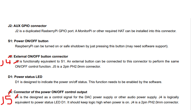

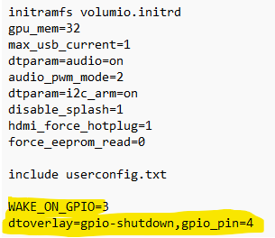

Hello, still are not able to swith the RPI4 ON after a safe shutdown using a shieldpi pro. Both with the button S1, nor with the connector J5 ment to connect to a push button.
Safe shutdown is working.
Start up after safe shutdown is the problem.
I added both commands in the config file.
They are in line with the info from the shieldpi pro manual.
Is there anybody where this is functioning? If yes, possible to share the config.txt file?
Issues are solved:
1: updated my RPI 4 with latest EEPROM version. I followed steps explained here: https://dreamonward.com/2019/11/20/on-off-button/
2: The J4 and J5 are not correct labeled, both on PCB as manual. I figured this out when measuring through the shieldpi pro PCB.
I can't believe that nobody had seen or mentioned the issues numer 2 from above ???

Thank you, I'm currently on it👍Issues are solved:
I will update the EEPROM.
He must not have much who uses this function with the Shieldpi pro
@ BensenHello, still are not able to swith the RPI4 ON after a safe shutdown using a shieldpi pro. Both with the button S1, nor with the connector J5 ment to connect to a push button.
I have no any problem with ShieldPi Pro and the MkII. Please just follow the user's manual. It's very easy.
https://github.com/iancanada/DocumentDownload/blob/master/Adapters/ShieldPiPro/ShieldPiProManual.pdf
BTW, safe start up is the Linux feature which has no business with any software. But have the use the most updated RPi hardware.
Again, just follow the user's manual.
