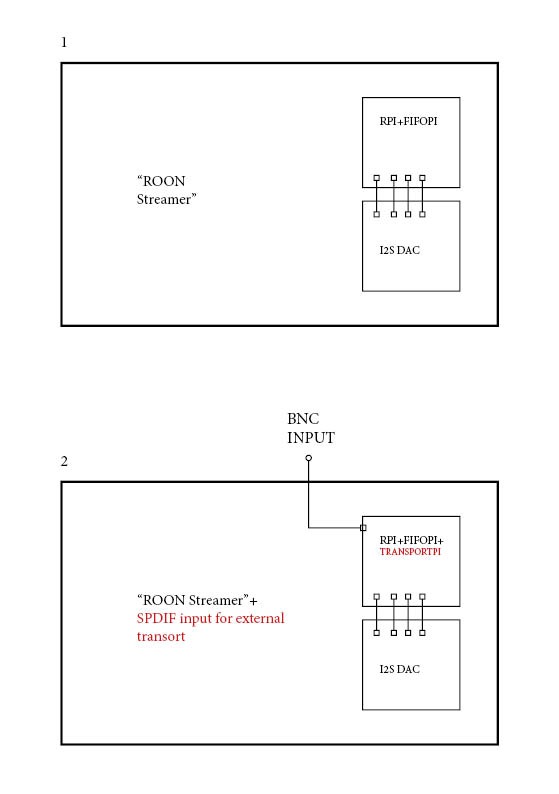

Thans Ian for the fast reply. But that's not 100% what i mean, almost...
The dac/streamer is my own creation. The Fifopi is connected internaly to the dac i2s.
Now i want to place a transportPi on the fifo and place a spdif to the chassis so that i can connect an external transport to my "streamer".
There are no switch buttons and i rather not use one.
What wil happen when i connect the transport and the fifopi i2s is also connected? Is there a sequence the Fifopi wil select. Or is this not feasible?
Ps. looking forward to the q7. When wil it be released?
@Arnolddew
"FifoPi GPIO outputs and u.fl outputs both have independent drivers.". You don't need a switch. The I2S outputs and the spdif output from the TransportPi will work together at the same time. If it is possible, please use the u.fl coaxial cables to connect to you DAC for a better signal quality.

Oke, they work together at the same time. But who wil playback; the Fifopi u.fl i2s (streamer/Roon) or the transportpi with external transport when both "playing"?
You may want to give the ReceiverPi a try. I believe that's specifically designed to get S/PDIF (or Coaxial) signal to your DAC/Streamer. I'm personally using the StationPi Pro (SPP) that has a display and controller (ESS) that allows you to easily select the input. If you're using input from USB, then BridgePi, or the SPP daughter card would be the preferred choice - with an Amanero card. All of Ian boards provide the ability for a very integrated streamer to be built - with endless possibilities.Oke, they work together at the same time. But who wil playback; the Fifopi u.fl i2s (streamer/Roon) or the transportpi with external transport when both "playing"?
