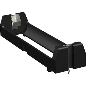

I really dislike the super random brand name 26650 battery holder, so I would move heaven and earth for the 'tab' option. The plastic melts so easily when trying to directly solder wires to the tips. It's like the most unhealthy thing to breathe, so glad to not have to re-visit. Relieved also to be removing a potential bottleneck.
I wish Keystone would make some solid 26650 holders one day, so I can implement on the MKIII. They have one for the 18650, but unknown why they don't have a 26650 available:
I'm upgrading the 5mm terminal blocks where needed with Keystone since they are beefier and handle higher guages:
The color matches my solid core silver power wiring so that's kind of kewl...

Try removing the contacts from the holder before soldering and clip back in afterwards.
Okay, thxs. I'll keep it in the back on my mind as an option when I start the MKIII project.
For the portable project where I have to solder wires directly on the tiny contact points of the holder, this would be great if I can remove the contacts from the holder. But if I re-visited, I would just use a Keystone holder going forward:
I have the Keystone holder on it's way as I need a 26650 charging solution when I start on the MKIII. I already have a spare BMS so will solder wires to Keystone battery holder to load up the 26650s before I plug into the MKIII for the first time.
For the desktop MKIII project, the soldering takes place under the board and on the soldering pot of the PCB so I'm not sure yet if removing the holder contacts is necessary. But I'm keeping it in mind and curious also on removing the contacts from the holder.
Since I feel more comfortable now leveling up from my noob stage, I think I would of preferred the tab route on the MKIII. But it's good also to play it safe at this time and just get things up and running and then optimise down the road.
I should of ordered this Keystone 26650 holder also to experiment if I can get it working with the MKIII. But my focus is solely on the portable project at this time, no attention given to MKIII unfortunately.
If I can bend down the tabs maybe it would fit the MKIII on one side. I guess can also try soldering tips to the tabs.
I'll add to Mouser project for next order.
