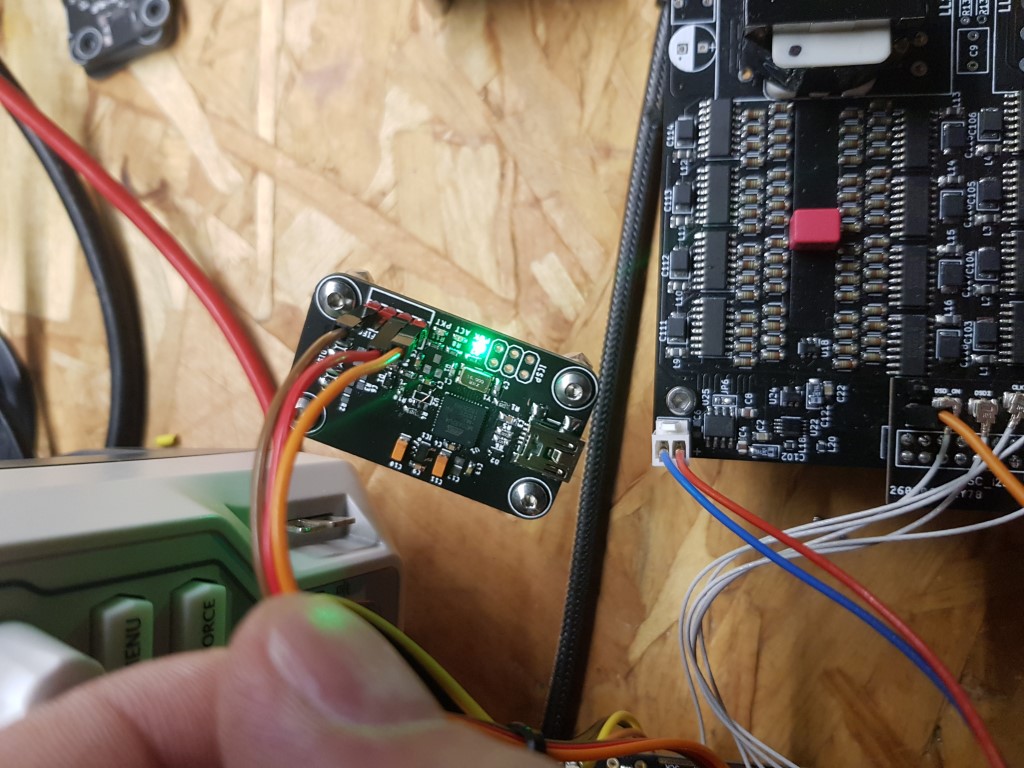

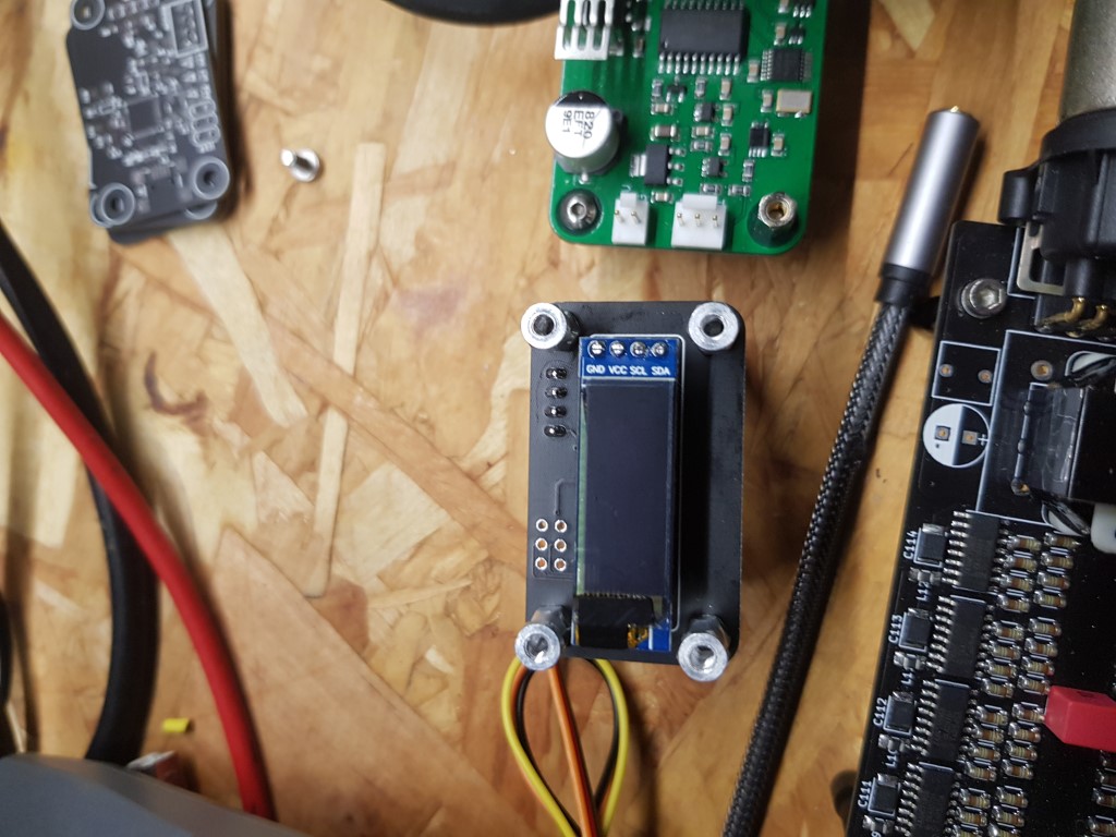

Hi !
just recently i have became a proud owner of a McFifo+DualXO (with NDK oscillators).
At the moment is feeding my DSC2.6.2...
What a Combo !
I also own a DSC2 and I surely say on my system and to my ears outperforms by a long measure the re-clocking technology used over the DSC2.
Said that, one thing that has easily proved its utility was the McFifo Display addon. I have tested it with the "classic" configuration of arduino Nano+LCD.
One thing that i have not liked of that solution (despite the very user-friendly approach) is the bulkyness and the (IMHO) not-so-great display technology.
So i have "ported" it over a much (again... IMHO) nicer package with a small OLED 128x64 (like some that is currently using ian over other products). So it became very easy-mountable on chassis and offer a better UI.
If someone is interested i have no problem sharing all the details, but, for the time sake... i will leave you with some photos and a video of the thing in action.
