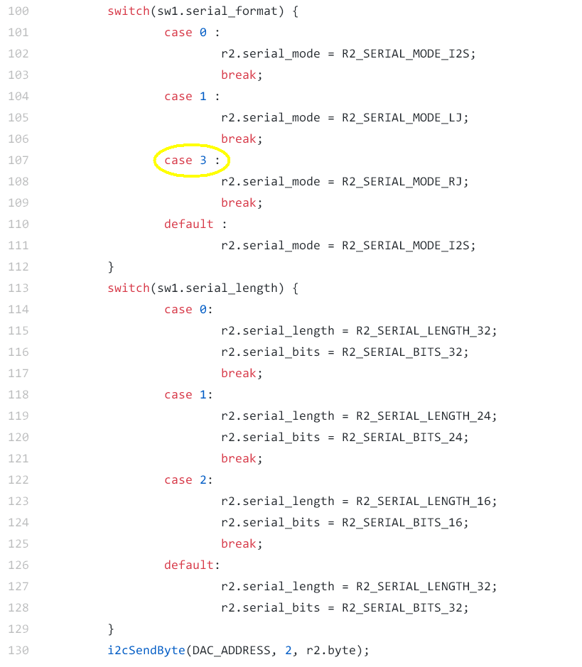

2. Firmware bug
Thanks twistedpear, they posted the source code of BIIIsePro firmware to gitHub, which is here:
GitHub - twistedpearaudio/Buffalo-III-SE-Pro-On-Board-Firmware
When I went through the code, I immediately found a bug, please see the first picture attached.
With this bug, as default, when switch1.2-3 was set at both off positions, the actual PCM format that the BIIIsePro will take would be the right justified, not the I2S it should be (according to the user’s manual). That explains why I2S inputs were always wrong.
Based on the source code, I should have solution to fix the issue
3, Solution to avoid this bug
To avoid the bug, for default, set switch1 to: off, on, on, on, on, off, off, off. While keep swhich2 to all off position.
The issue fixed! 32bit I2S music plays correctly, as well as DSD music. (For 16 bit I2S music, just needs to enable 16 to 32 bit convertor on FifoPi.)
Please see second picture for correct switch settings.

Thanks for bringing this to my attention! There is an error there to be sure - but thankfully the error simply results in case 2 and 3 (on/off, off/off) being transposed. I will correct the documentation and the code to reflect that.
The good news is that by default all of the switches are in the "on" (0) position. So the default format is actually I2S. So as long as you disable SPDIF input (switch 1 position 1 to off) you will be fine for I2S. Most of our users use the first case - which is why this scenario has not been seen by me until now. 🙂 We have lots of folks using I2S of course.
Cheers!

The part you mentioned now seems to just make the switch more compliant with the settings in the firmware. However, the problem I encountered was not that the I2S input signal could not be sent to the DAC, but the noise was generated when the 16-bit depth signal was transmitted via I2S. In other words, the bug pointed out by Ian is actually only a small part.
16/24/32bit I2S formats all play just fine if you have the switches set correctly. I have verified the same for RJ and LJ. You might need to check your source.
I am not having - nor have I heard any instances of anyone having any issues playing 16/24/32bit samples of any supported format. The firmware is open source - so I welcome Issues/Pull Requests if someone sees something amiss (or even that just needs clarifying) like the small error above which was addressed in about 5 minutes of me seeing it.
Fortunately almost nobody (the one exception I know of excluded) would have been affected by that error as the default switch positions are "on" and you would have to actually work at trying the second I2S option. 🙂 Most people would go with the initial (default) option which is already I2S.

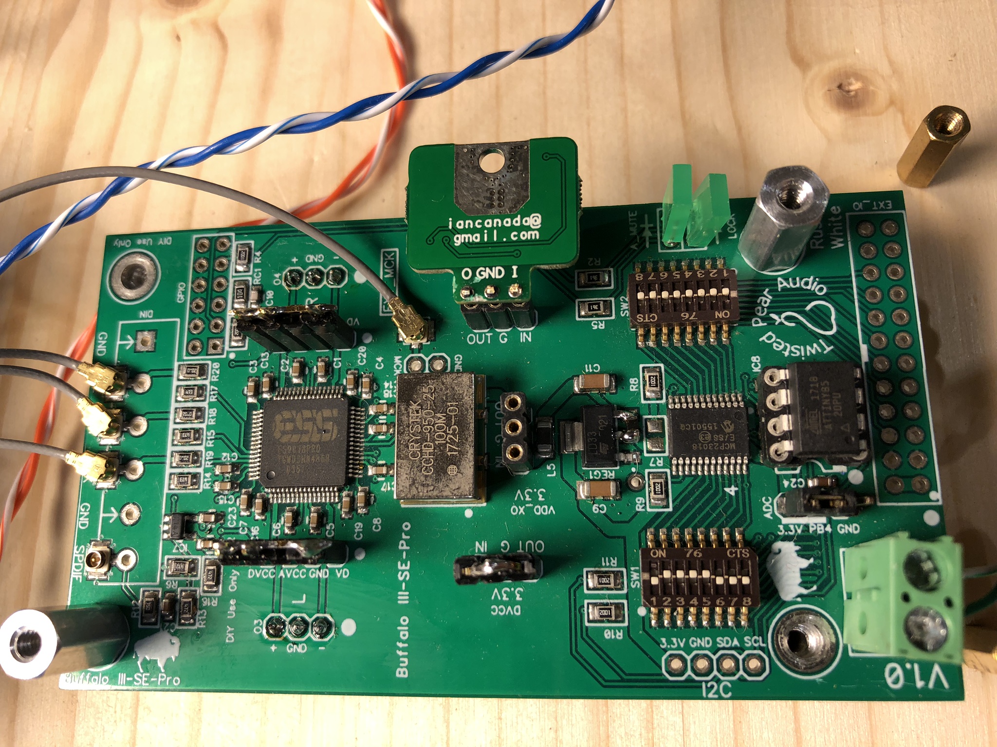

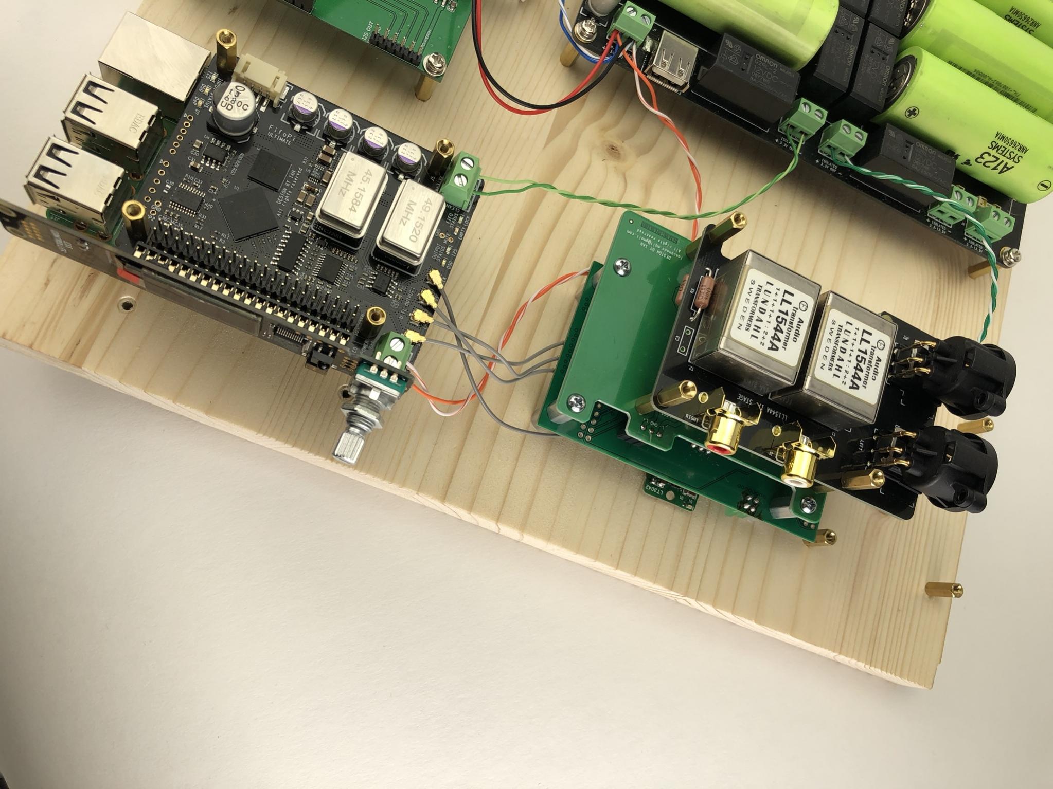

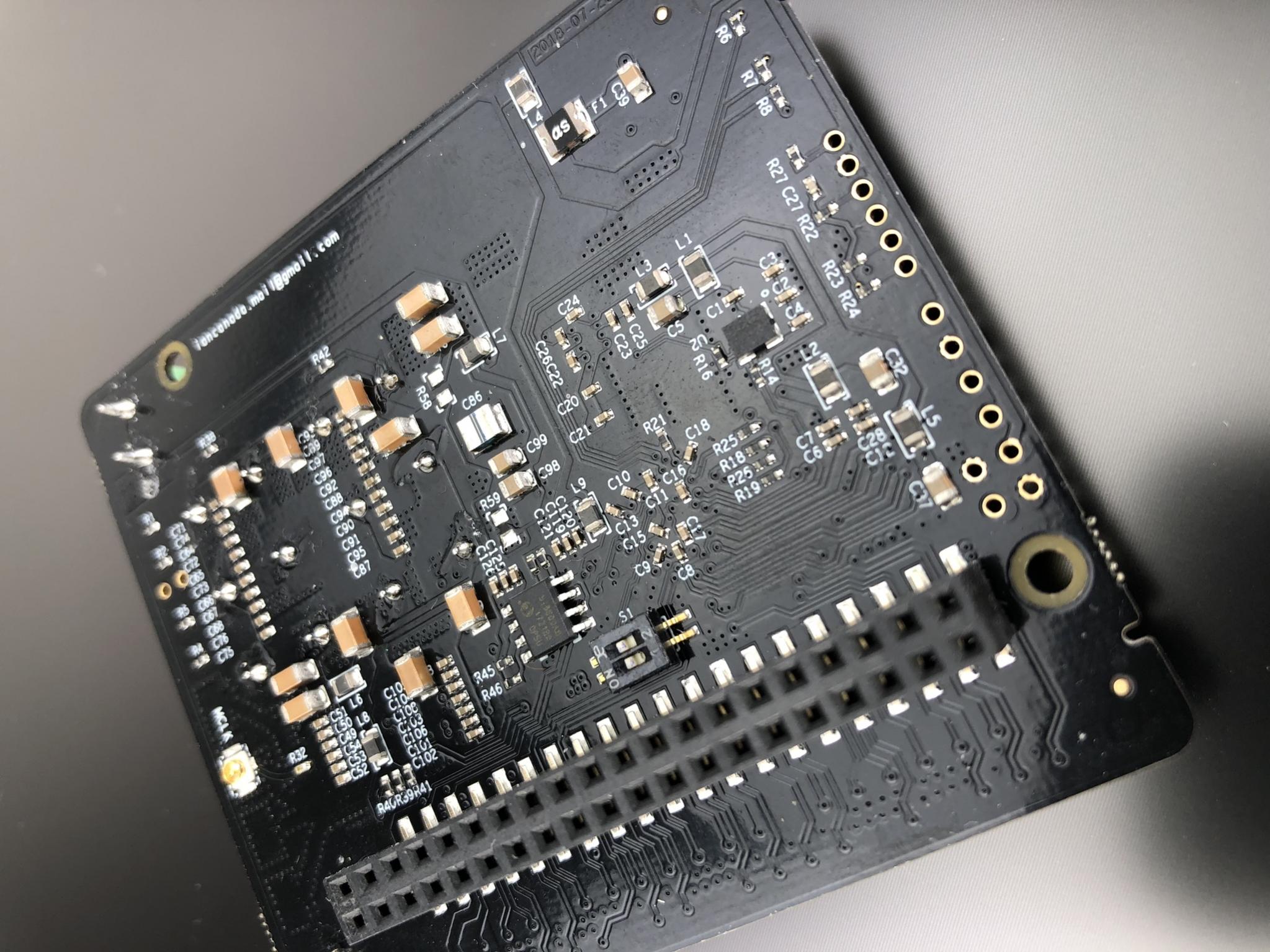

Buffalo III SE pro works with FifoPi, LifePO4 power supply and my transformer I/V
Before I return the Buffalo III SE pro back to Ofswitched, I’d like to share with you what the setup I did to make it working with FifoPi, the LifePO4 pure battery power supply and the transformer I/V.
Buffalo III SE Pro was running at synchronized mode with MCLK and all other digital audio signals fed from FifoPi through u.fl cable. DPLL bandwidth can be set at lowest in this mode. Please see the first picture for the whole system set up.
1. BIII SE pro power supply
To make it works with 3.3V LifePO4 power supply, I did
a. Jump (short) VD to DVCC and AVCCV for both left and right channel
b. Use a 1.2V LT3042 low noise regulator
c. Short IN and OUT of DVCC 3.3V
d. Short the in and out of MCU regulator with FB.
e. Leave VDD_XO empty without connecting anything for sync mode.
Please see the second picture for details
Note: For best sound quality, I’m strongly suggested powering them with independent rails for the real DAC application.
2. BIII SE jumper set up
Please see the second picture for swith1 and siitch2 setup for details, the setting will be
PCM/DSD
I2S
32bit
Apodizing fast roll-off, minimum phase
Automute enable
OSF enable
47.44 KHz
Lowest bandwidth
3. FifoPi switch jumper settings
Both S1.1 and S1.2 was set to “ON” position, which will
a. Enable 16 to 32 convertor
b. Use ES9038Pro internal DoP decoder
Please see the third picture for details

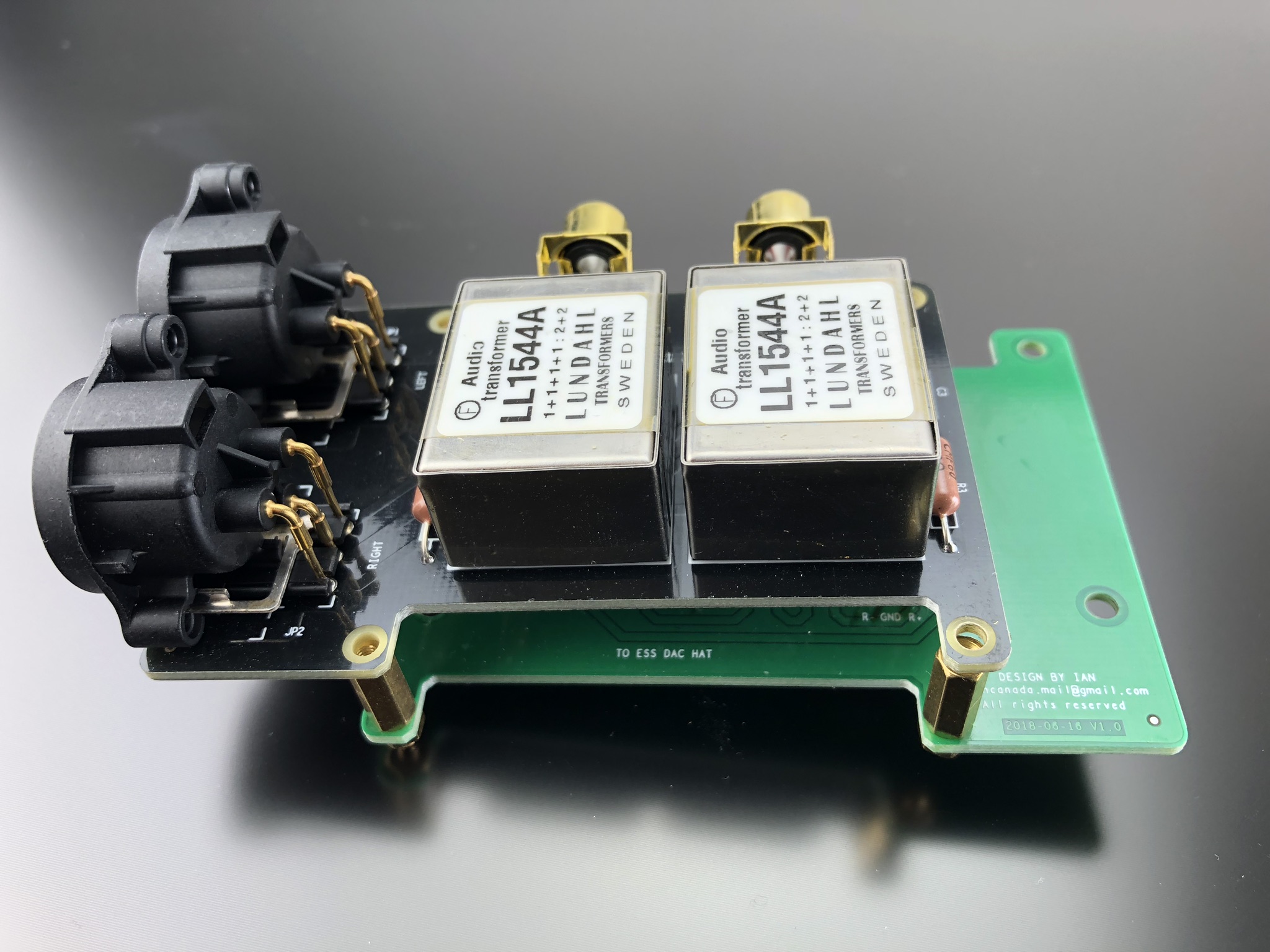

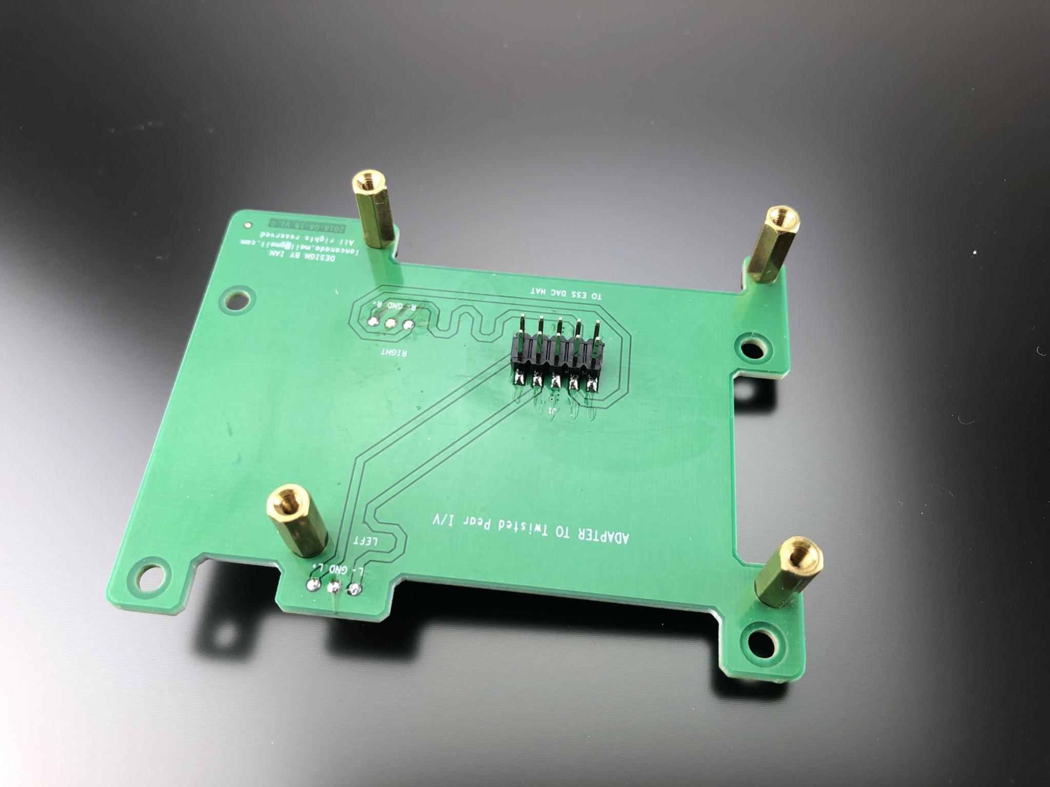

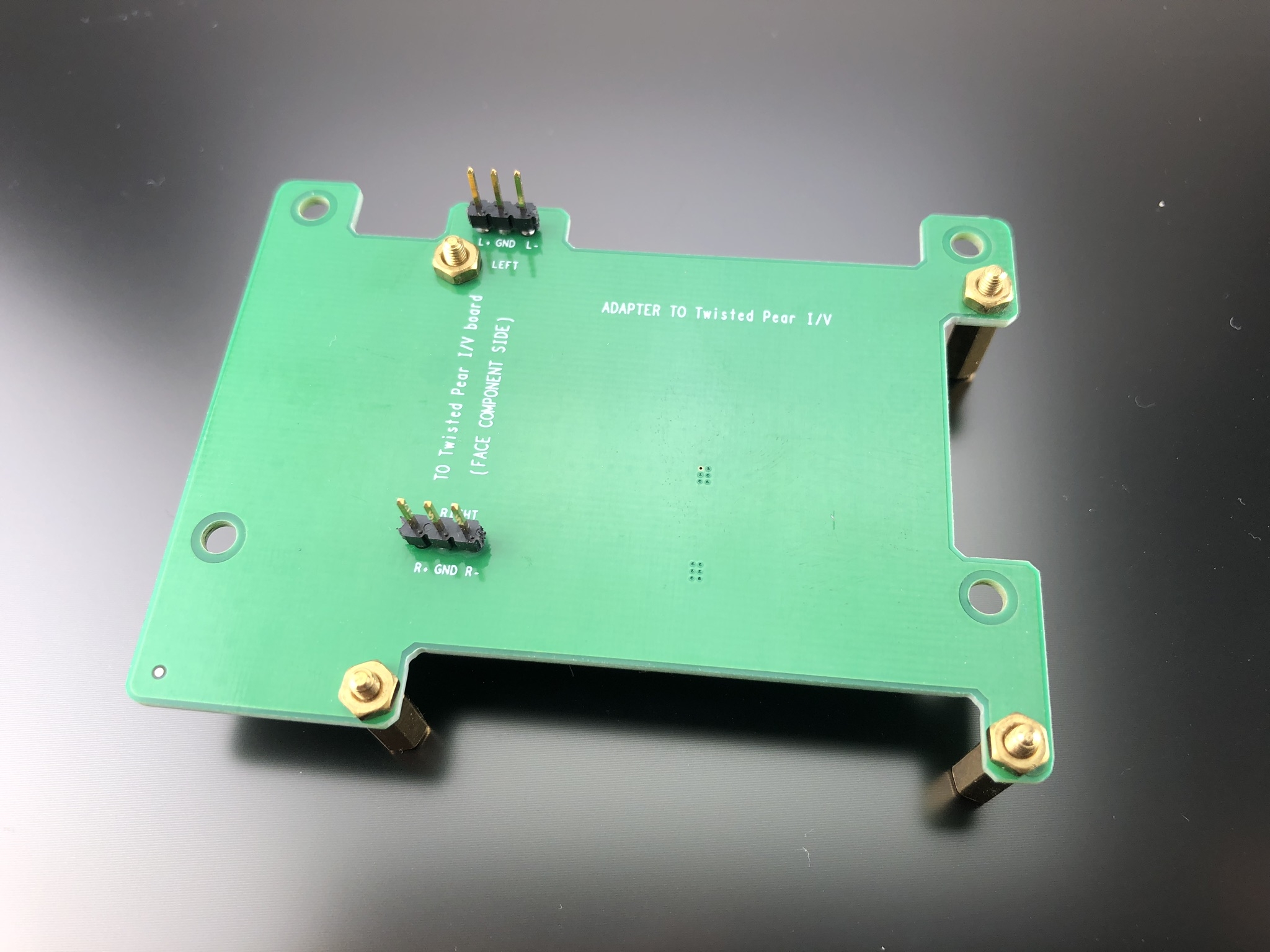

4. Use Buffalo I/V adapter in the reverse way to adapt Ian transformer I/V board to Buffalo DAC.
Please see the rest pictures for details
Note, value of resistors need to be reduced to match higher output current of ES9038Pro.
Ian
