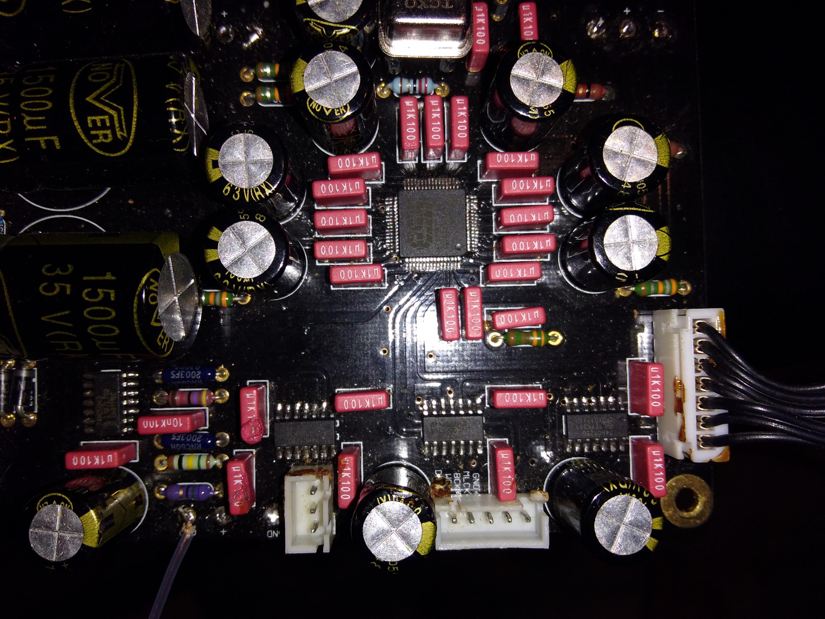

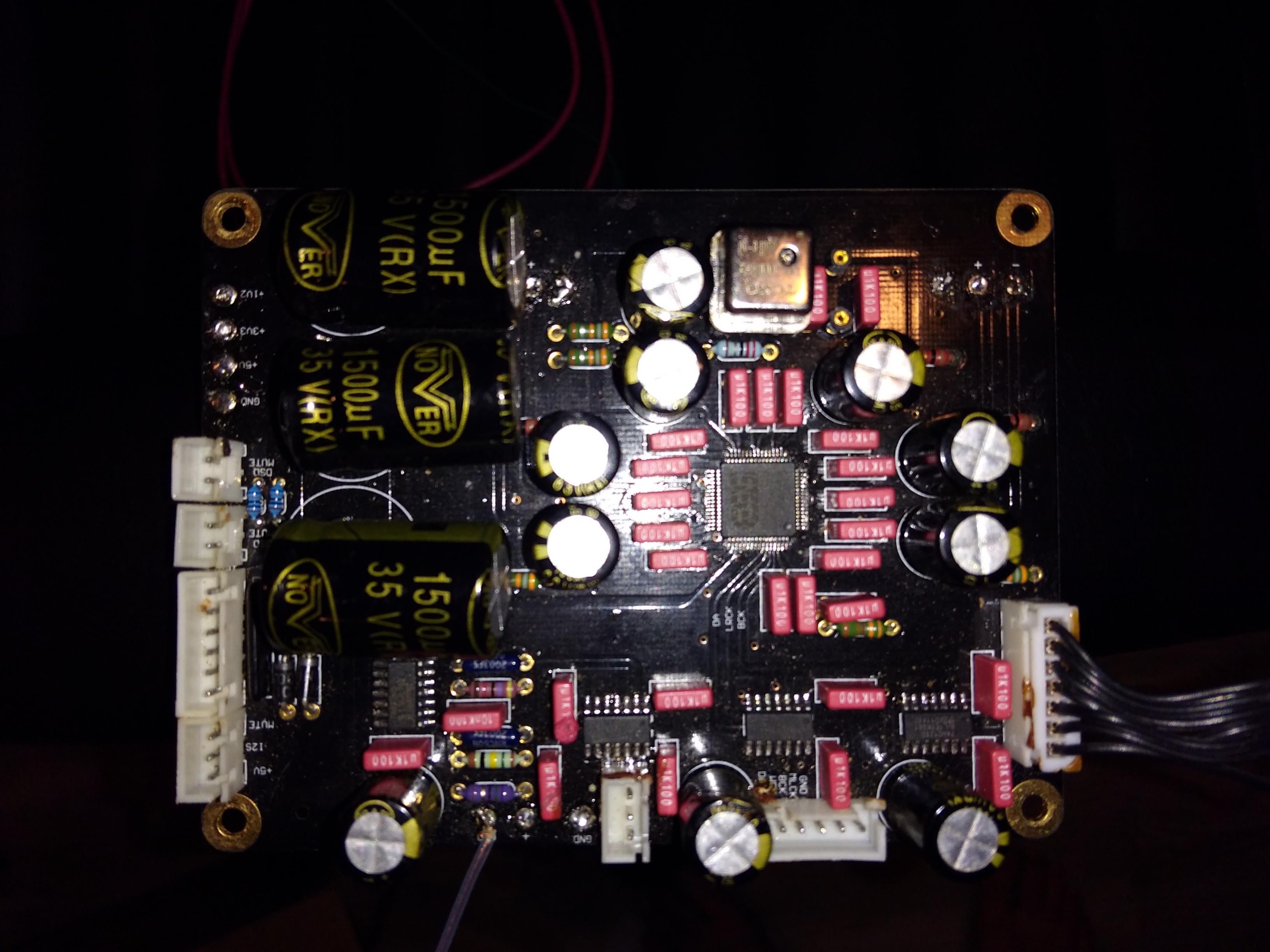

Can you help me figure out where I would need to connect it on my Audio-GD NFB-1 module?
sorry I know those aren't the best pictures, my phone is crappy.
That sucks, they refused to send me schematics last time I asked.
Reverse engineering shouldn't be too terrible difficult. What is it that I am looking for in the design?
Easier said than done but this board needs to be inserted on the I2S serial bus, considering the DAC chip operates in I2S mode anyway. I don't have a real hands on experience with it, so this is just from a theoretical perspective.
