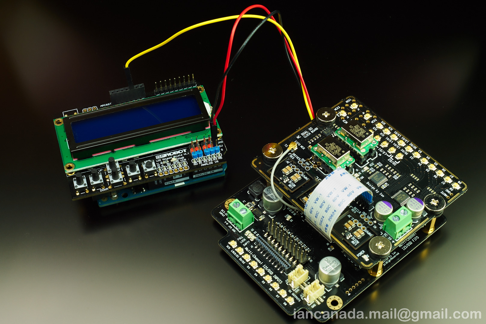

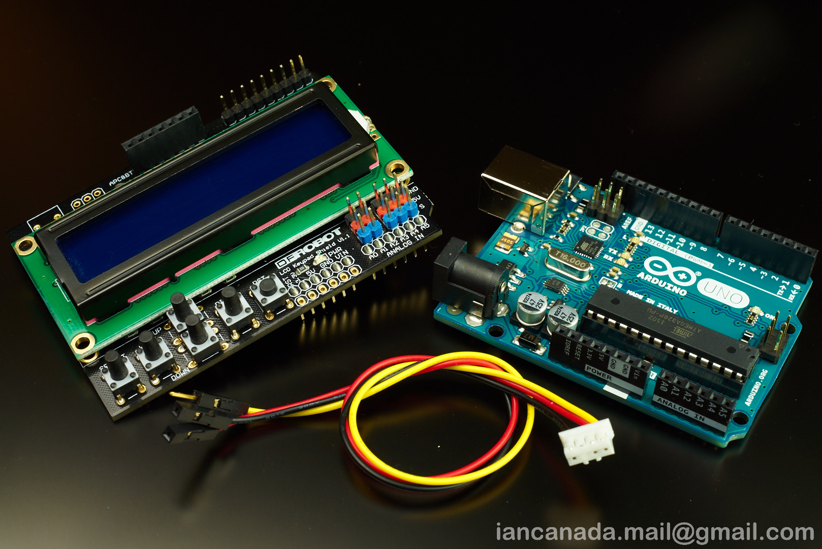

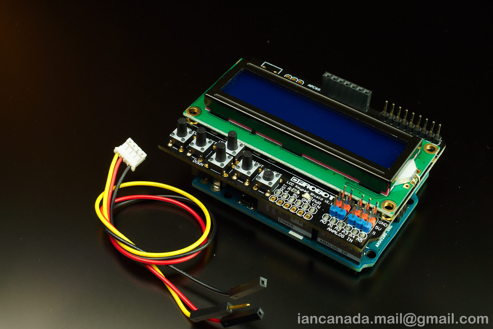

Open source Arduino based McFIFO display
This is a new feature of McFIFO. An external display can be connected to McFIFO with only 3 wires
A lot of things such as I2S/DSD music information, McFIFO status, MCLK frequencies and FIFO delay time can be displayed on it. It’s also really helpful to debug your system.
Here is the github link of the project. You can download the source code for free:
https://github.com/iancanada/McFIFOdisplay
Just need to open the link and click the “Clone or download” button - Download Zip.
With this code, everybody can DIY their own McFIFO display.

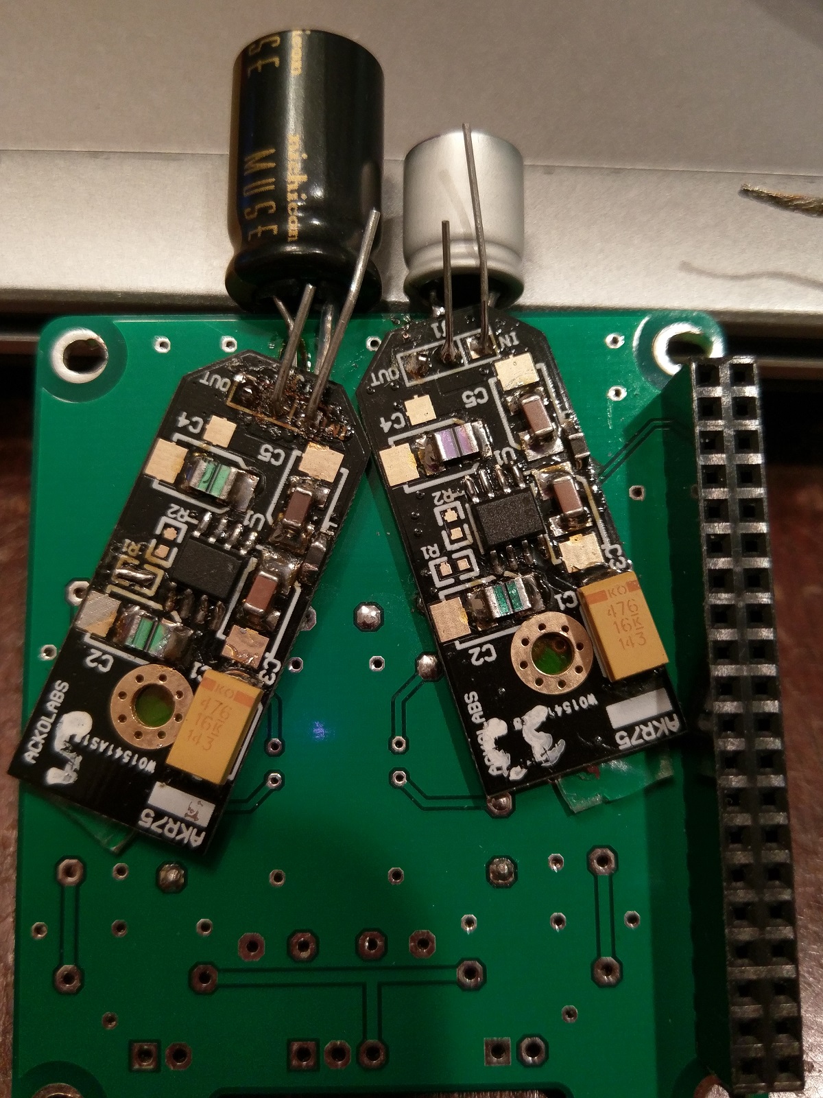

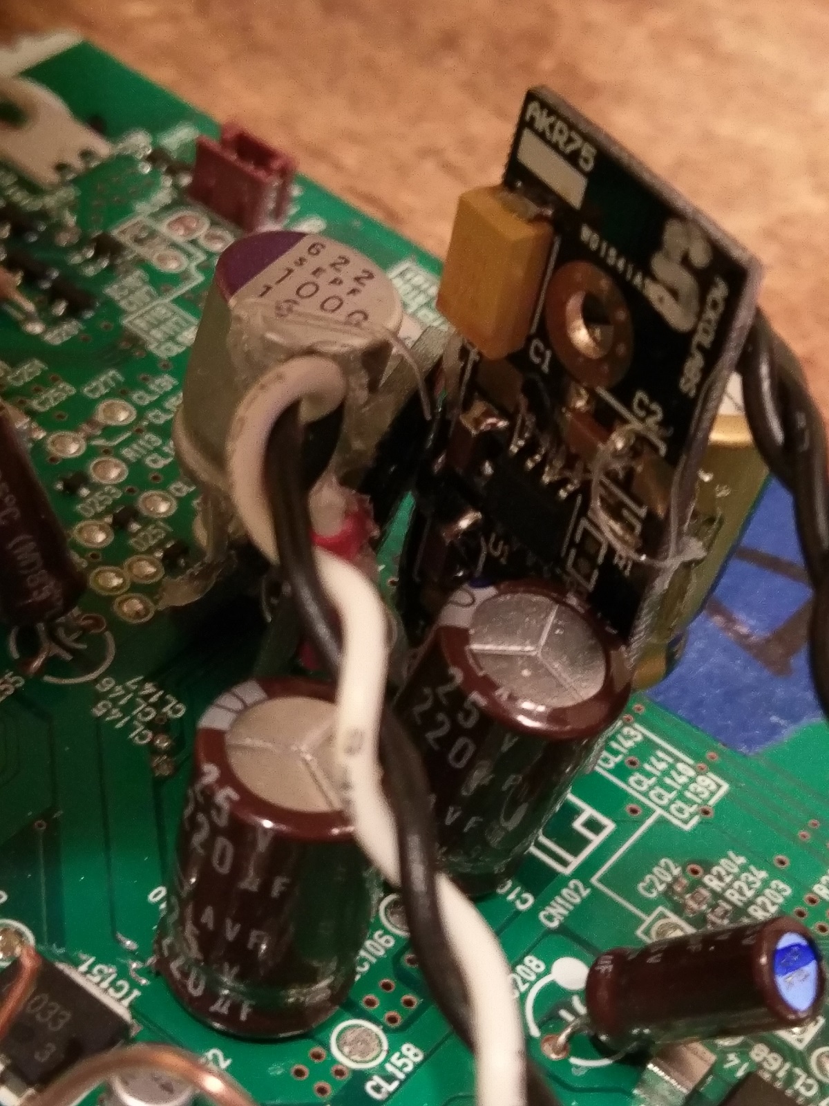

Ian, this is a great free-bee! THANKS!
The ADM715x regulators are also used by Acko in his AKR75 series and Twisted Pear in their recent Trident-SR regulators for their Buffalo DACs.
These regulators (along with the still-great TPS7A4700 & LT3042) have become my go-to devices for digital and mixed uses.
I have found them to be very high-performing and easy to use devices, with an added benefit of the ADM7150 & ADM7151 devices taking input of up to 16v. which allows easy integration in many retrofit situations where the existing rails are too high for LDOs with the typical 5.5v limit (which sadly includes the ADM7154).
The attached pictures show:
- a 3.3v & 5v AKR75 on my HotRod Dial RPi DAC
- a 5v AKR75 providing a local 5v regulator on a mod of mine to a Sony HAP Z1-ES
I bet everyone who gets these will find them as useful and beneficial as I have!
