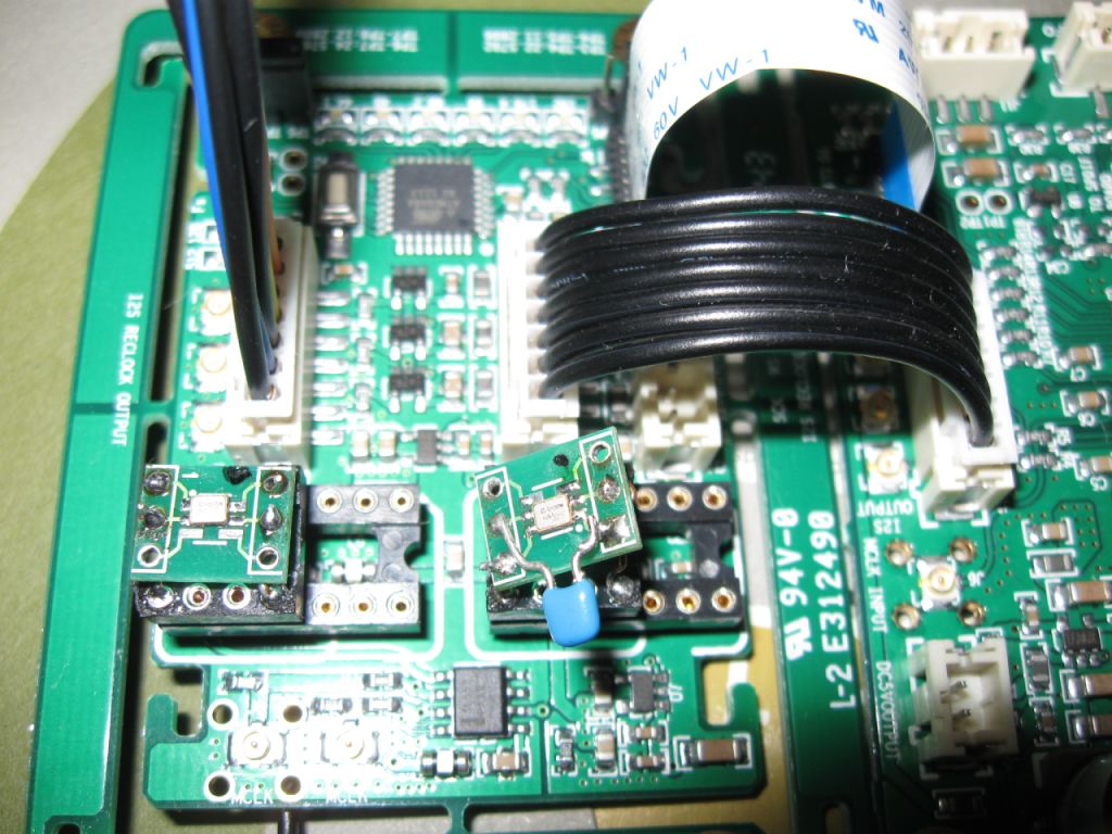

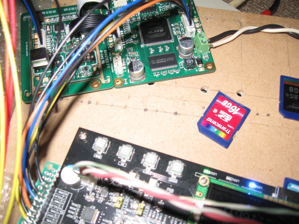

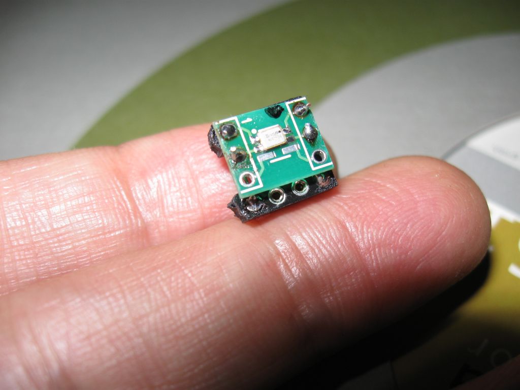

Hi wktk_smile,
Thank you so much for sharing your experience. I'm very interested in your hookups. Could you please let us know a bit more details? or some pictures? With the synchronized mode, what frequency of your NDK XO did you use? Actually the Buffalo III I bought just arrived yesterday. Hopefully I could try it next week. I have to focus on upgrading the FIFO and design the new PCM daughter board now.
XO is NZ2520SD-22.579200M-NSA3449C, and later I also replaced U2 with 24.576mhz one.
they are not fast as ES9018's MCLK, but fine for actual use for playing up to
96khz pcm. While playing 176.4khz and 192khz, bypassing OSF mode was required.
Hi wktk_smile,
Thank you for the pictures. Very impressed.
Actually, the dual clock board has a reserved double speed mode which could run 45.xxxx and 49.xxxx MHz XO for ES9018 or Buffalo DAC to make us more happy, especially for the synchronized mode. I'll publish the setting document after I conformed that on a real Buffalo III dac. Maybe I still need to inquire you when I go the hookup.
Although stock XOs may be "generic" ones, I felt they are not bad.
Even with stock XO, FIFOboard + reclocker gives good results.
Yes, at least that is the original clock from a crystal, don't need to trace another input clock.
Have a nice weekend.

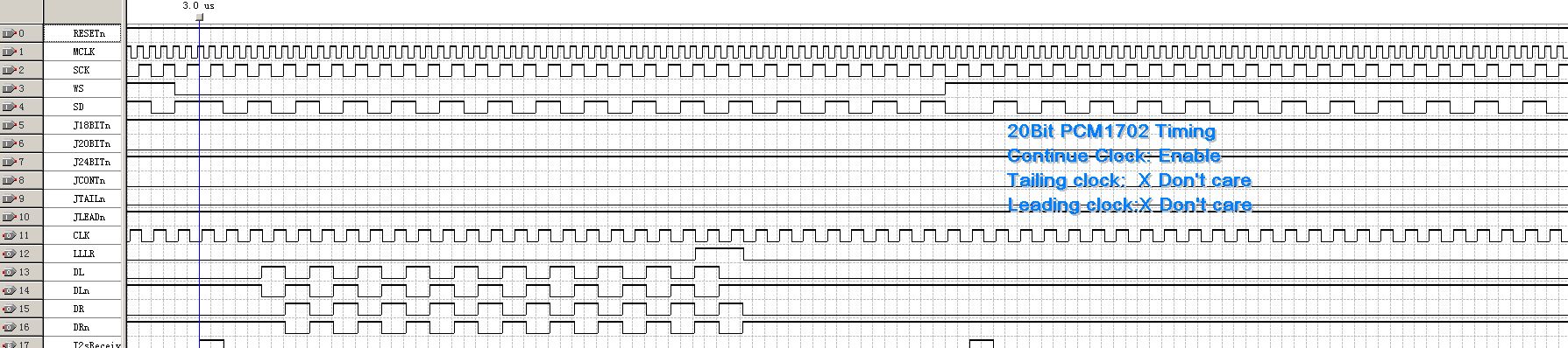

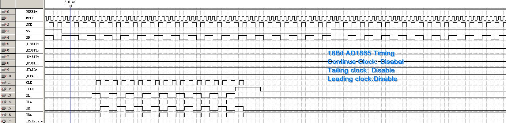

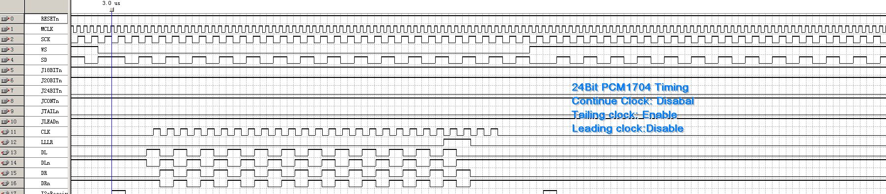

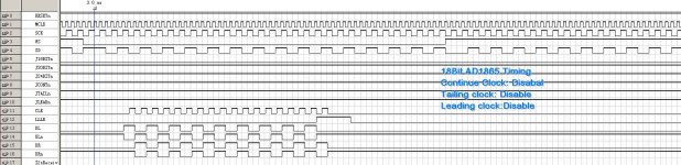

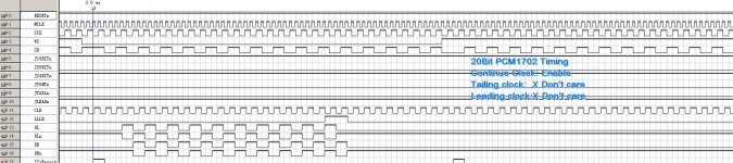

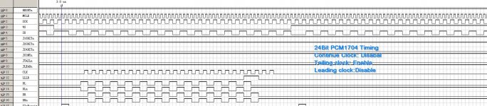

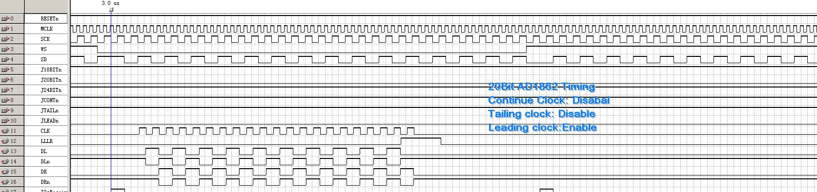

Hi Zsolit, Hi Vzs,
It took me quit a bit time revising the I2S to PCM daughter board design from SCK driven to MCLK driven. New design is 100% synchronized state machines. The performance get big improved. Now I can run 384KHz with 256Fs on the board. But I don't know which USB I2S could support.
1. 100% synchronized FPGA design with max inject MCLK going up to 127Mhz.
2. three word length jumpers, 16,18,20,24 bits output selectable
3. three option functions jumbers:
continue clk
tailing clk
leading clk
all jumbers are negative logic internally. Please note the new names.
4. I attached some simulation waveforms with different jumber setting.
all the simulations were run at 50Mhz MCLK for 128Fs. 100Mhz 256Fs got the almost the same result.
5. The tailing clk is reduced from 4 to 2 making PCM1704 benifit from it.
6. The leading clk new becomes optional.
Please let me know for any comment. FIFO board will be upgraded to support left justified format(which has nothing to do with this board).

Hi Ian,
Impressive progress. I reviewed your description (2 to 6) and the waveforms and everything looks good to me:
- I like that you added 16bit support
- The naming is clear like that (at least for me)
- Simulation waveforms looks good
- Leading clock selectable - too many goodies :)
[...]FIFO board will be upgraded to support left justified format(which has nothing to do with this board)[...]
Seems a logic decision not to put it on the converter daughter board.
How did you think it would work?
- I2S in and selectable I2S out or Left Justified Out
or
- selectable I2S in - I2S out or Left Justified in - Left Justified out
Thanks and enjoy your weekend (what is left),
Zsolt

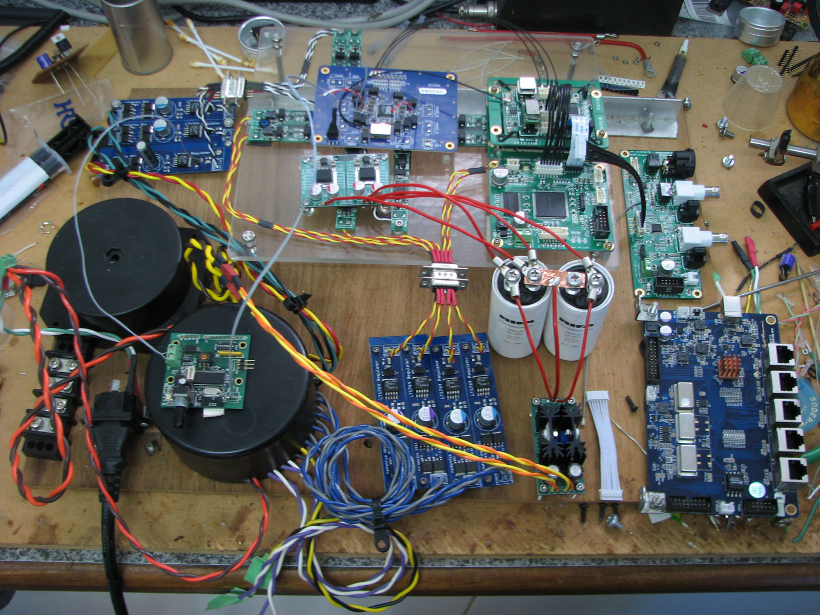

building up 'breadboard' for testing different options, clocks, references, regs IV etc for the dac that will drive my tweeters, the woofers are already covered with the NTD1 with another ackodac. some progress below, should power it all up tonight or tomorrow. I will try running Titan through the fifo as well as direct. it has its own clock fanout buffer and smaller fifo afaik and some rather nice clocks, so should be an interesting comparison, titan is capable of higher bandwidth than the fifo is in its current state, so i'll stick to 192 or below for the tests. the platform is normally mounted above the IV with the NTD1 thus the fairly useless set up here, though it will provide another layer of space for batteries, references etc for the rest of the testing
yes the 4 channel dac will be a 2 box affair with transformers and preregulators, battery charge circuit, along with some control circuitry in one case and the rest, DC onwards, dacs, input circuitry and output stages in the other.
its a pretty crazy build even for these 2 channels, first up i'm driving the wire BAL-BAL headphone amp directly and have altered the input circuit slightly to allow current mode coupling
please excuse the messy bench and rough and ready layout, i'll be switching things in and out so its only temporary and no thats not earwax on the cotton buds, its cardas rosin flux ;) everything is currently floating in this build too, so thats another thing i'll be optimizing with this, the analogue stages including those in the dac should have a common ground reference, but the rest can float really as its either batteries, or a dedicated secondary winding for every consumer, so we'll see. the regs on the ackodac are all choke input so they float too
dacs arent what they used to be hey? ha
