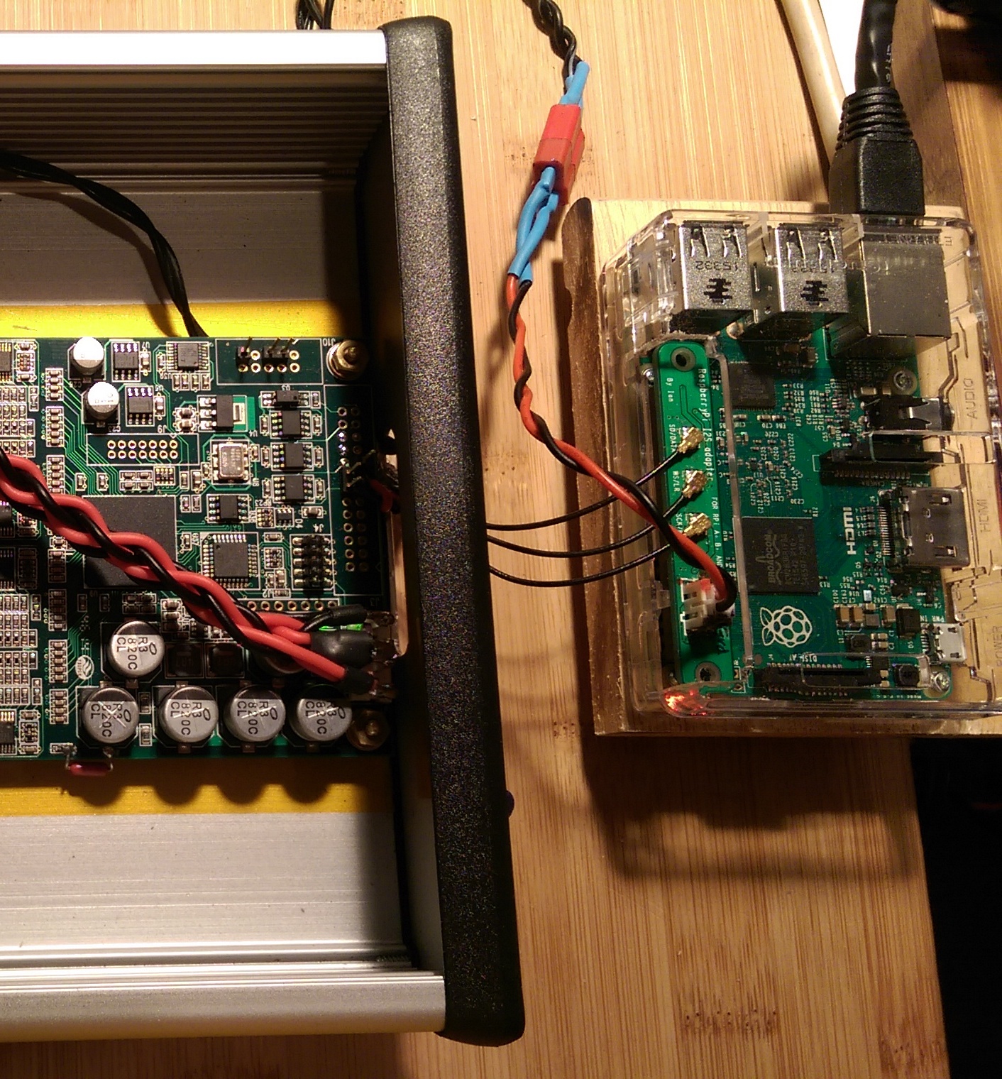

The attached picture shows my R-Pi -> Soekris DAM DAC setup using Ian's adapter for the I2S outputs.
The DAM is stock, but I feed it with a good +- 13v supply using 47,000uf Jensen 4-pole caps as the output filter caps. The setup sounds quite good and the SQ rivals another setup I have with a SDTrans384 SD Card reader feeding a DAM. The two setups are my best at this time!

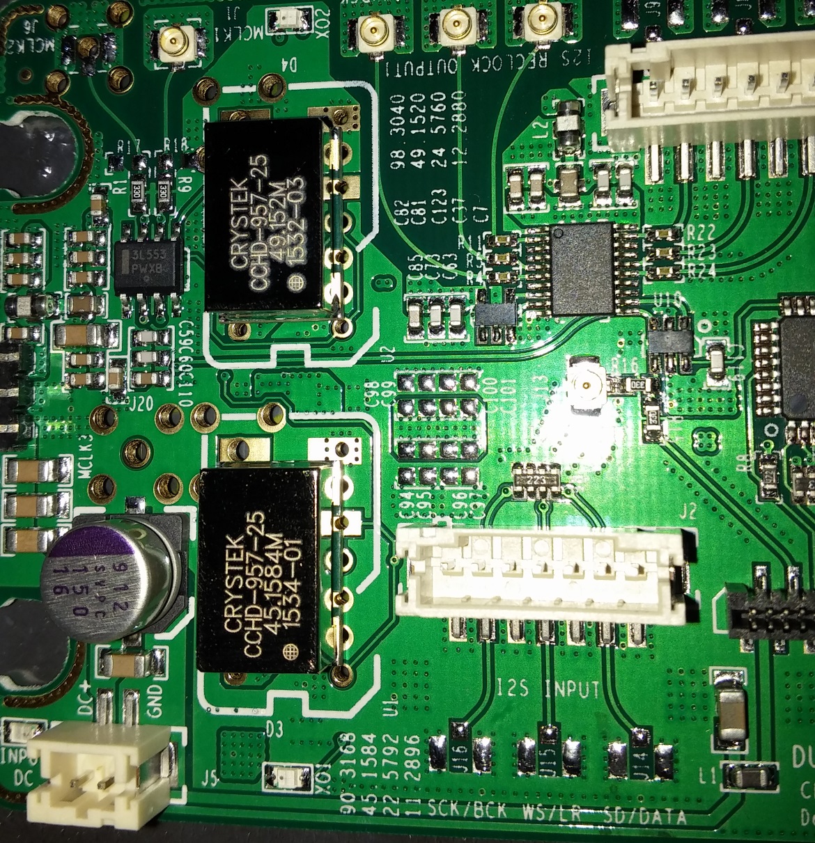

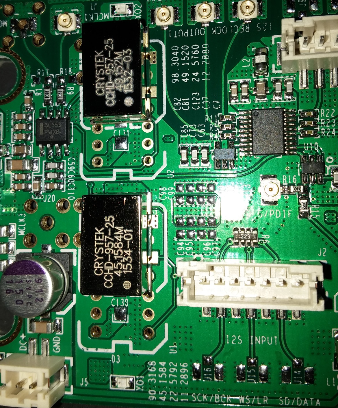

I want to solder the Crystek Crystals directly on the Clock II Board, but I'm not sure about the Pin Position.. before i heat up the soldering iron ... Could someone take a look on the attached Picture please to confirm the position 🙂
Many thanks in advance
Best Reagards
Marcus

Yes,this is the right position.
Are you sure, because I now study the UniversalXO Board Document / Pictures and it seems Pin 1 of Crystal goes thru adaptor to bottom right pin on the clock board which is not connect to that pin I have placed as Pin 1... after looking in detail into the UniversalXO Board Pictures I would place the crystal as show attached ..

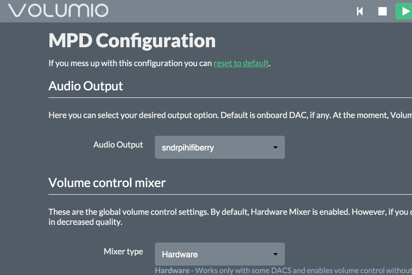

One other problem. I'm doing now a test run.. but Volumio can't see the sound card. Was there a setting? I'm digging trough the whole bunch of 400+ pages at the moment .. I'm trying the hifiberry DAC, but when selecting the output, it shows nothing in volumio.
The buffer also stays empty

thank you for your fast answer and support.
I guess my setup are littel different from yours. (if i point it out correct from the picture).
I plan to solder the Crystek 'direct' on the clock board without adapter PCB.

Marcus,
the adaptator PCB of the 957 is wired to each corner of the dip16 on the pcb ! WIth a buzzer you can check the continuity between two vias on the clock II pcb, crystal aera... 😉
Marcus,
That's a good hint, thank you !

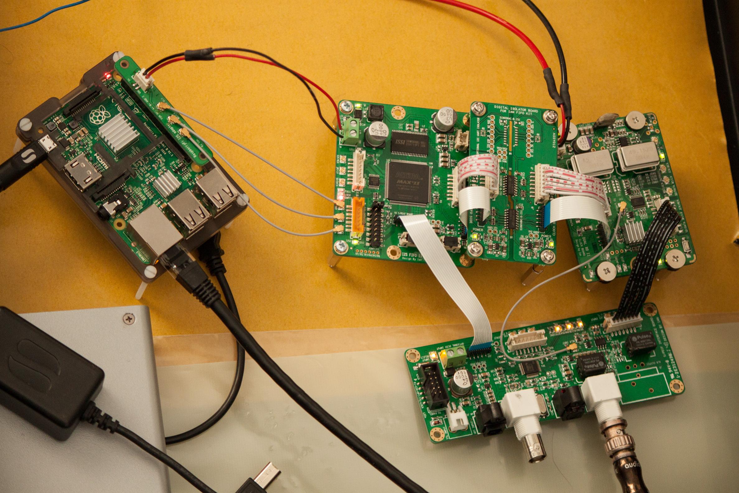

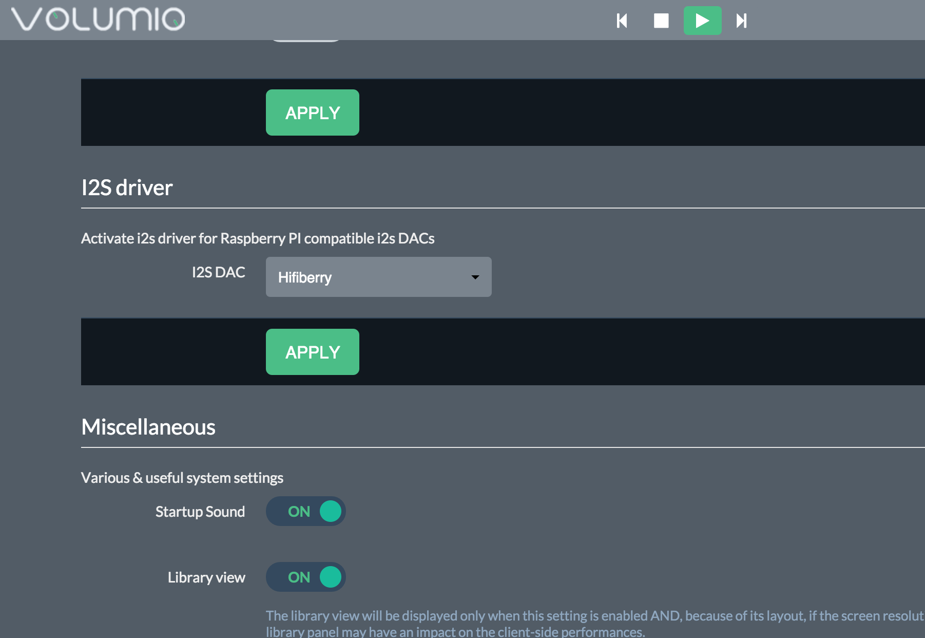

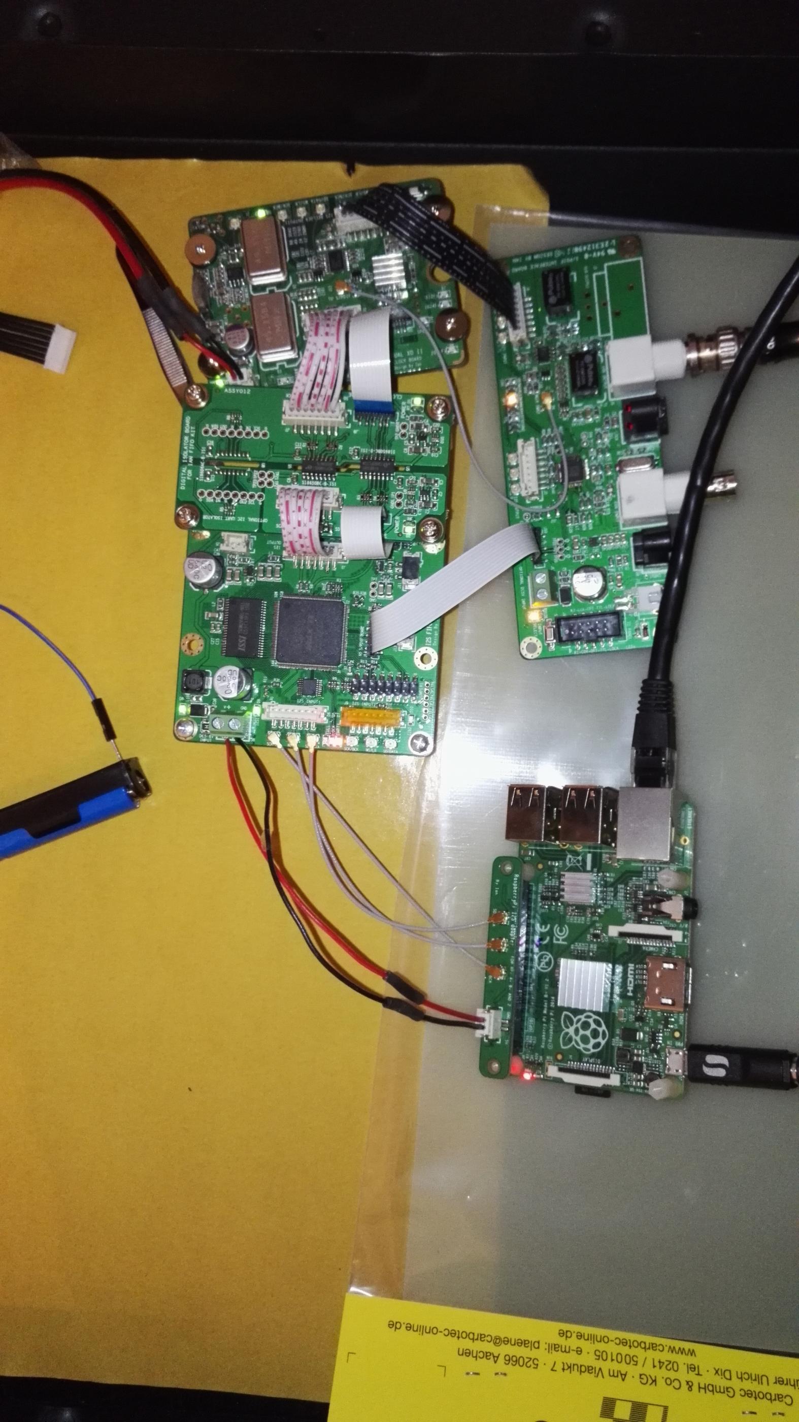

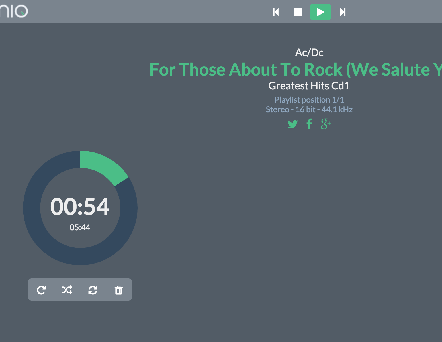

I think I could really use some help. The FiFo doesn't seem to take any i2s signals.
- updated the RPI
- used i2s settings on both volumio 1.50 and 1.55
- used i2s Hifiberry DAC settings
- used i2s Hifiberry DAC+ settings
- used i2s Hifiberry Digi settings
- used i2s Hifiberry DAC settings on Moode
- used i2s Ian fifo settings on Moode
- I've measured my pi-hat, and all is soldered well.
- changed fifo input from 1 to 2
- Used CMedia CM6631A USB -> i2s receiver and attached following pins
CM~ GND -> Fifo GND (1)
CM~ BCK -> Fifo SCK/BCK (2)
CM~ LRCK -> Fifo WS/LR (4)
CM~ DATA -> Fifo SD/DATA (6)
- Have seen Volumio & Moode playing and not playing, but no LOCK led on fifo
I'm kinda out of options as far as I know what to do.
I've attached big image of the setup, and some screens of volumio.

I think your problem is in how you're trying to use the S/PDIF board. Since that board is not supplying input to the FIFO, you should probably remove the ribbon cable between the FIFO and the S/PDIF board and supply power to the S/PDIF bard externally. Not sure if that will solve your problem, but it's worth a try.
You might also try removing the S/PDIF board entirely and send the I2S output from the clock board to a DAC that supports I2S.
Input comes from berry. Output is over spdif board. This is OK. I think you should take other I2S input or switch manually to other input. Do you see yellow tape?I think your problem is in how you're trying to use the S/PDIF board. Since that board is not supplying input to the FIFO, you should probably remove the ribbon cable between the FIFO and the S/PDIF board and supply power to the S/PDIF bard externally. Not sure if that will solve your problem, but it's worth a try.
