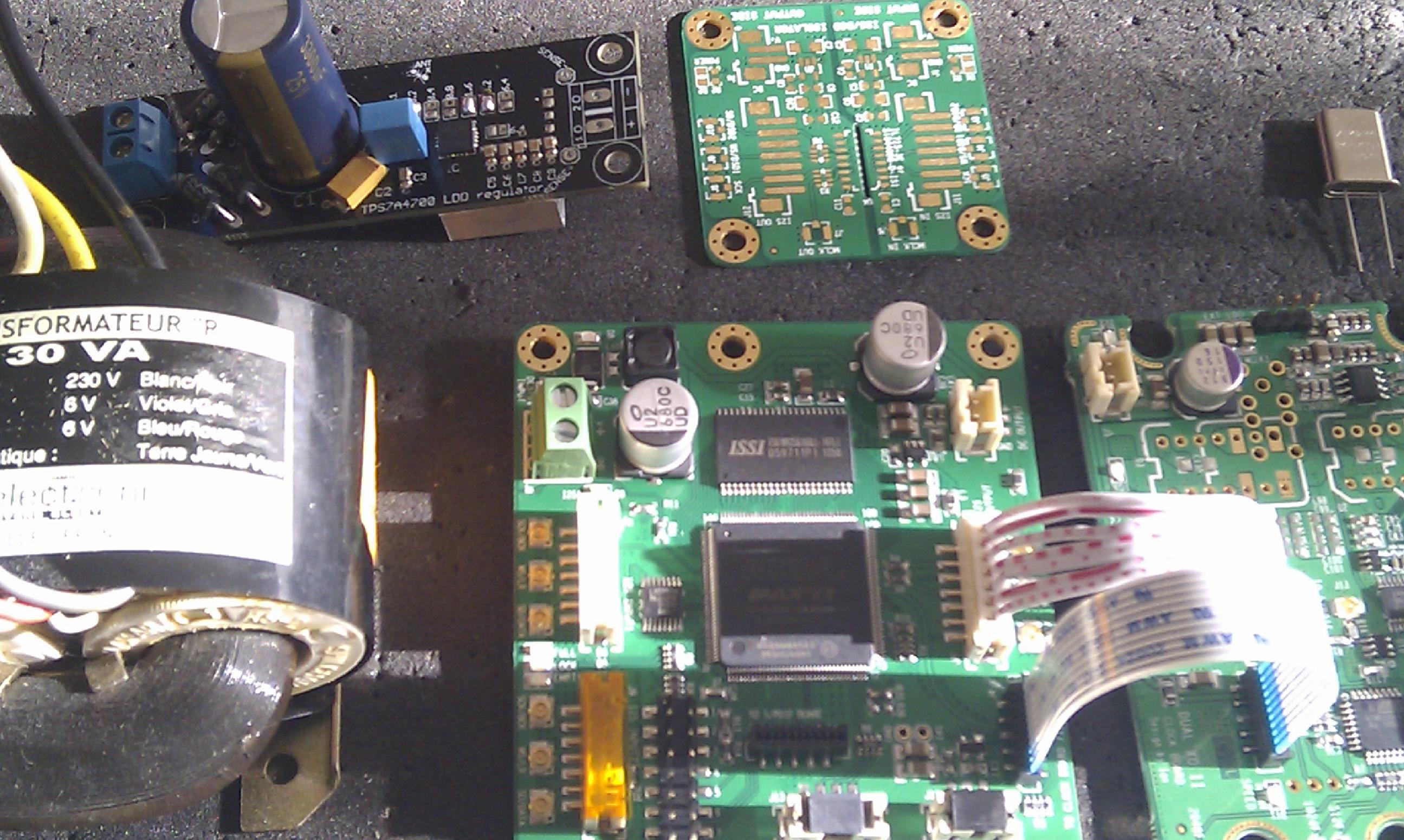

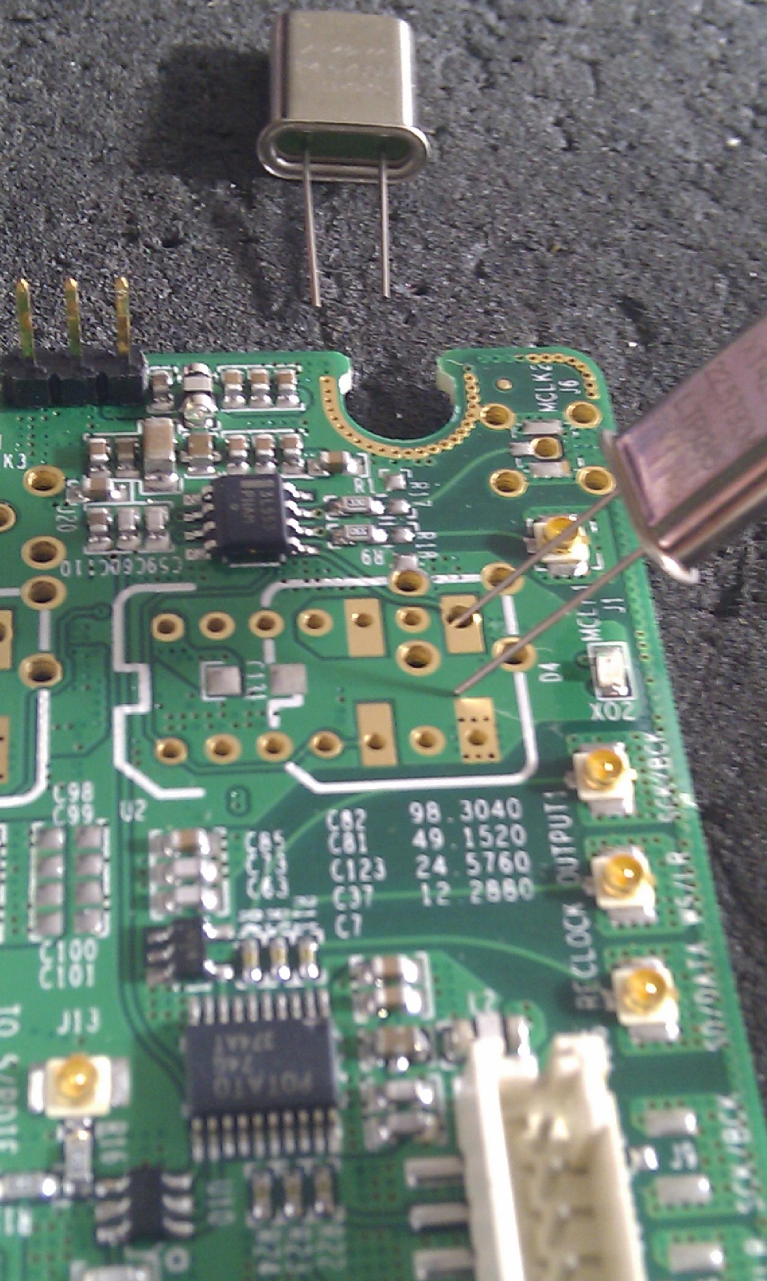

Hello Ian,
I need some help please :
I'm using the FIFO 2 and Clock 2 boards without isolation between them.
Is it the FFC/FPC flat cable which is providing the power supply to the Clock 2 board ?
Can I use a two leads XO ? You said you tried the Laptechs from Andrea, but can you show me please which are the holes used : too much holes
for a non dip XO ! The gap between the leads is shorter than the width of the gap in the pcb (I have the pcb without the dip8 connectors).
Can I use later between the two boards the non populated isolator (the simpliest one you provided with the first I2S to PCM bords) ? Or do I go with the populated isolator sold in the list ?

Ah thanks TNT ! You mean the Andrea's board ? (I have the boards, it's planned but not now !)
Ah I believed, you could try all the XO with the clock II board version ! I mistaked... if I knew I had bought a Crystek crystal to Ian !
Well lets se what Ian says. Manual says:
Two sockets for XOs: U1 and U2
Both sockets must be installed with proper XO. Standard DIP 3.3V clock oscillators with 14- or 8- pin configurations are available for U1 and U2. SMT oscillators are also available for Dual XO II with sockets non-populated (model B). For external XOs, two reserved SMA RF connectors can be used.
External need still to be 3,3V I suppose.
Andreas crystals (NB: Not oscillators - an oscillator contains a crystal!) are not electrical compatible. It's Andreas board that makes it an oscillator/clock.
I read it but not understood it, I just stayed on the fact I readed Ian tried the Laptech on the Clock 2 (and imagined it was just pluged !)
Ok thank you, have to build the ANdrea's clock sooner than planned !
Did you try yours already ?
