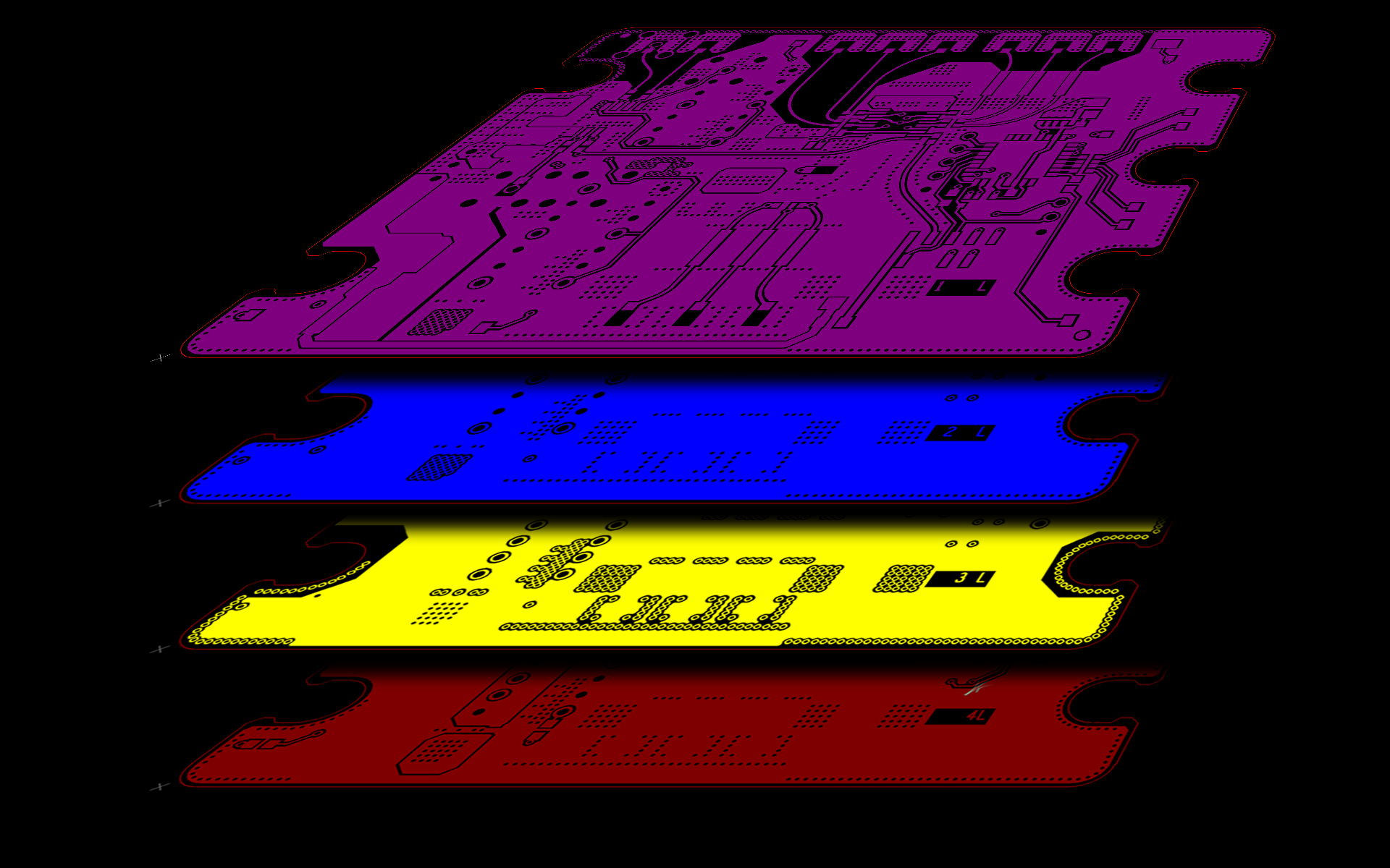

Hi Vin,
Dual XO II will have three independent MCLK output connectors. One of them has already been reserved as un-populated SMA/U.FL socket. I may consider making another one compatible with SMA too if you think it could be better.
Dual XO II PCB layout ( 4 layers ) will be posted very soon. Please let me know for more suggestions.
Ian
It's double side mounted four layers PCB. The new design optimized to low noise high frequency clock signals up to 100MHz. All clock traces are impedance controlled.
Dimensions, hole positions, connectors are compatible will previous Dual XO. Direct upgrading is no any problem.
Thank you so much for all of those suggestions. You can see some of them already been accepted. I'm still open for new suggestions at current stage.
Just hope you like my new design.
Ian

Ian, UFL are very good connectors but loose performance after a limited number of mate/demate cycles also using the dedicated tool. We change often our setup for test purposes so a couple of SMA on the clock lines are better to us.
We were going to tell you this when you published the images of the new board and it seems that you already found room for 2 SMA on independent clock outputs, is our interpretation correct?
We had a look at the preview of your board and it appers to be as usual a great job with professional solutions and care for any detail. Congratulations Ian, we look forward to have it in our hands.
