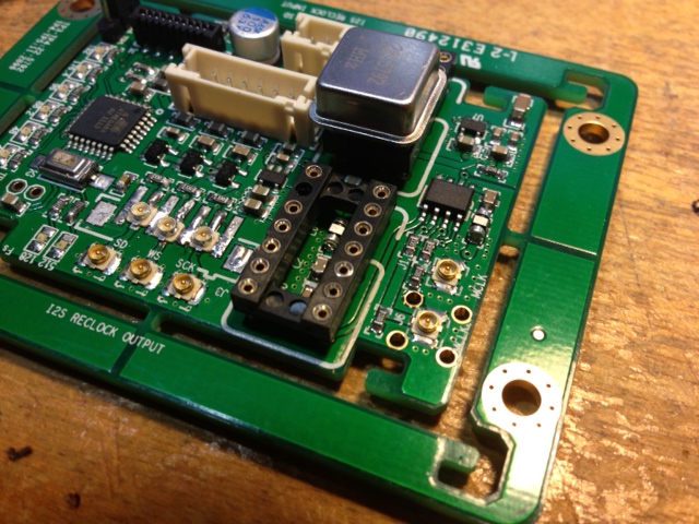

Dual clock board - own power supply
Hi Ian,
I am looking to set up the dual clock board to see if I have the same issue as the post above but also to compare/contrast the sound. Initially I have the 2 default clocks but I want to start planning a proper comparison and this means looking at the power supply.
so far I have...
1) Replaced the header with 3 x u.fl sockets (see pic below). I will be using the isolator board before the clock board (although perhaps this isn't the recommended route as it doesn't appear to be mentioned in the manual)?
2) Looked into changing the jumper settings for 45/49MHz XO's. I'm a little confused by the jumper settings. In the manual it says, for example, that for U1 the jumper should be tp3-4 for 22.xxMHz but then in the double-speed manual it says that for U1 the jumper should be between tp4-5 for 22 but between 3-4 for 45MHz. This seems to contradict each other but perhaps I may need to select frequencies with the button too. I'm sure it'll become obvious when I power it up
I can't find an answer to how to power the clock board directly as I'm guessing that it will be needed if I use the isolator board. Oliver from dvbproject asked a similar question and you said that you could pm him the details - I think I need to remove L11 but I didn't want to apply 5v before checking! ;-)
Crom

OK, sorry for the noise guys...I've done some more digging:
This is backed up by Ian, here: http://www.diyaudio.com/forums/digi...mate-weapon-fight-jitter-127.html#post3208739
The posts around 1246 are not making me confident on hooking it up and I can't find a definitive answer to the clock jumpers. Which is the latest version of the manuals...I have version 1 of each?
@Hochopeper - wld you mind adding the answer to the wiki (or updating links to new manuals if there are any)? I'm happy to help with wiki if ok with you.
The apparent answer is to leave it in place when using the isolator: http://www.diyaudio.com/forums/digi...mate-weapon-fight-jitter-233.html#post3354963if I use the isolator board I think I need to remove L11

I have a question about the Sis570 clock. I want to build a sound server that resample everything to 32/358,8-384 with sox. I want to connect this server directly with i2s, but as i want to keep the server in a different box, i have to use a lvds transmitter/receiver.
I think i found somthing thas is suitable with the wandboard and community squeeze operating system as it offers the options i want. I ask some precision with the compatibility of the wandboard with i2s and lvds, i they answer this (CSP is the optional card they develop) :
There is an interesting possibility with the CSP hardware, it has an I2S
output and clock input that will work directly with the driver for the
CSP hardware, no software change required. You could build a DAC that
has an ultra low jitter local clock, feed the clock to CSP, take the I2S
out to the DAC and reclock with the local clock in the DAC. You can use
LVDS or standard CMOS for the interface depending on how far the DAC is
from the CSP. If you put both in the same box so the boards are a couple
inches apart you probably don't need LVDS. If they are in separate boxes
a foot or so apart then LVDS is a good choice.
John S.
