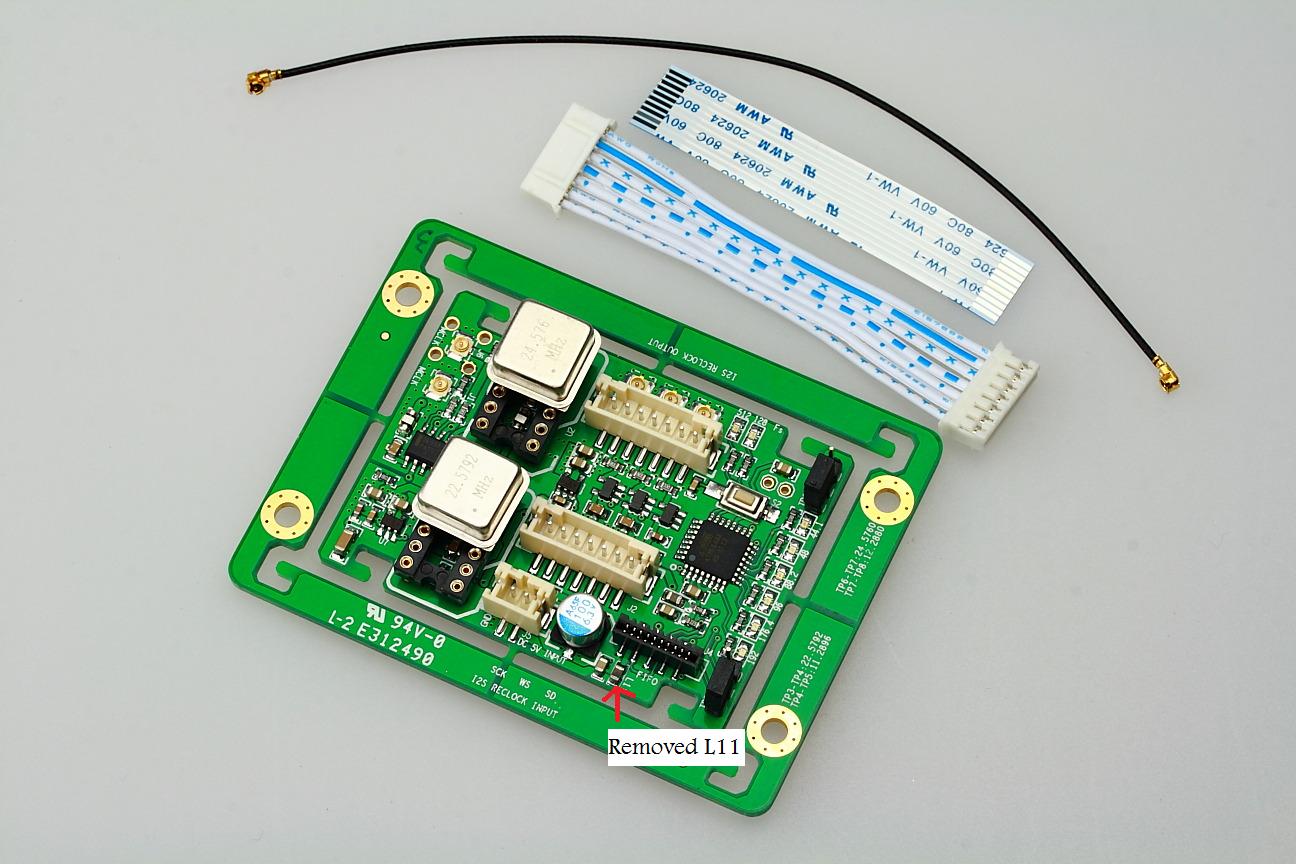

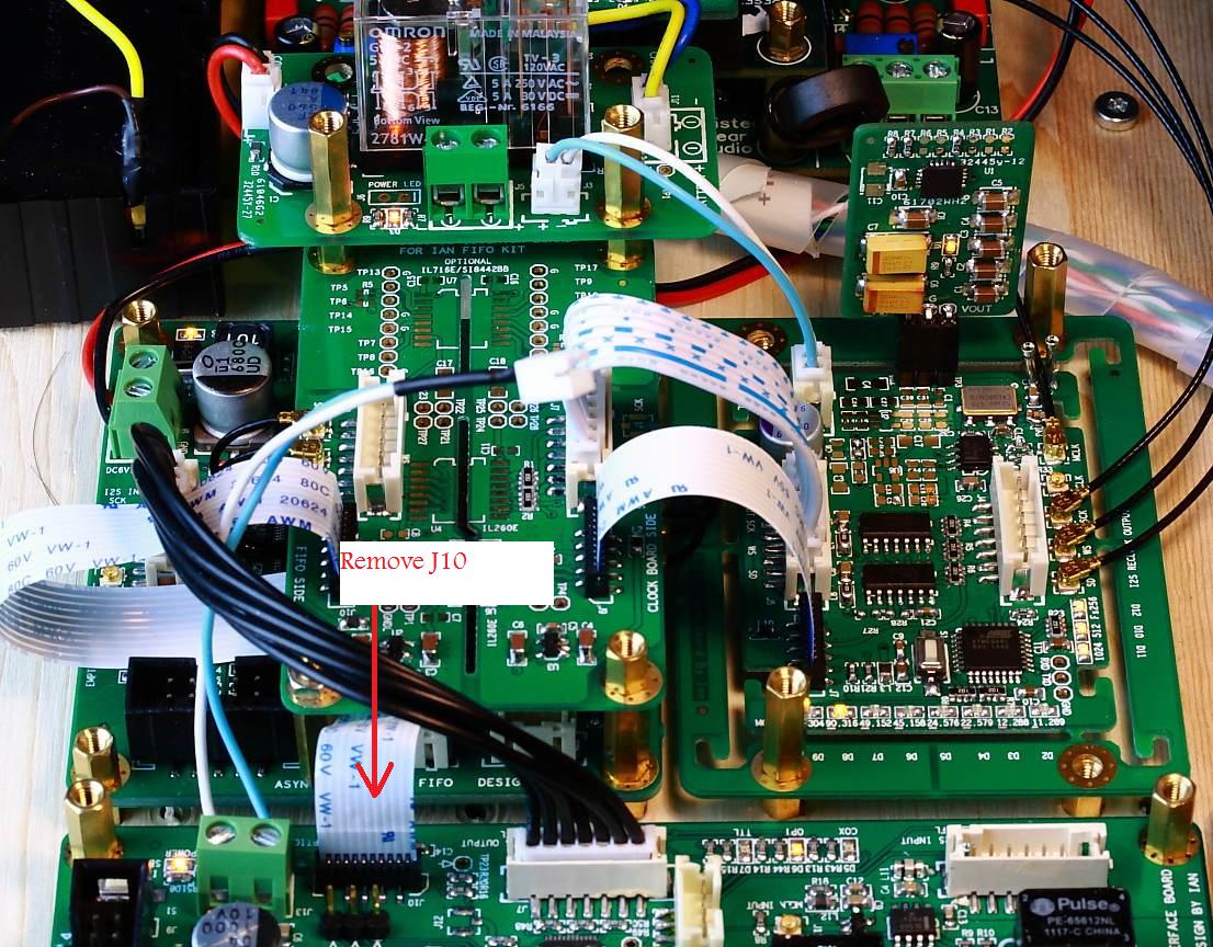

I want to use external power for each FiFO block kit, so with DualXO Clock I will remove L11 and with SPDIF I will remove j10 cable . It is right ? .
Thanks you .
